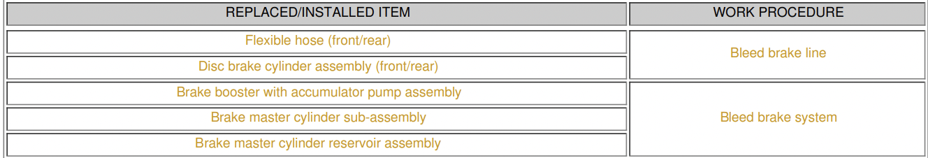

2. BLEED BRAKE SYSTEM
CAUTION: If air is bled without using the Techstream, damage or accidents may result. Therefore, always use the Techstream when bleeding air​
Not saying I do this, since I've bled rear brakes a bunch of ways, drip, pressure with Motive, pump pedal. But it is what the FSM says.

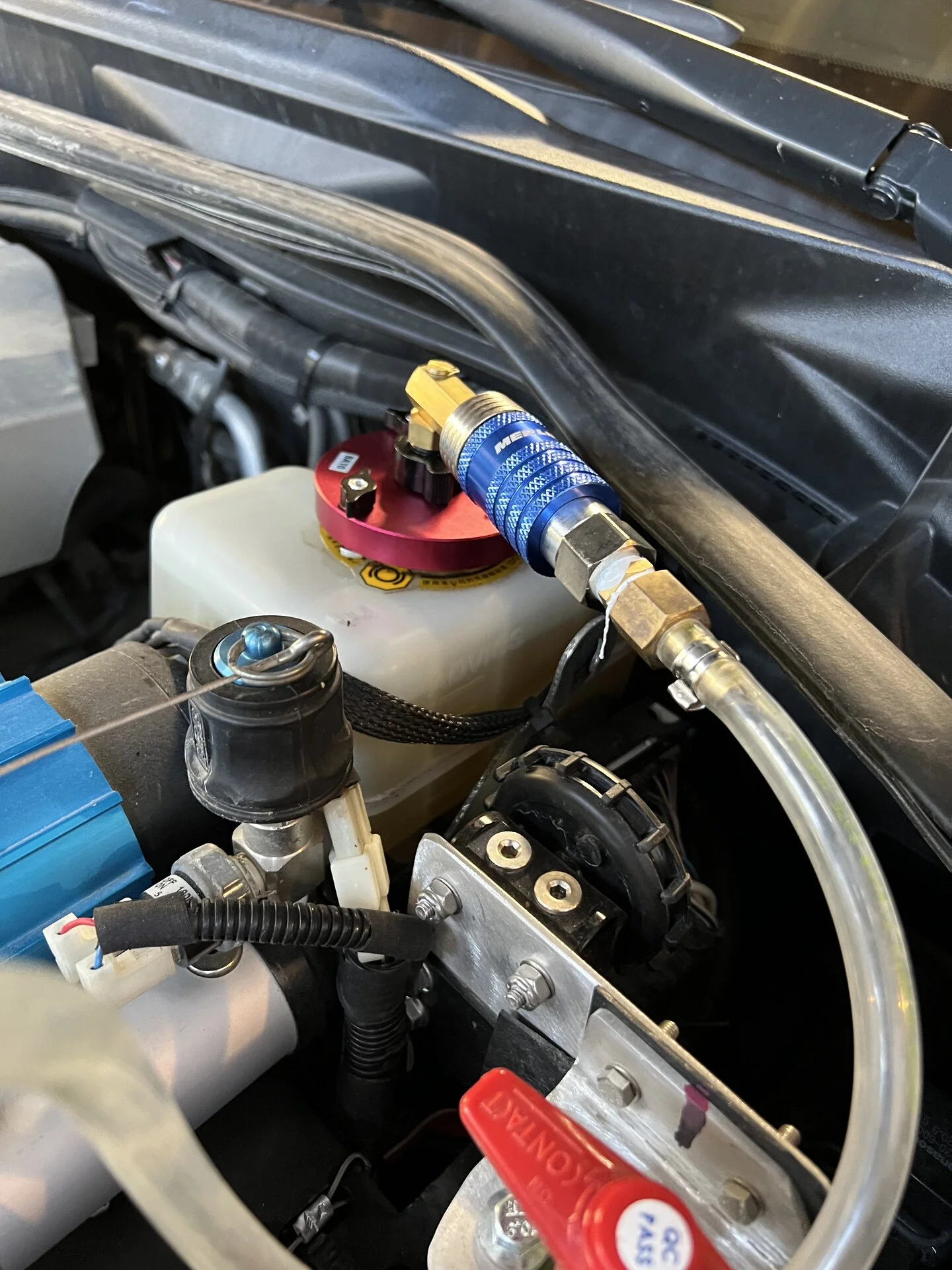

I have done the techstream method and used my wife to pump the fronts. I wanted a simpler process where it is truly DIY and not DIY with a buddy. I've never had great success with speedbleeders so wanted to try something else.
Tried the Holt Pneumatic system from HF that hooks to an air compressor. Simply awesome. No brake pressing, no techstream, and no need to keep an eye on the reservoir as it comes with an auxilliary reservoir that locks on top of the 200s reservoir to keep it topped off.
I bled with the wheels on using FR/FL/RR/LR and it took about 30 minutes and no mess.
I know there are some systems that put pressure from the reservoir down, but understand this puts more strain on the system.
The old way was fine, but this was definitely worth the price!
