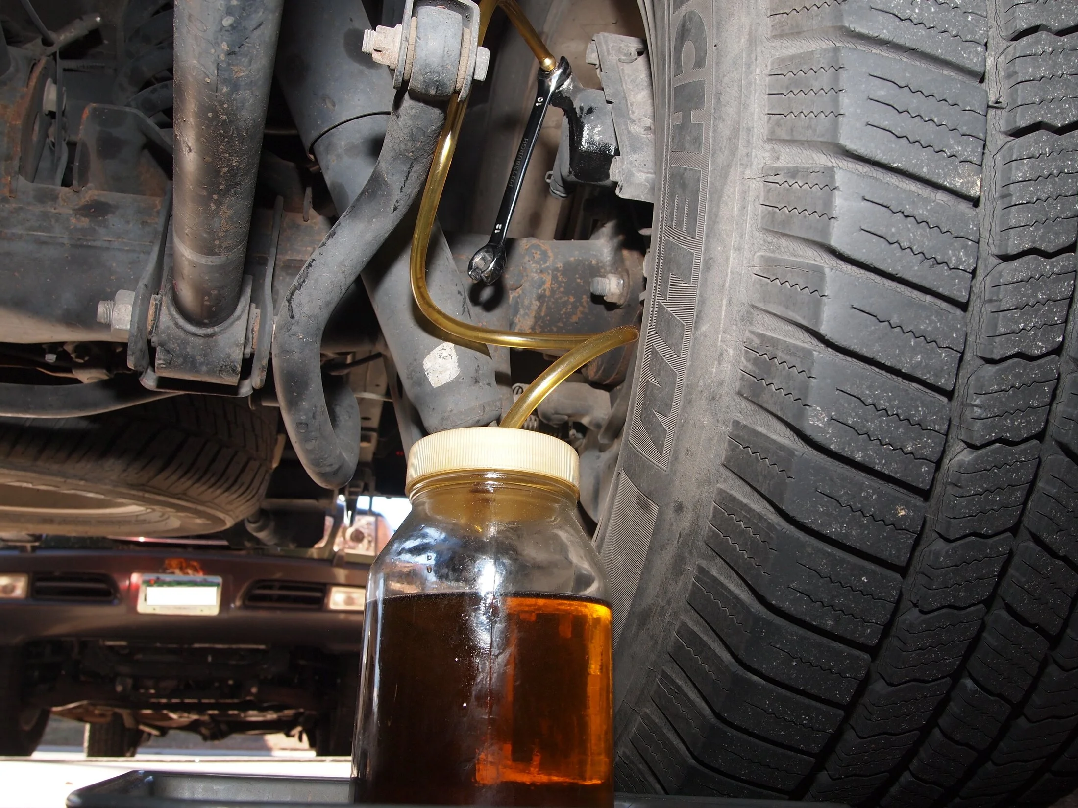

With IG key on and brake pedal depress. Open RL bleeder. Motor/pump, will pump out fluid from rear bleeder. As long as IG key ON, battery has a charge, brake pedal held down (depressed) and a rear bleeder open. Use pump to do the work, only works on rear bleeders.
Remove approximately 1 qt. (If reservoir was, properly filled to max line. It fills a qt. jar)
Note: (IG key ON, brake pedal depressed and rear bleeder open. Brake booster motor/pump, will run continuously, pumping fluid out rear bleeder. Do not allow to run excessively (2 minutes or more) long. Doing so can burn up motor.

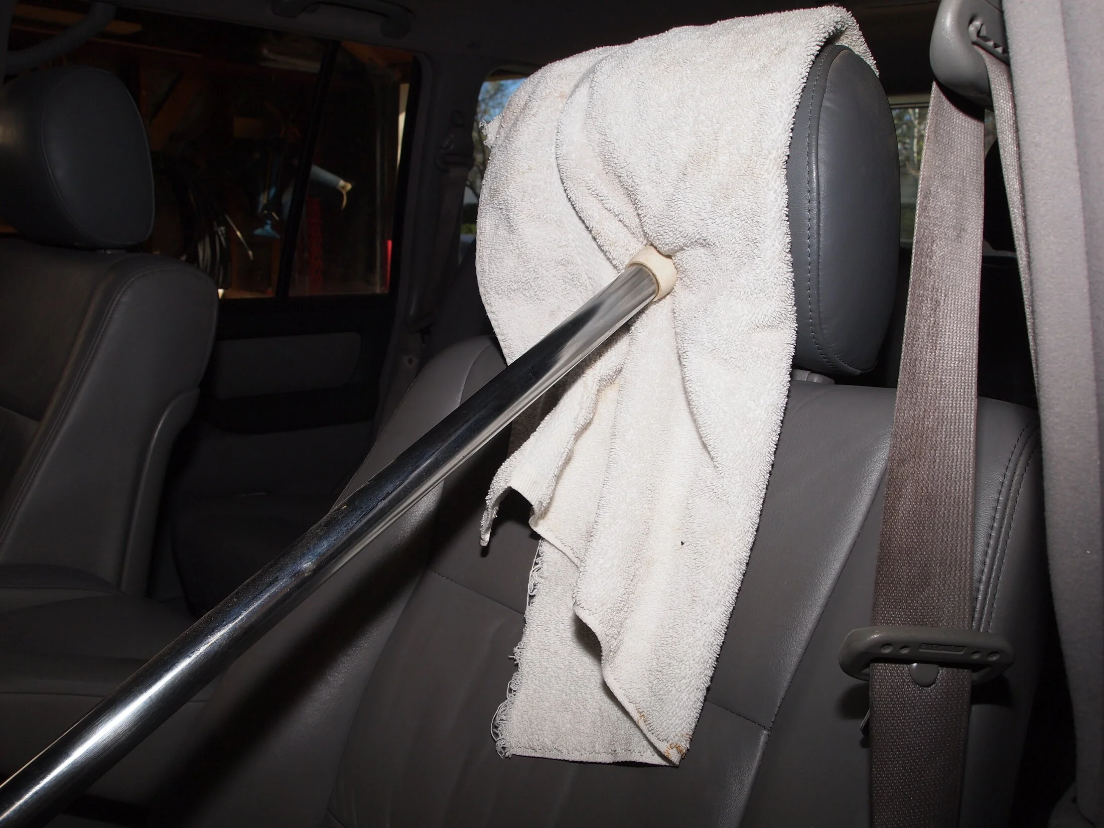

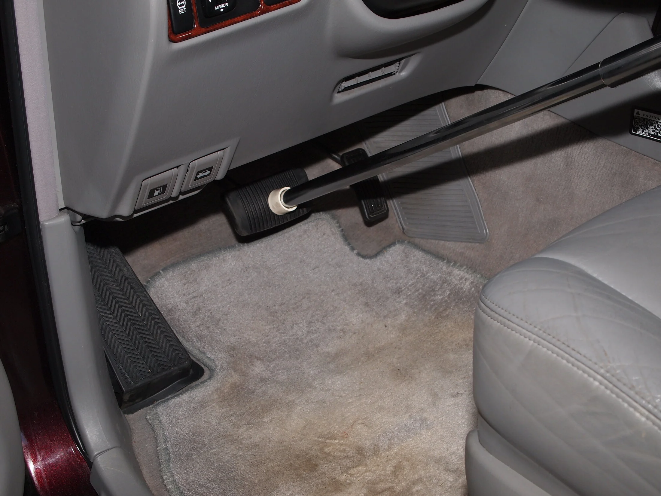

My little helper when working at rears, to hold down brake pedal. A shower curtain spring loaded pole.

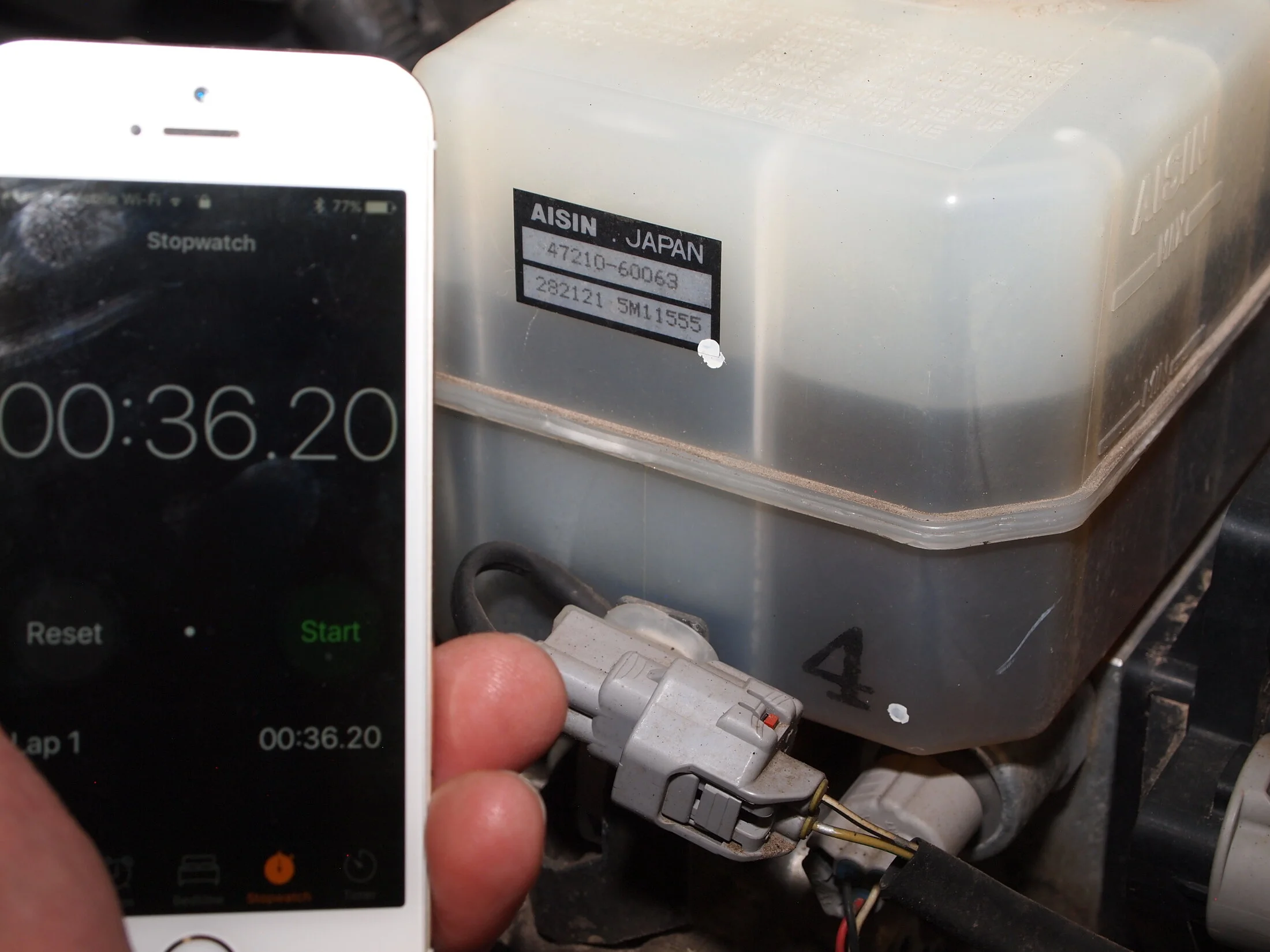

6) Now check for air in system:.
Battery voltage at 12.3V or better. (Best at 12.7V or greater)
IG key off.
Pump brake pedal 40 times, evacuating accumulator.
Top level in reservoir to max line.
Time how long booster motor runs, until stops/accumulator charged. Turn IG key ON, booster motor will be heard as it runs and fluid will drawdown in reservoir. Charging accumulator. (Note: motor will likely, pause a few time. Which is normal)
A time of 30 to 40 second is good. Closer to 30 second, indicates a stronger booster system and a good Toyota brake fluid. (non Toyota brake fluids, often result in longer charge times)
Remember also: low voltage, time will be longer as motor/pump run slower.
If time over 40 seconds, re-bleed.

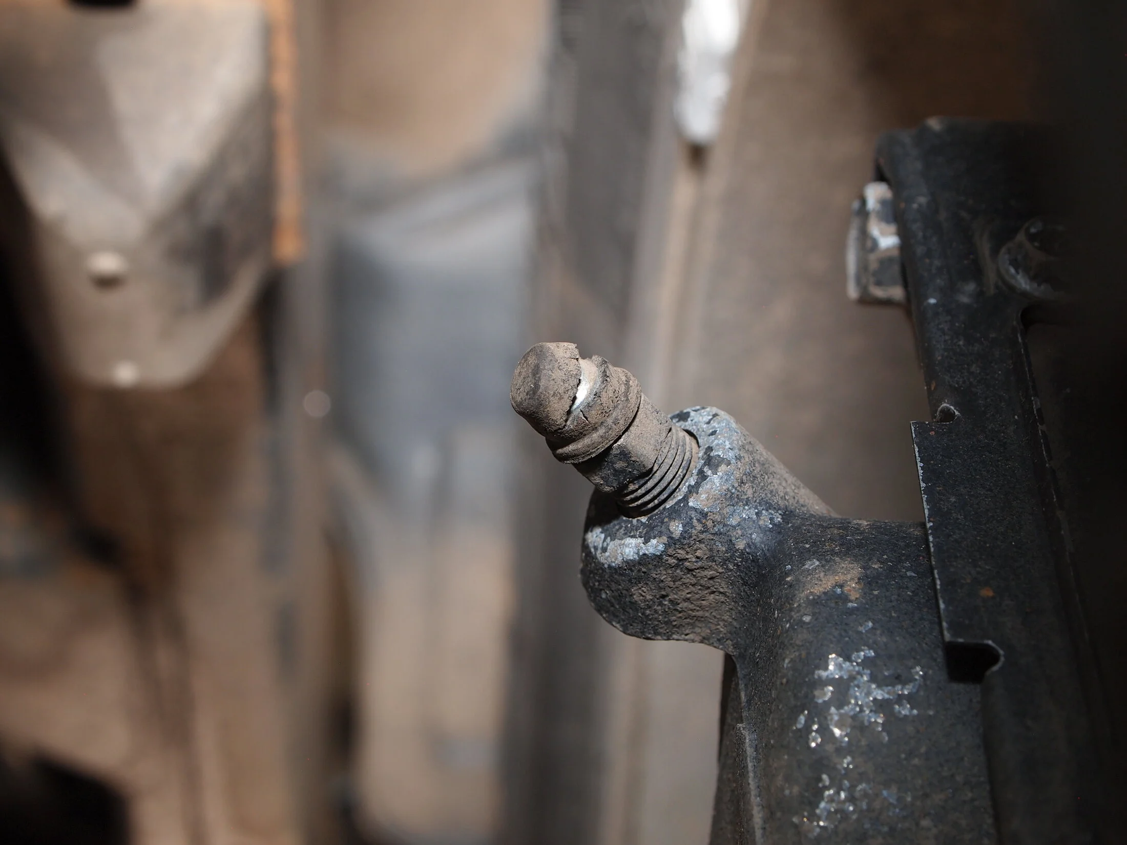

If bleeder clogged, it will likely need replacing. They get clogged because of rust inside bleeder, due to not being capped. Rear bleeders, are the ones I see having issue the most. If rust gets into bleeder seat of caliper. New bleeder will weep. Then a new caliper is needed.
If not OEM caliper and or bleeder match, we see angle of seat issues. These are a PITA and may leak. It is one of the reasons, I avoid non OEM bleeders and calipers.
