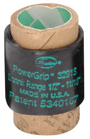

would be a good idea to replace the clamps also at that mileage just to make sure you don't get any leaking after
I have been using Gates Power Grip hose clamps with great results. They are basically industrial heat shrink. They were developed for big rigs using silicone hoses to stop leaks during freezing weather. Cool thing is that they will tighten with heat cycles if any gaps develop. I've not had one leak aside from initial start up yet. had a small leak, hit it with a heat gun while running and the leak stopped, never came back. More money than standard clamps but well worth it to me. Much cleaner look as well.
