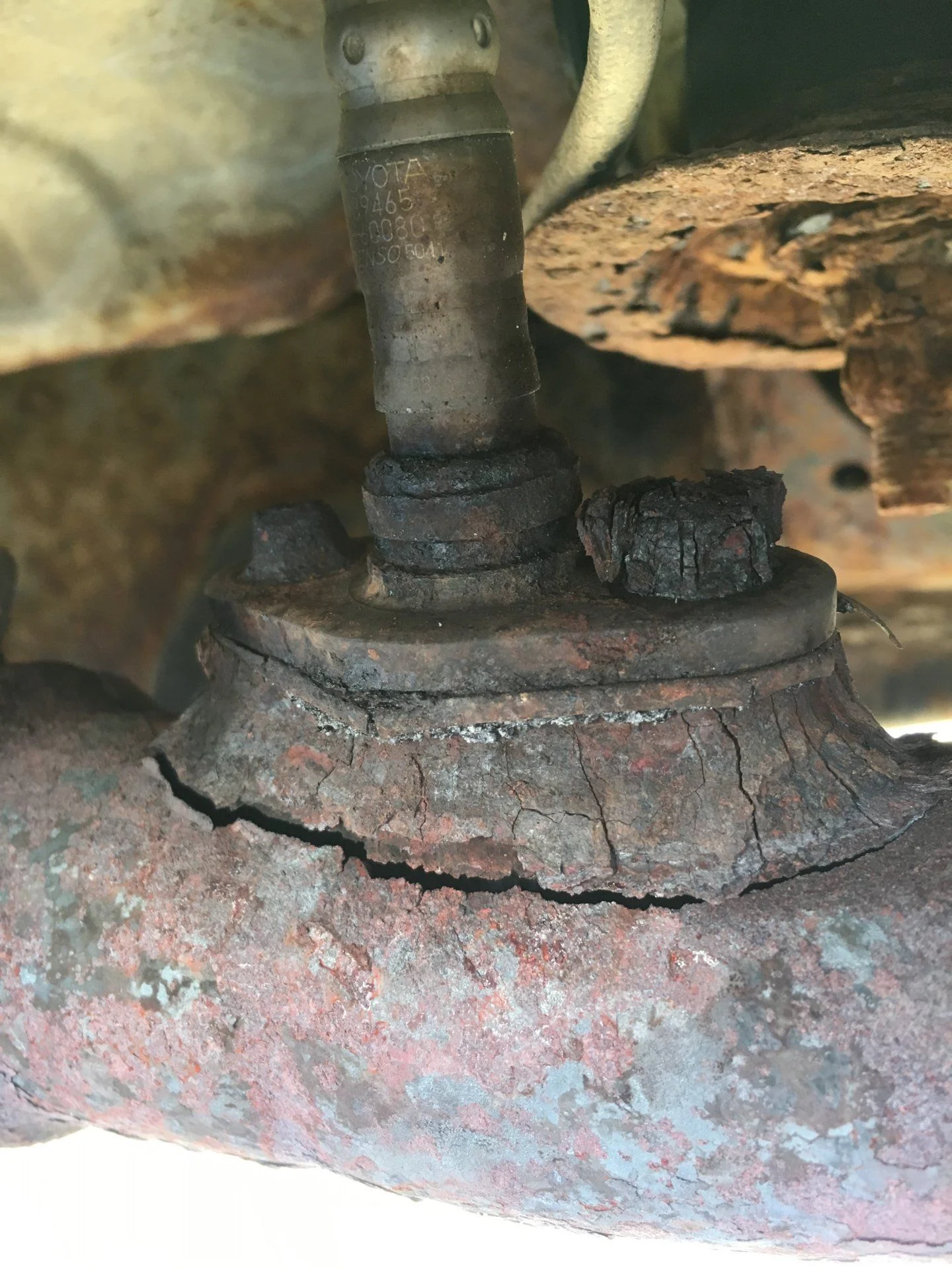

I'm writing to share my experiences with the bosal brand y-pipe available all over the internet. I installed this part back in Feb of 2013 and paid $198 shipped.
You can see what has just recently occurred in the attached picture. Fortunately for me this item is under warranty and I will be receiving a new one for free. I am recommending to anyone needing this particular part to stay away from this brand all together and look elsewhere. What a piece of crap!

My bosal needed extensive modification to fit. Had to "spread" the Y like an inch and brace with a wood block in the middle to even get it to bolt up to the manifolds, then the rear of the pipe didn't reach the factory 2nd cat--had to weld in an extra 2" of pipe. Total piece of crap.

Take a deep breath and stand Back from the pile of rust formerly known as a Bosal Exhaust System!
I too, had the same experience many years ago with the "BOSAL". The O2 bung welds were the failure point also, POOR Quality!
When you have the Warranty Exchange pieces in hand, compare them to the quality of the Walker / Magnaflow exhaust, specifically the O2 bungs.
