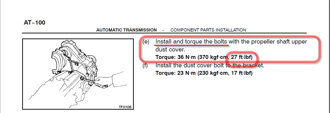

I have come across a few discrepancies here and there in the FSM's, but this one I need to figure out. This regards the 6 bolts that clamp the transfer unit to the transmission transfer adapter. These are 12-mm x 1.25-mm pitch bolts and both parts are aluminum
The automatic transmission FSM for Step-38e of the Component Parts Installation section, states that these bolts should be torqued to 27 ft-lbf. This is the same torque value specified for this size of bolt pretty much throughout this FSM. However, the Repair Manual FSM for Step-9b of the Transfer Assembly Removal and Installation section, states that these 6 bolts should be torqued to 51 ft-lbf.
This is a big difference. I just tried to torque one of those bolts to 51 ft-lbf and I quit at about 40 ft-lbf because it just seemed too much and something was going to break.
Can someone enlighten me here?

Yes, the parts in question are those you showed above. And I am using the same transmission FSM as the one you showed above with the 27 ft-lbf.
Shown below is the Repair Manual FSM with the 51 ft-lbf.
