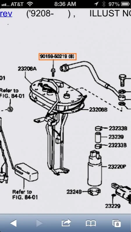

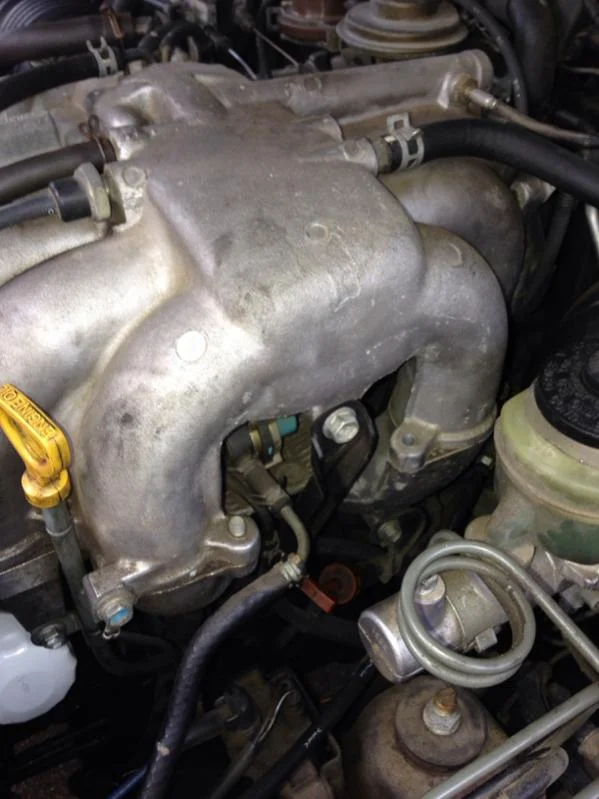

Need to get better at finding part numbers. In the meantime I need some help finding a bolt and a screw. See the attached pictures. First, I noticed one of the bolts is missing that fastens the upper and lower intake plenum. Second, I'm going to replace my sock fuel filter and one of the 8 philips screws that holds the fuel pump cover down is stuck (even after a healthy dose of PB Blaster). I think I'm going to need to pretty much destroy the screw to get it out so I'll need a new one when I button it back up. Any idea what the part numbers are on these? I need to get some shipped my way.

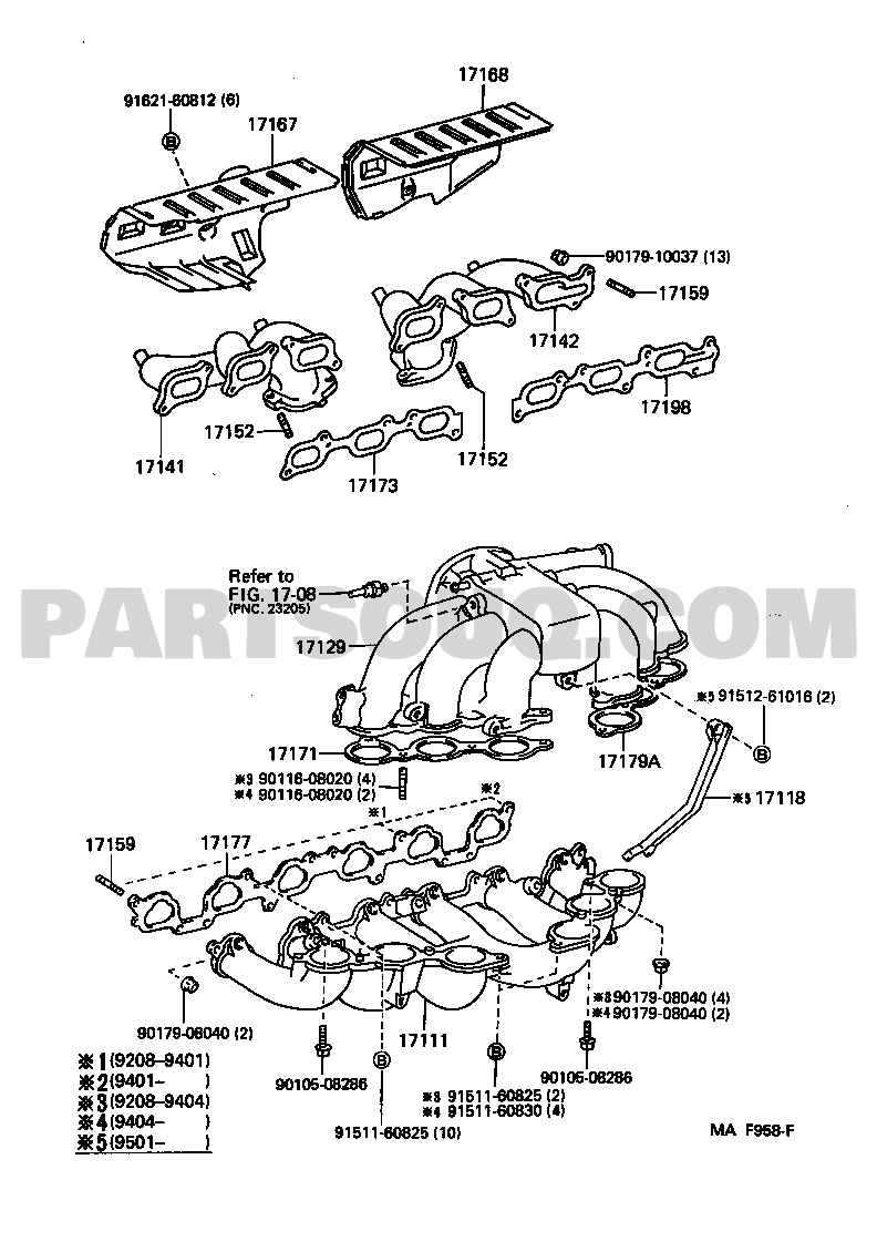

I think that's the bolt you're looking for. Not sure what your saying about the fuel pump cover. Pic?

Guess I forgot to attach pics...
Your plenum bolt may be one of the two part numbers from the photo above that has the part numbers stacked on top of each other. The IPB is hard to see on the site for what goes where. ToyoDiy has all of these listing under 3 bucks.

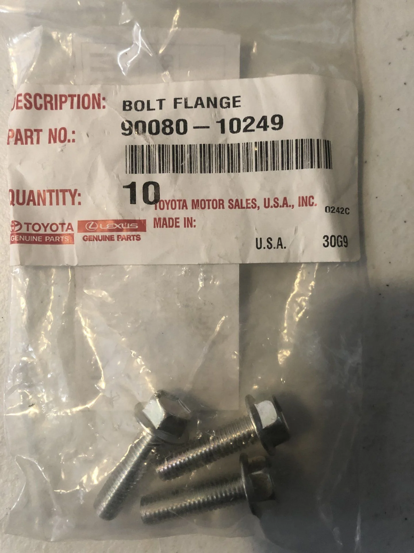

Need some thread resurrection help guys. Snapped off and upper air plenum bolt due to a terrible torque wrench. The part numbers that I see in previous posts are illegible. Can anyone help me out with a confirmed part number? Thanks in advance.
The correct answer appears to be 2X-90080-10249 and 2x- 91511-60825. 90080-10249 supersedes 91511-60830 I believe.
