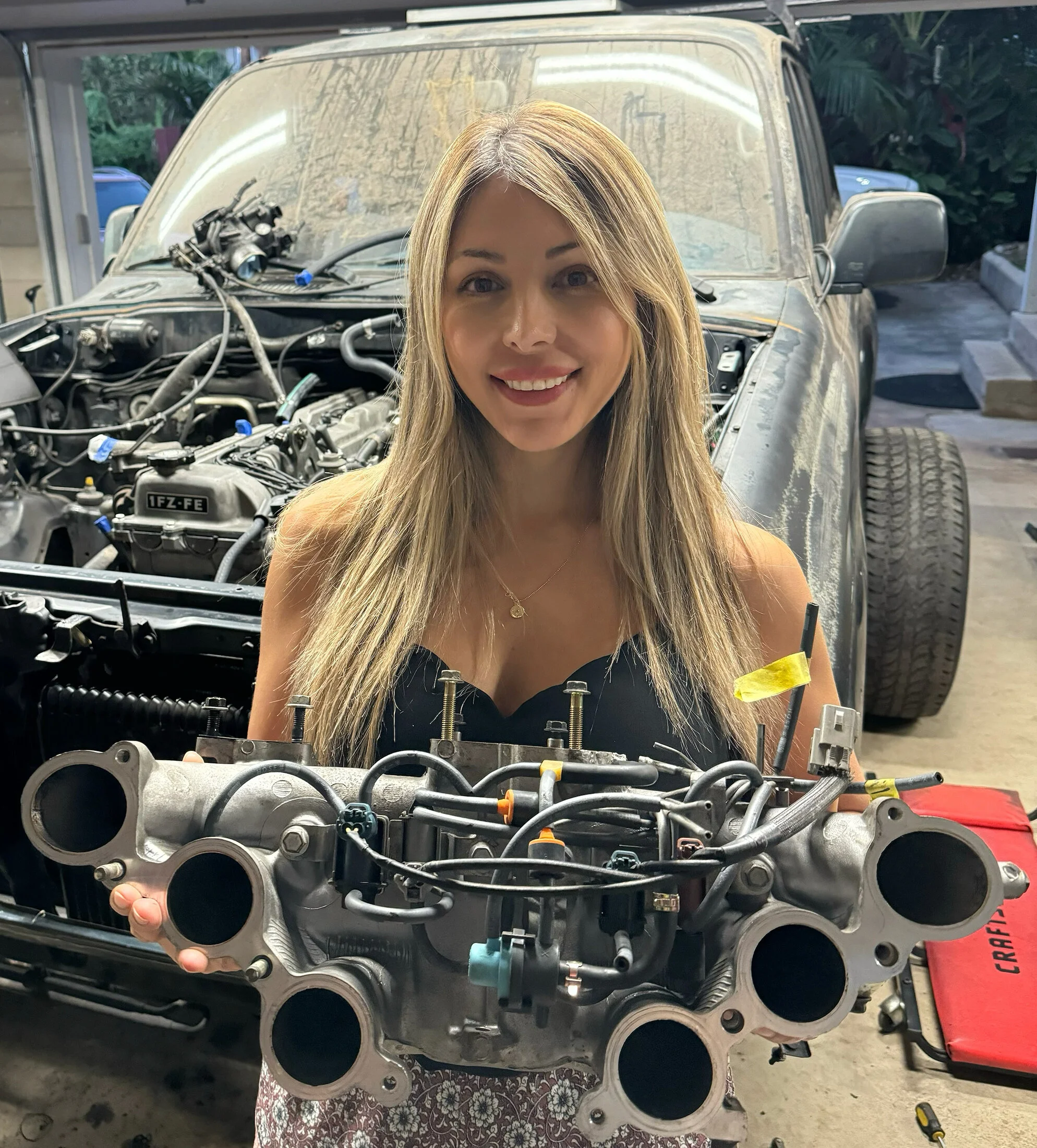

It’s considerably easier to change out all the lines with it off. I just helped out swapping all the lines on our ‘94 80. Buy a bunch of the OEM vacuum line segments, it’s good stuff and relatively inexpensive if I remember correctly. Take an old one off, cut the new one to same length, and put back in same location. Mine were all hard as a rock. Should also use some compressed air to blow out the internal lines through the manifold.

As long as you have some long socket extensions its not hard to pull the upper intake. Once it's off you'll see how easy it is to access everything.
PHH and small coolant hoses
fuel filter
Wiring harness
Vacuum lines
Fuel Injectors
Thanks Zach, now I know what else to have ready once I’m ready to pull it off.

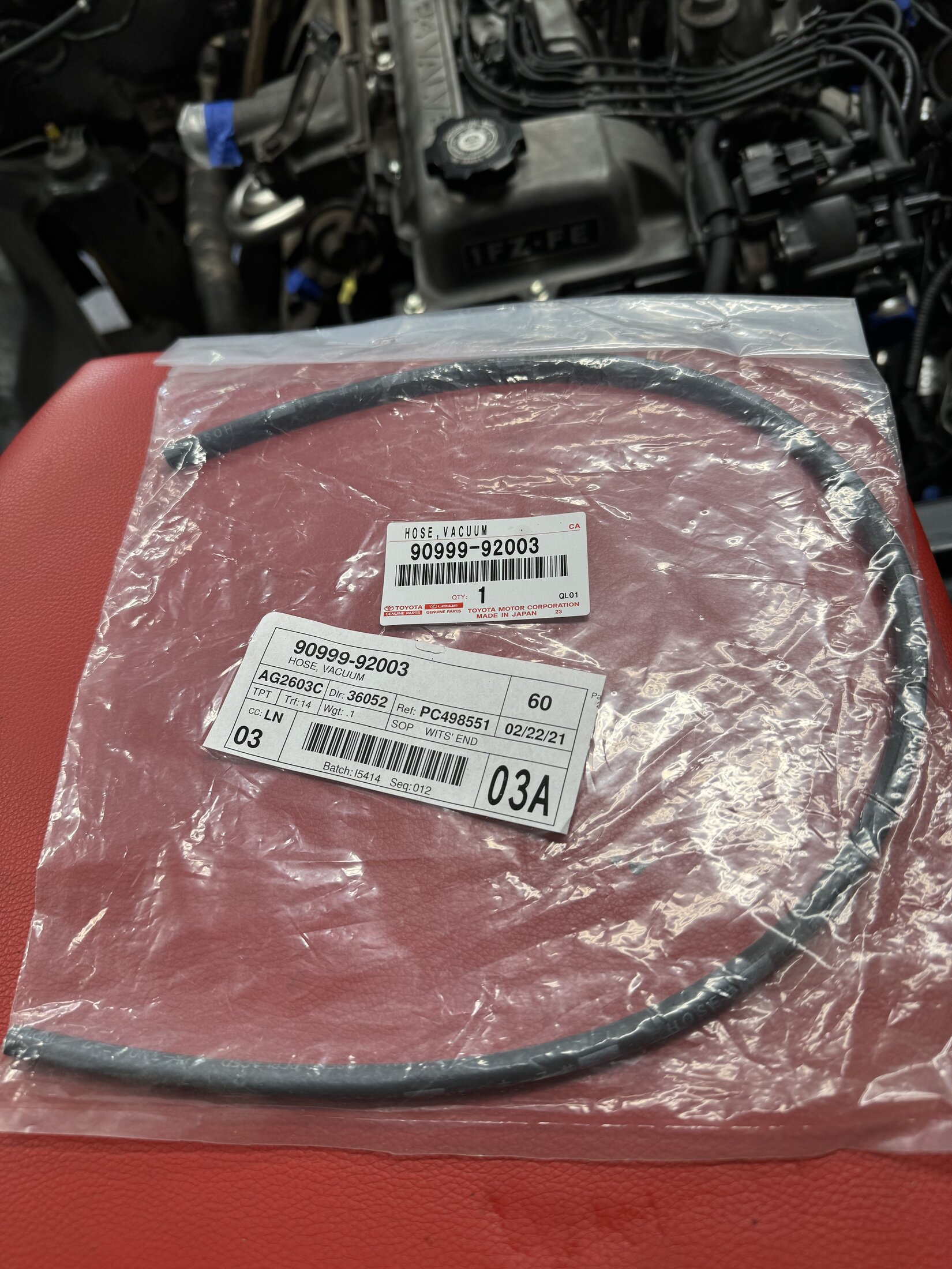

FWIW, you'll need one 1-m length (90999-92004) to replace the entire vacuum lines system. No need to buy short lengths; it's all the same hose.
