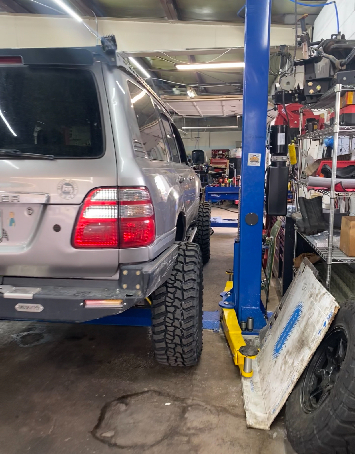

@hoser I have a set ordered from werewolf. They are building custom knuckles to fit a 100 series. They should arrive early May. 74 weld was unresponsive to my emails. Werewolf has been very responsive as well as their US rep, wolfworx with answering questions. I visited Mountain Yotas in Denver to see a set in person, they have a set of Werewolf portals installed on their shop Tacoma running 40s. Dwight was extremely friendly and forthcoming with the instalation process as I was looking do the instal myself. I wanted to see a set in person prior to pulling the trigger. The day I showed up at Mountain Yotas they had just finished installing a fresh set of portals on a customers tacoma and gave me a thorough run down of what their experience doing buisiness with werewolf has been like as well as what their experience with instalations have been like, they had nothing but good things to say. Only cons I could find are price and maintenance, which only entails changing gear oil on regular intervals with your oil changes. I will have to do some fender trimming and cut back my sliders to fit 40s.

Did you end up getting these installed? Did the work well with the custom knuckles?
Yes, I’m still getting them dialed in. I plan on doing a full write up on the kit & instal.
Here’s some pics:
I’ll keep this thread updated.
