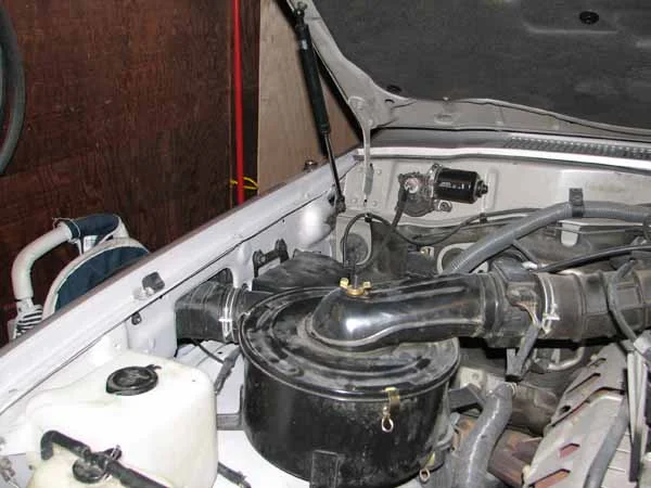

Pics
Here are a couple of pics of the cowl/hood.
You can see the screw a bit if you look at the right angle.
On mine, the gap is probably 1/4 inch.
Hope these help.

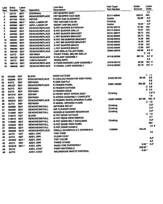

Here is the original estimate from the adjuster. A couple things added were the frame straightening and the inner fender well.

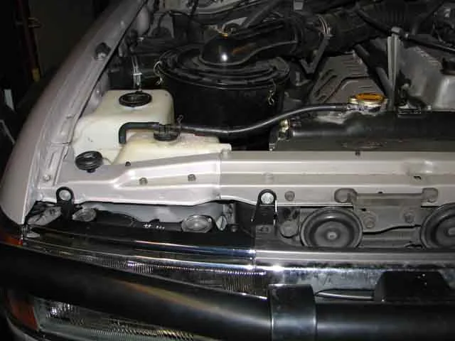

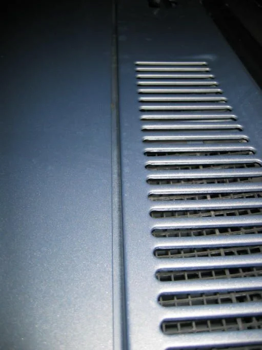

The problems with the body work haven't been fixed yet. Since I am leaving for Japan Thursday and will be gone almost a month, I didn't think it was right to ask the body shop to store the truck the whole time I'm gone. I'll drop the truck off when I return and I'm confident I'll be a lot happier then next time I pick it up. The body shop has actually been really good to work with.
Since I have the truck now, I snapped a couple pictures of the color difference under the hood.
