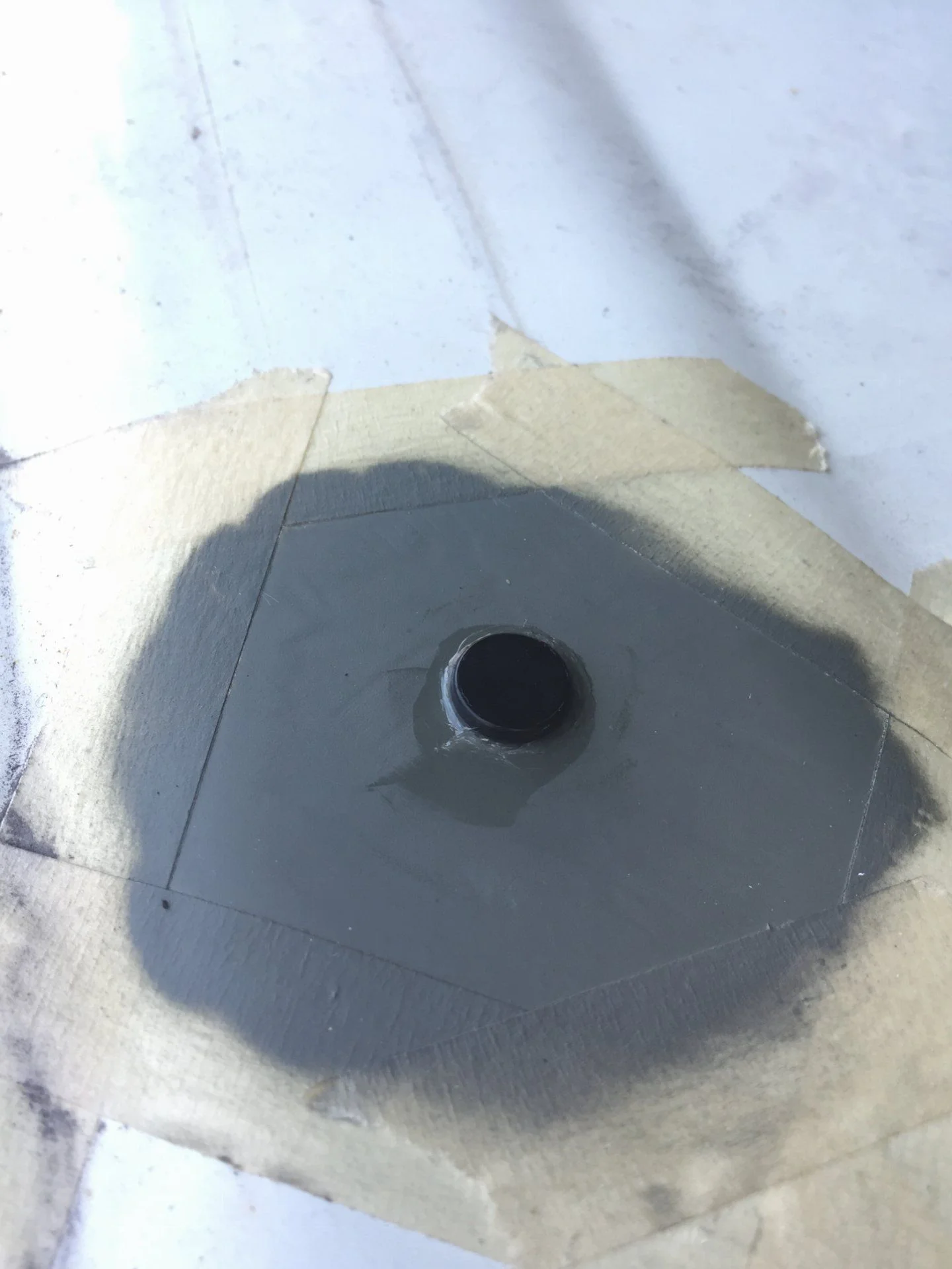

I used steel stick and formed a small button head over each hole.
Exactly what I did on a few of the holes and on the rear spoiler holes. My rack was ripped off from too large of a load so I decided to take off the remaining roof rack parts.

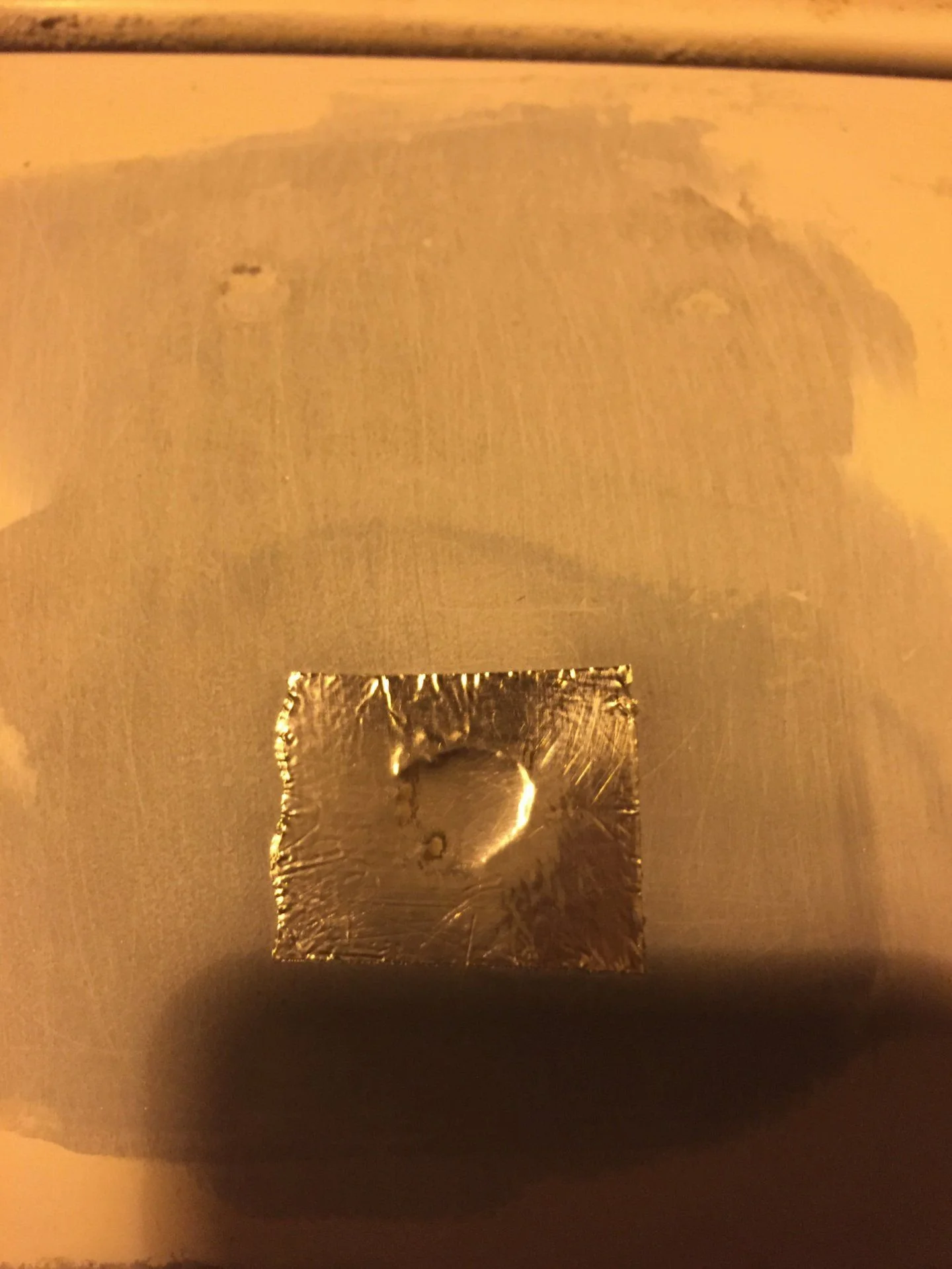

I started by removing the legs/bases and the black strips in the middle of the roof. Grounded everything down then primered. At first I used some plugs from an auto body shop to seal the holes along wth clear silicone. This method was okay but after using the moon roof once, I realized the plugs were too long and were dislodged from the moon roof hitting them. Plus they are black and don't sit flush with the roof. I would use aluminum tape next time instead.
With those two plugs that were dislodged, I ended up using the same method I had done for the spoiler which was using aluminum tape and bondo. I haven't had time to put a top coat on yet.

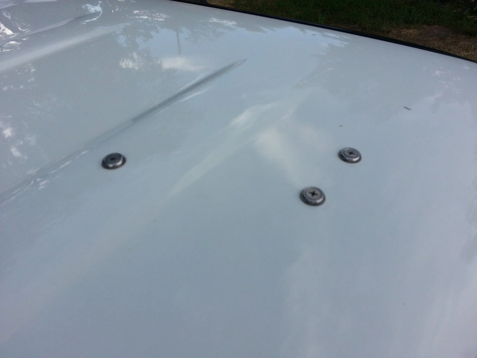

The "correct" way to do it is weld them up.
Second best would be to cap them with stainless screws and finish washers. Other fillers will eventually fail.

Second best would be to cap them with stainless screws and finish washers. Other fillers will eventually fail. View attachment 1504172
X2 on welding them. I used steelstik and it failed. I will be welding mine shut this fall. In the meantime I plugged them with plastic plugs gooped up with a crap ton of RTV. I just checked them this past weekend and they are holding up. They look like sh!t but are still watertight.
I tried the screws but a couple of my nutzerts were loose so they wouldn't hold.
When I did mine I had to replace 1/3 of the nutserts as they were failing. The new ones have held up well since they have been fully sealed and painted around.

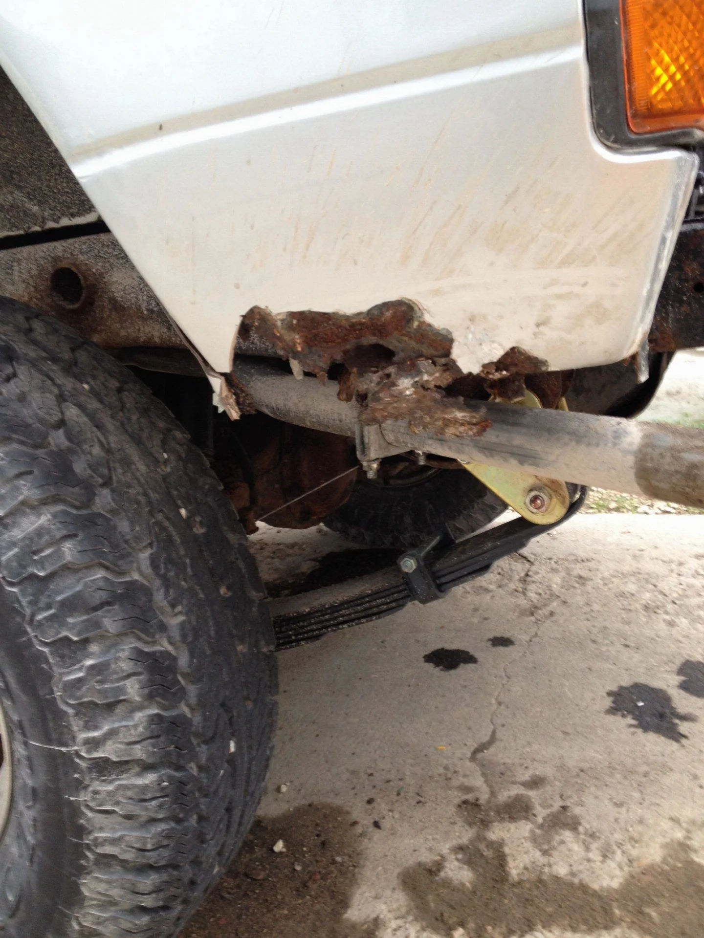

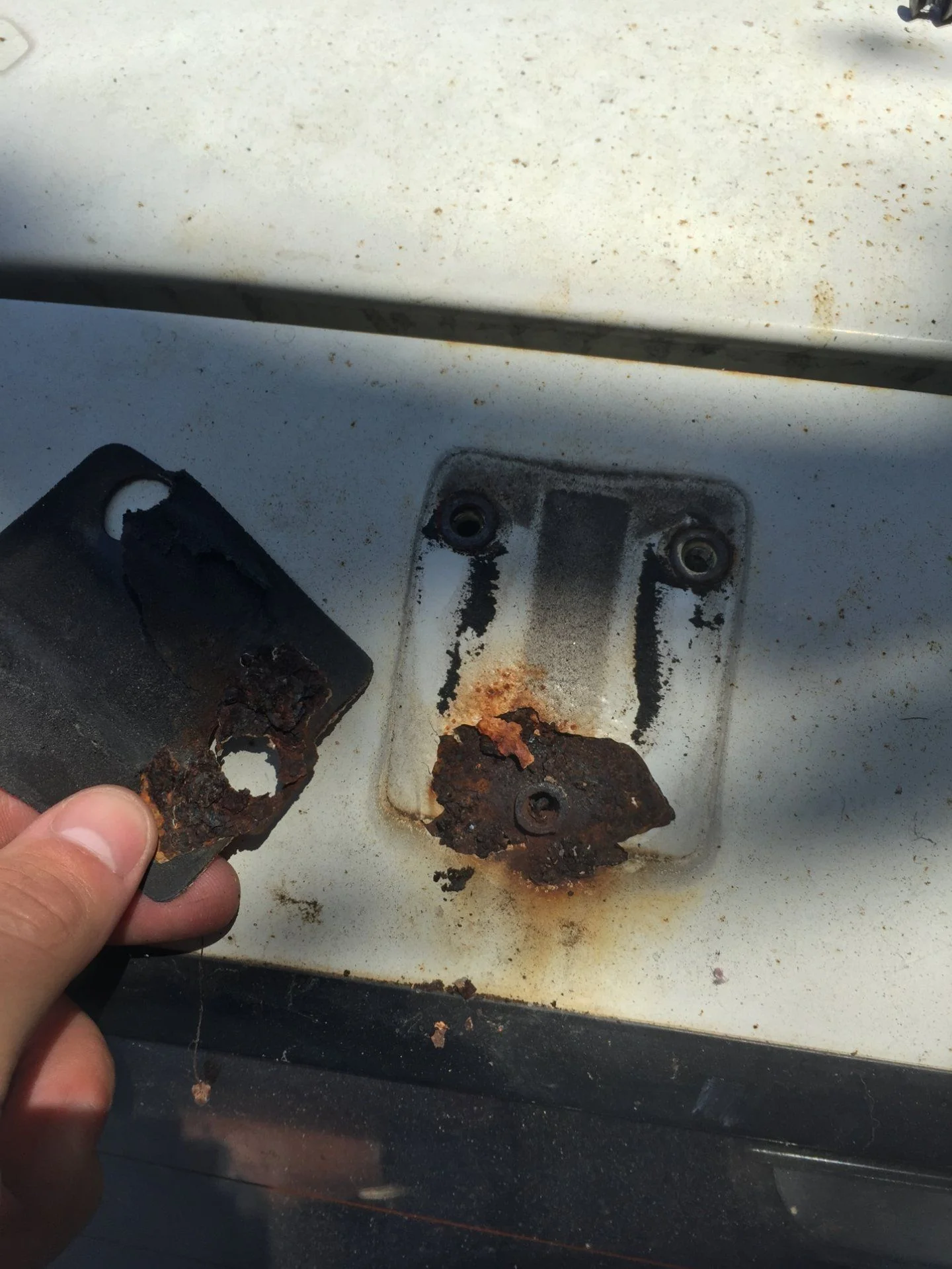

If there is a molecule of rust on any area you patch with any compound, it will rust. If I end up buying your vehicle in 3 years I will be cursing you. Weld it up after All the rust is cut out. Bondo isn't structural it's lipstick on a pig. Sorry to be so hostile but I just spent 3 weeks on the driveway cutting out rust,Bondo,gravel guard,tar,silicone etc. that stuff is short term. Pull h liner look for rusty patina. Clean it up! Be thorough or redo it in 3 years and it will be a mess. Like in the pics. The damage was from a hammer blow beside a rust bubble. The only places real rusty were where the po had done the tar n silicone stuff after the shop paint job. In my climate roof rot p common.
Ok thanks. I will just weld it up. Going to coat it with por15 then top coat with 2k urethane dark grey.
Get a flapper disk n grind till all you see is shiny. You can't weld to tin foil though. Surgeons motto. When in doubt; cut it out

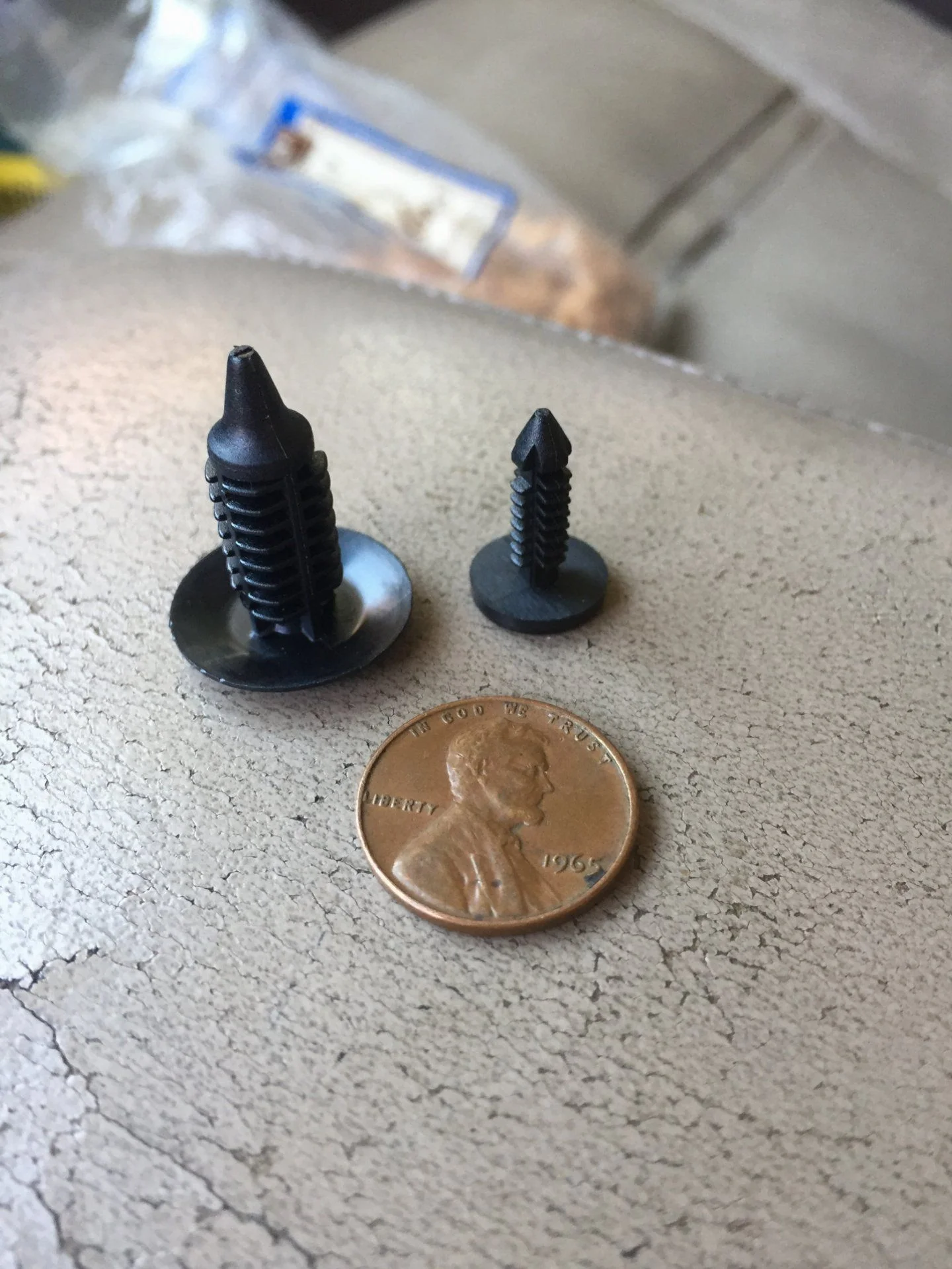

I used Dorman 45680 body plugs and DAP KWIK seal adhesive caulk. 7 years later, no leaks. Takes maybe 10 minutes for all 8 holes.
