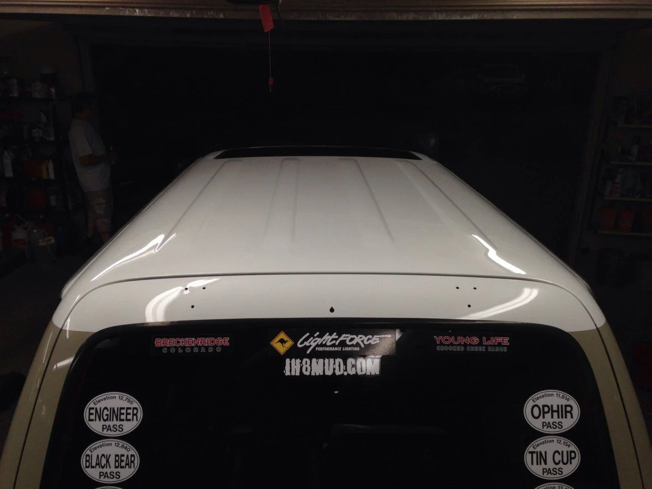

After wet sanding and buffing the roof, it now looks a lot whiter than the old dingy white that was up there.
@bigfj62 Yeah that's what we were going for. It was originally white and we didn't bother repainting it with the rest of the vehicle.
I follow this truck closely. It is one of my favorite 80 series trucks. I love the paint scheme. Keep up the good work.
Nice job; noticed the holes in the rear hatch, appears that the nutserts were removed, are you installing larger nutserts for the wing? What paint and additives are you using, color codes?
