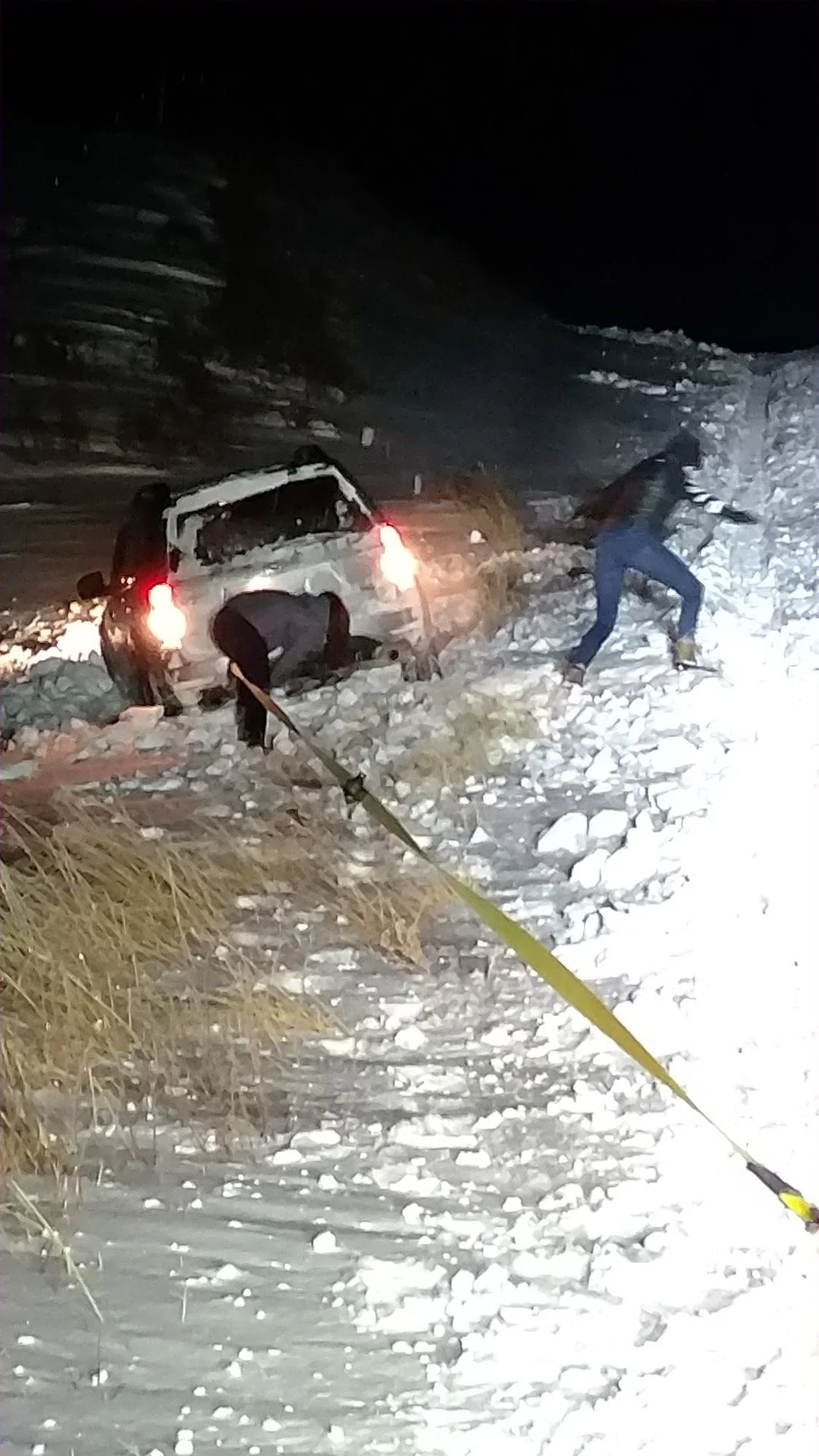

During some night time snow wheeling over Judith Peak in Montana. I broke something while going through deep snow drifts, waist deep snow, 200 point turn around or pulling the idiots out of the ditch in a car (because driving late night with no; gear, clothes, cell services, with the intent to walk out at -6°F, is a good idea) but I digress.
these girls where bitches, calling me names "stupid old man". I wanted to leave them. They were under the influence for sure...

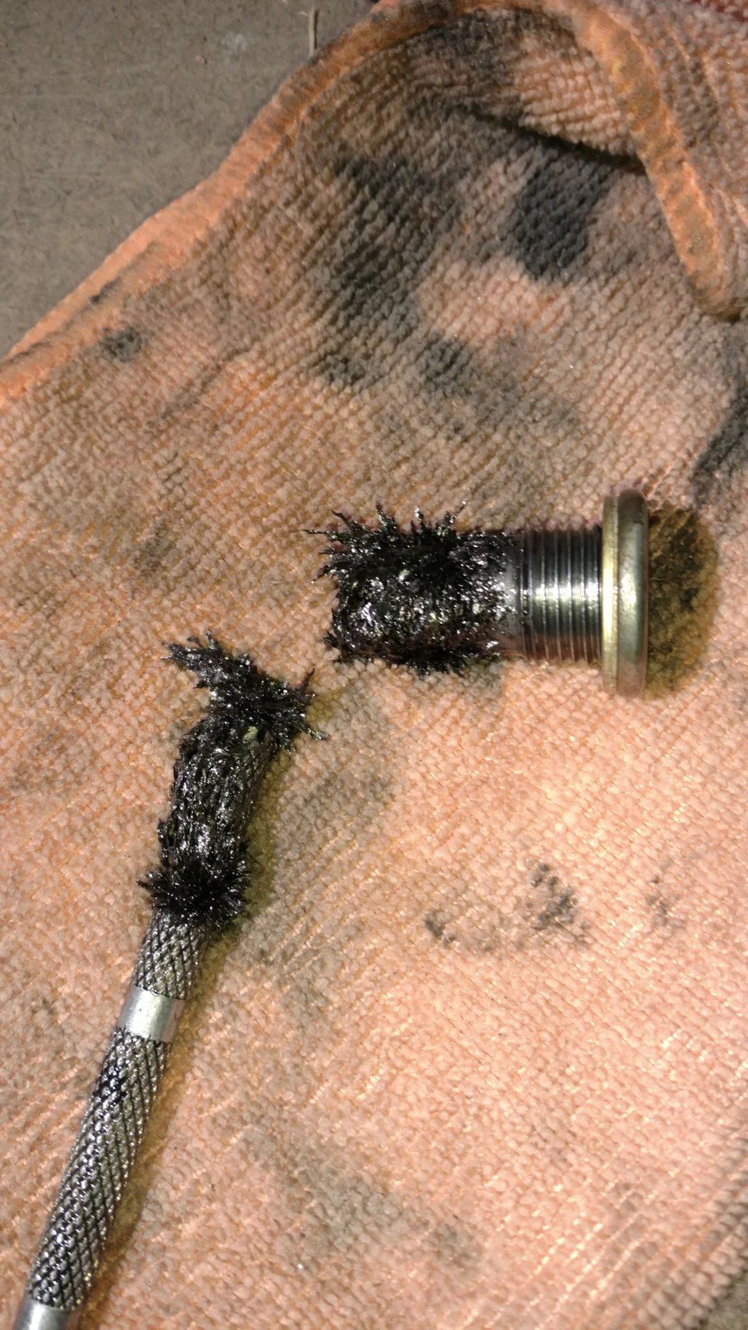

The transfer case, has metal shavings in the oil and I only get power out of the front output shaft. With the center lock turned off I go nowhere it just makes noise like you hear in the video. Only when I engage the center locker I can move. So, I only have power to the front wheels??? Does anyone agree with this madness?

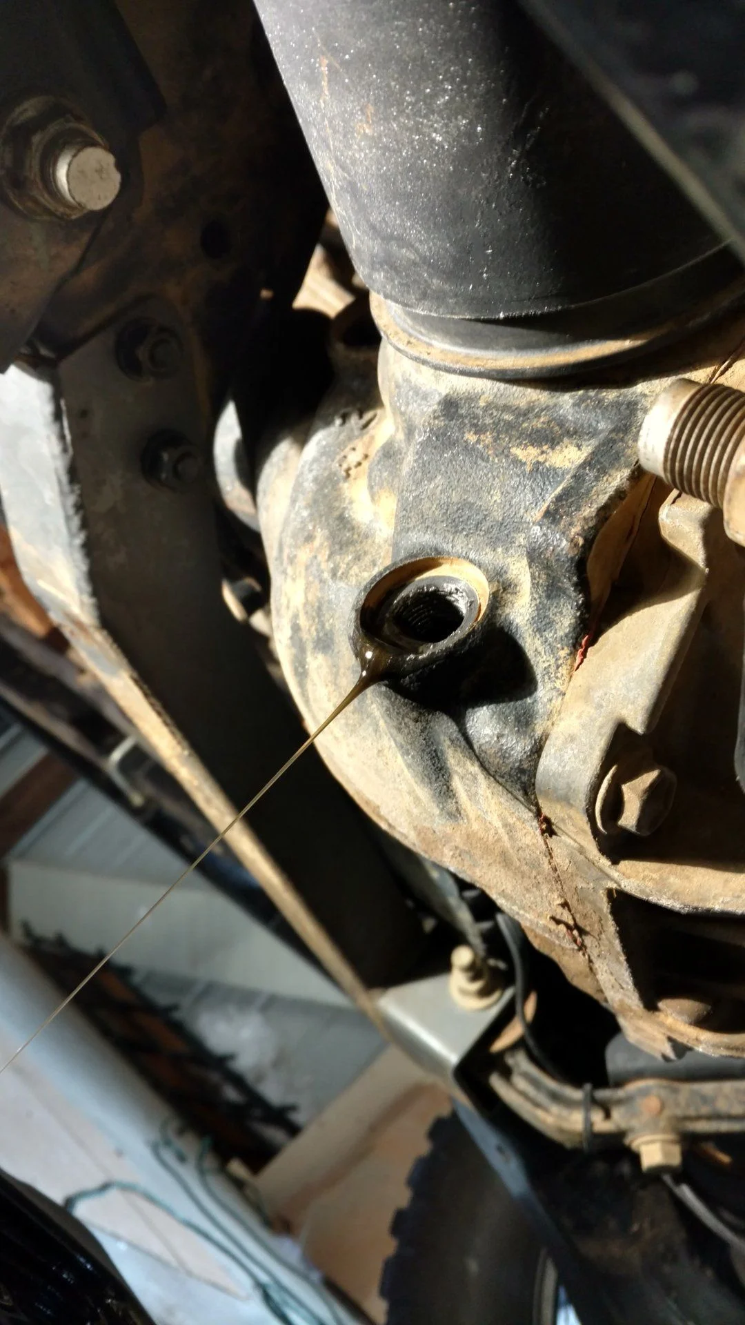

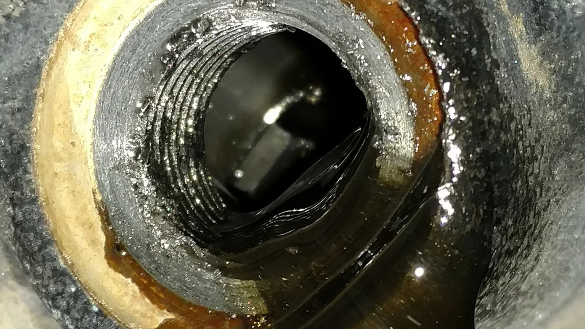

I drained the oil from the front differential and both the fill and drain plugs are jacked it looks like the ends of both plugs got clobbered by metal chunks, and there are tons of chips n chunks on the magnetic drain plug. This front diff solely pulled me and the person I rescued home that night and I think it gave its life up for it. Judging from the pictures I am replacing the entire thing…

hahahaha, no! its funny one moment I'm having fun night wheeling in great snow. Then out of nowhere a car with two girls show up (in the middle of the night and in the middle of nowhere). In about 10 seconds I go from thinking "wow I'm am going to have to explain two women in the snow to my wife... we were just staying warm I swear" to me thinking how much I hate them and how annoying and disrespectful these little s***s are...." well your honor that is why I buried them". then I see them trying to turn off the car and walk. life over limb I thought, don't leave them here and this car will be buried for weeks if I don't pull it. no good deed goes unpunished.
guess what..................................... I saw that girl at my daughters school. She acted like she didn't know me till I got loud about pulling her out, a bitch till the end huh- better start the cat collection now honey.

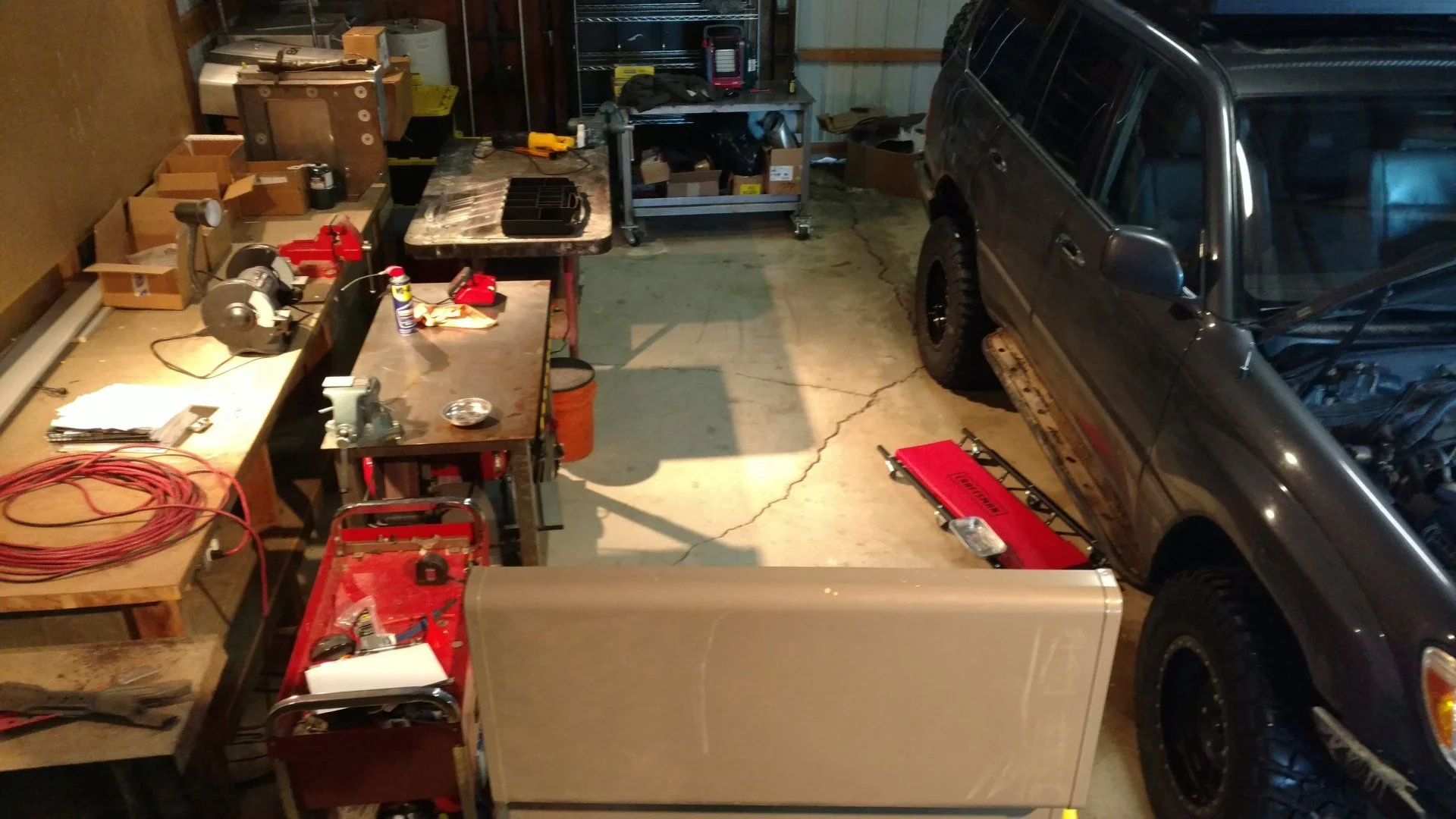

I am replacing the transfer case and the front differential, as well as a few things along the way. I'm at 200k and should do a little preventative maintenance- inspect wheel bearings, replace any seals that need it.
As far as who is doing it.... Me! I'm saving thousands, literally. It will be slower of course but I can afford that. I'll post some picks tonight.
So I indeed have problems with the transfer case. I got small metal chips out of it and the case was starting to leak and a sensor plug was starting to leak and the seal for the transmission was leaking. But the deal breaker was the metal that came out. Some said to leave it some said open it. I spoke with just differentials, those guys are nice, they said something is wrong even if it's little there is a problem. I also spoke with overland cruisers, they are super cool too, and the said the same thing. I for sure have an issue, just when do you want to deal with it. I said I wanted to get stranded with my kids at elevation j/k.
