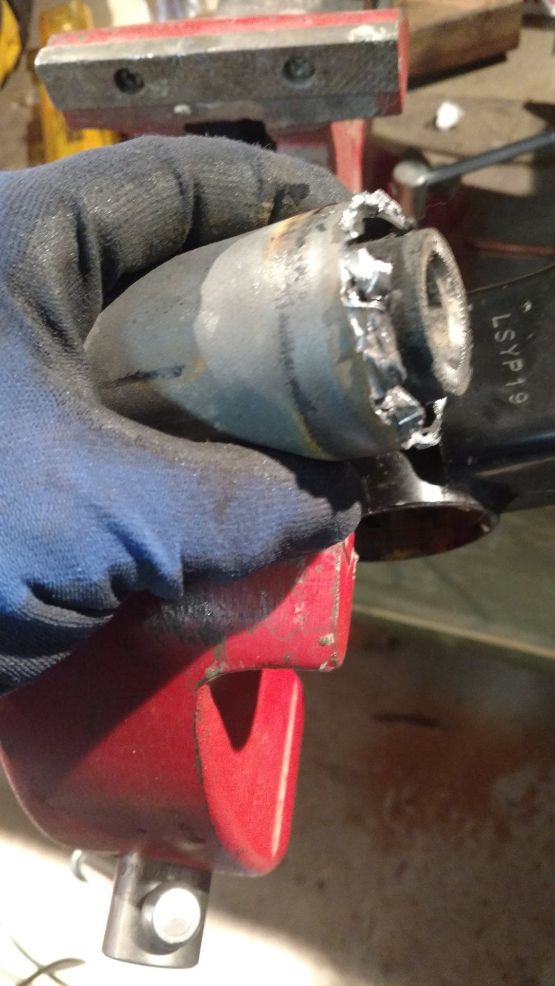

So as I'm dealing with a broken differential and transfer case. I find my front lower control arms are completely falling apart; ALL the bushings and the ball joints are crumbling away... What the f. Rewind 8 months and I had just installed brand new lower control arms from Moog, I saved money, put on the "RK" version, just so you all know RK means garbage. Moog said pound sand, they will only give me the same control arm no refund since it has been over a year. But I said that is when I bought it I just installed it a few months ago they still look new. Moog does not care. Man, hard life lesson right there. I am such a idiot for cutting corners and saving a few bucks, but don't we all want a deal? It has taken longer and cost me more but I am only buying HI end or OEM parts now.
It's hard to see in the photo but this bushing is broken all the way around. I installed it more than perfect. And followed the FSM exactly.
This is the back with no mating surfaces (the small chisel marks bug me too, but are just superficial and I should have painted over them). Completely broken bushing all the way around.

bummer on the control arms.

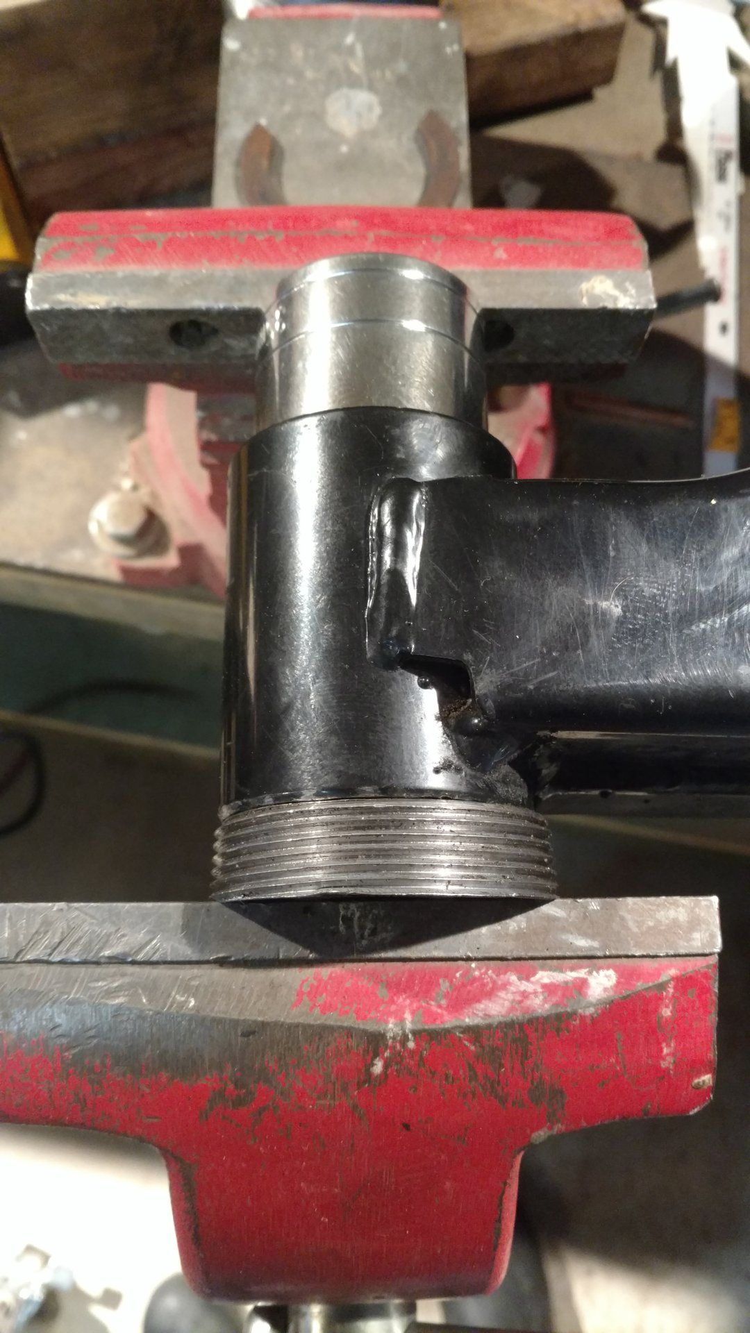

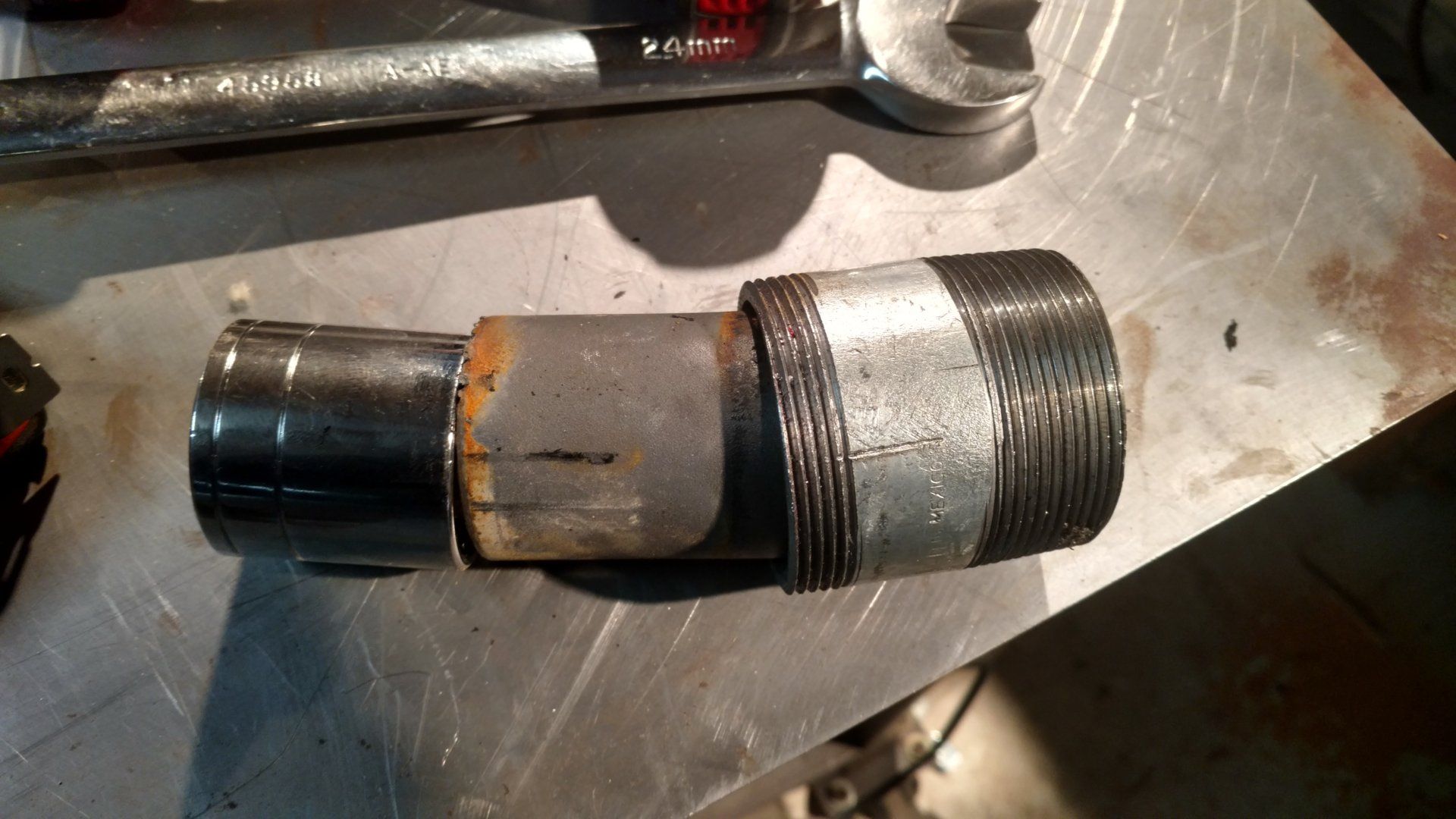

I used a vice, a good one, and pressed out the bushing in the control arm. Don't laugh at my tooling, I was in a pinch.
This is a Wilton vise with a 6-3/4 opening. I had to press in steps.
