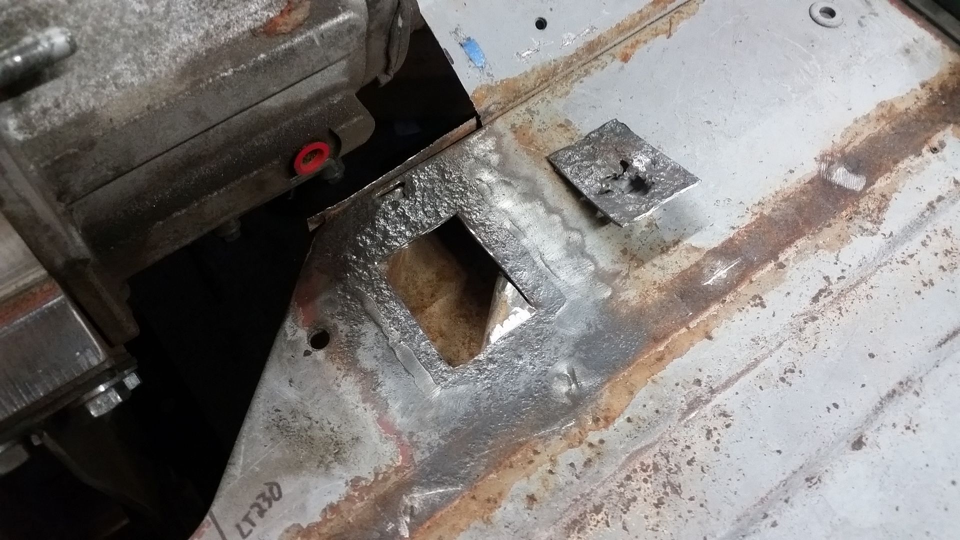

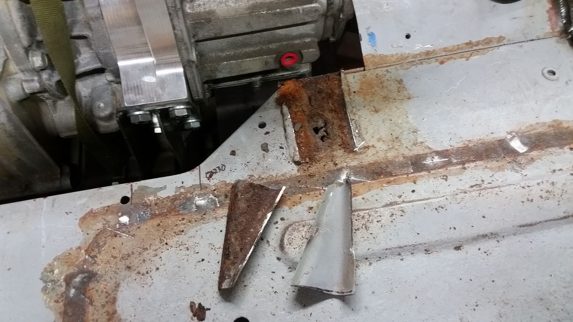

I wonder what is under here....
Well that sucks. I am glad I found it really, but yuck. It looks like it was just a water trap in the stock design. The metal on top was very rusted but the oem paint was still on the bottom.
I couldn't really cut out the entire area easily because this was over the top of one of the hat channels.

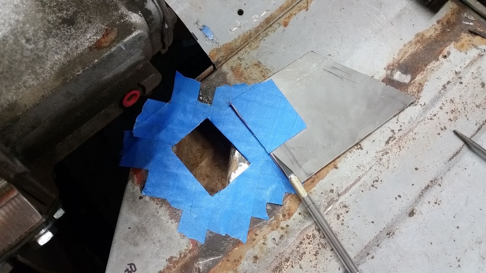

Carefully cut out as much of the bad area as you can. I use a thin cut off wheel in the a 4.5" angle grinder when I can, but I had to use a dremel tool for most of this because of the tight quarters.

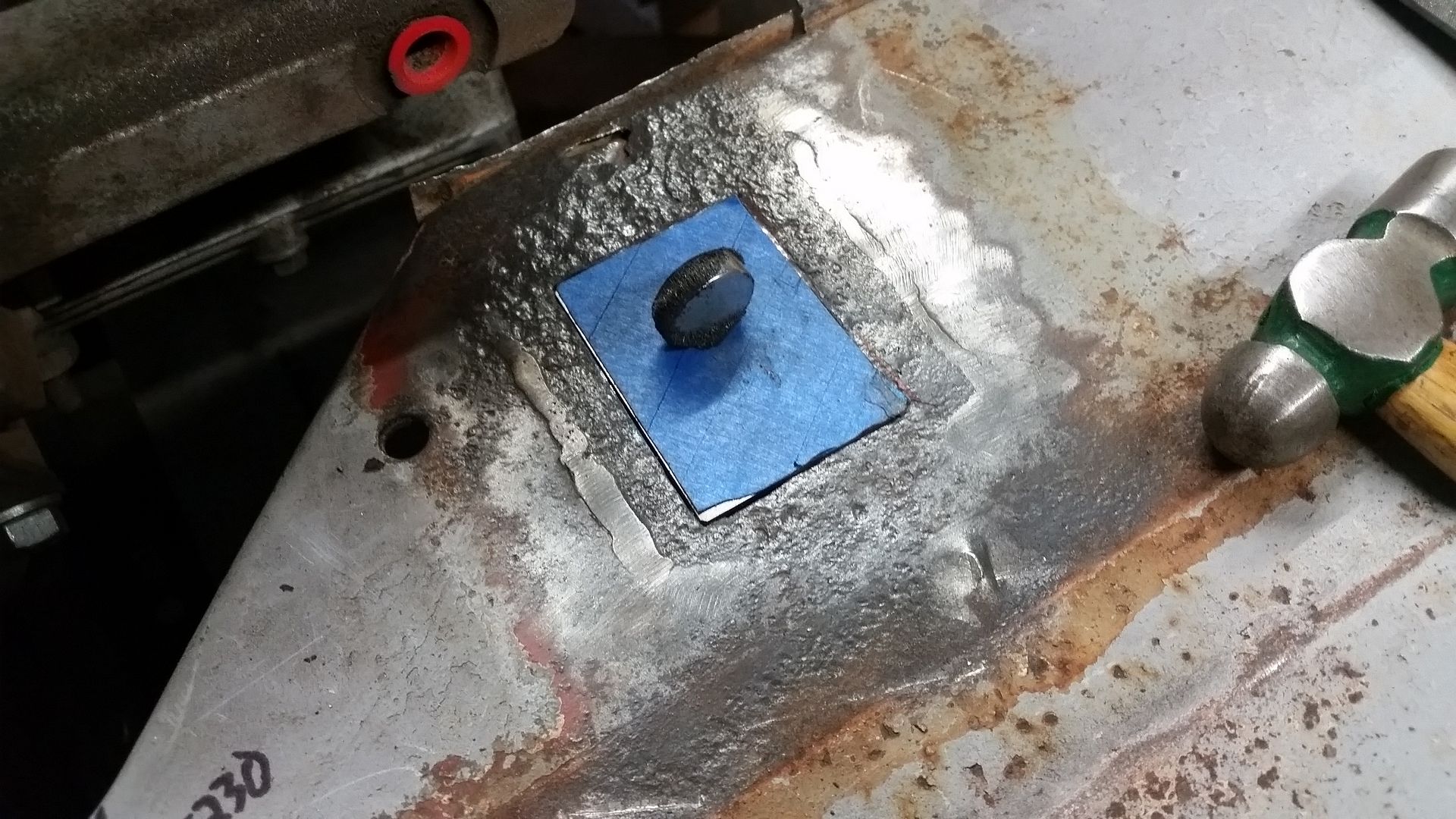

Need to make a template of a patch like this? I use two opposing layers of masking tape. Then you use a narrow razor knife to cut out the template. Stick the template to the metal you want to make the patch out of. You can cut a little big and trim if needed...
Need to hold a small patch like this? Use a magnet. Magnets also work well to level the edges if they are strong enough.

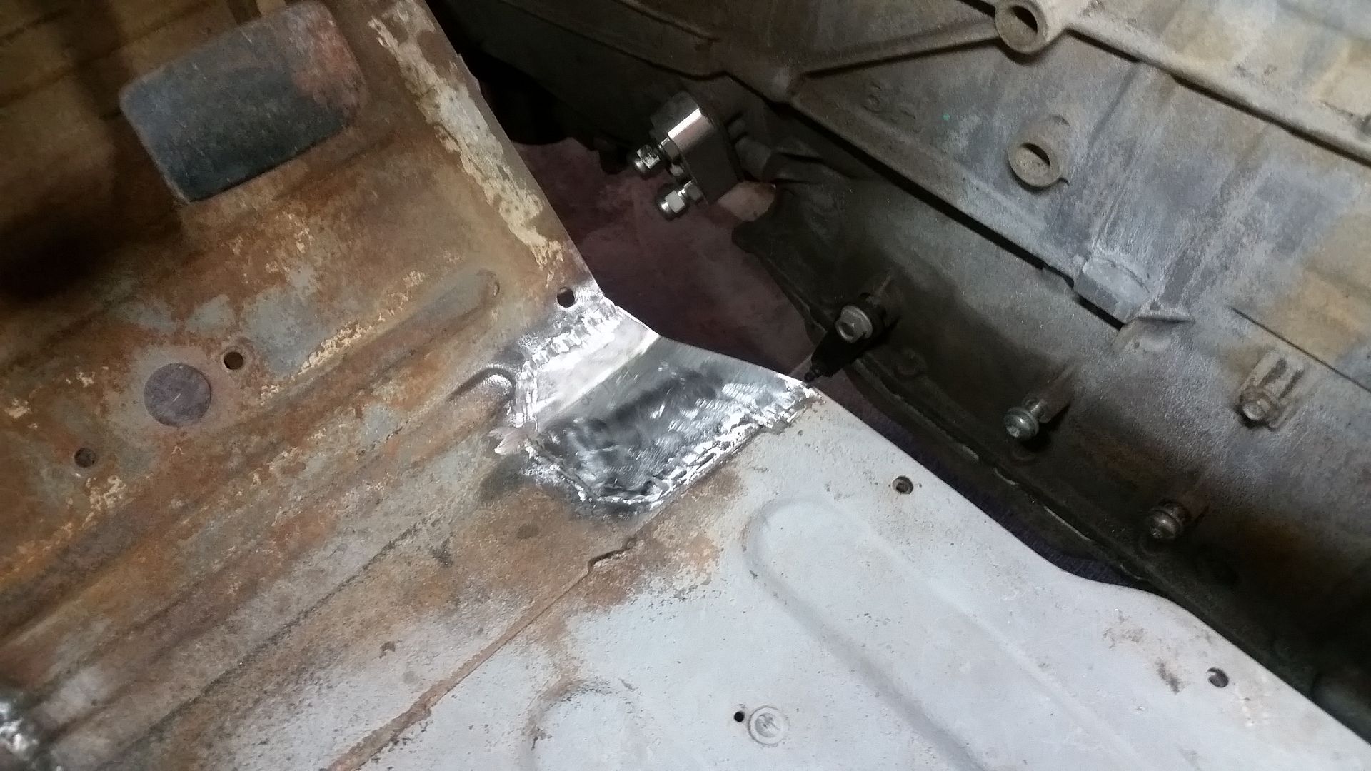

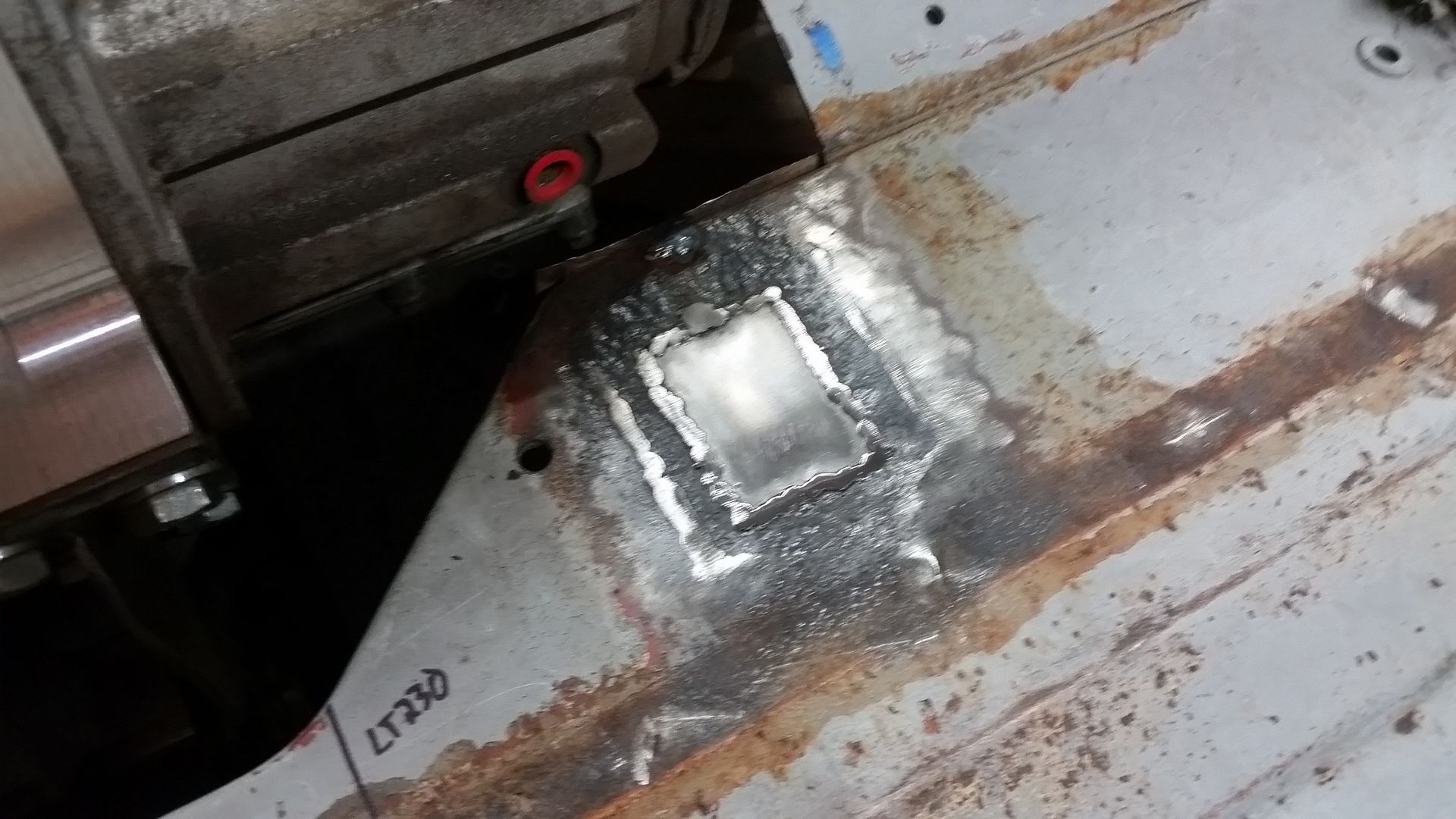

Welded in place....clean it up a bit. I tried not to get carried away yet since the base metal isn't the best on the one side.
I also had to make a thin curved filler piece to weld the rear section of the floor to the B-pillar spreader. I had to use a little jack pressure on the 1" strap flange I had added to level things up into position. Once this was welded it REALLY firmed up the floor, especially on the drivers side. The floor on the passenger side is still kinda floppy. I need to add some kind of extra support if I want the tunnel to be removable.
I also cleaned up the patch under the drivers foot some more. I like how that turned out. That bump was dumb.

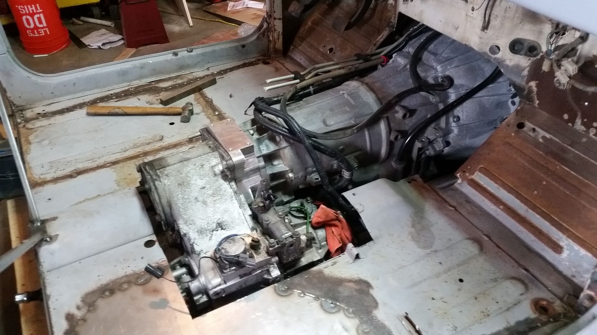

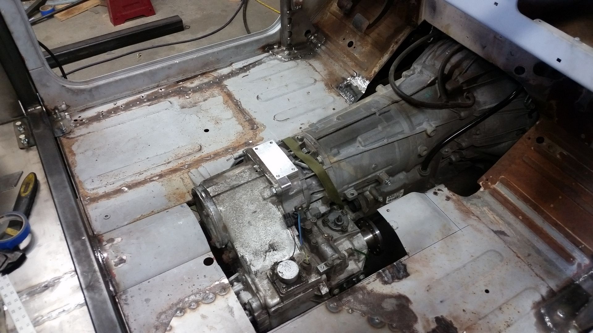

This is what I have to work with now. I am thinking I am going to remove the left over 'bump' where the transfer case was also. I think that just clutters up the floor. I think I can replace more of that with a flat piece or maybe a triangle of material back to the towards the transfer case.
I am still thinking about removing more material behind the transfer case to help removal perhaps. The crank centerline is above the level of the floor for sure.

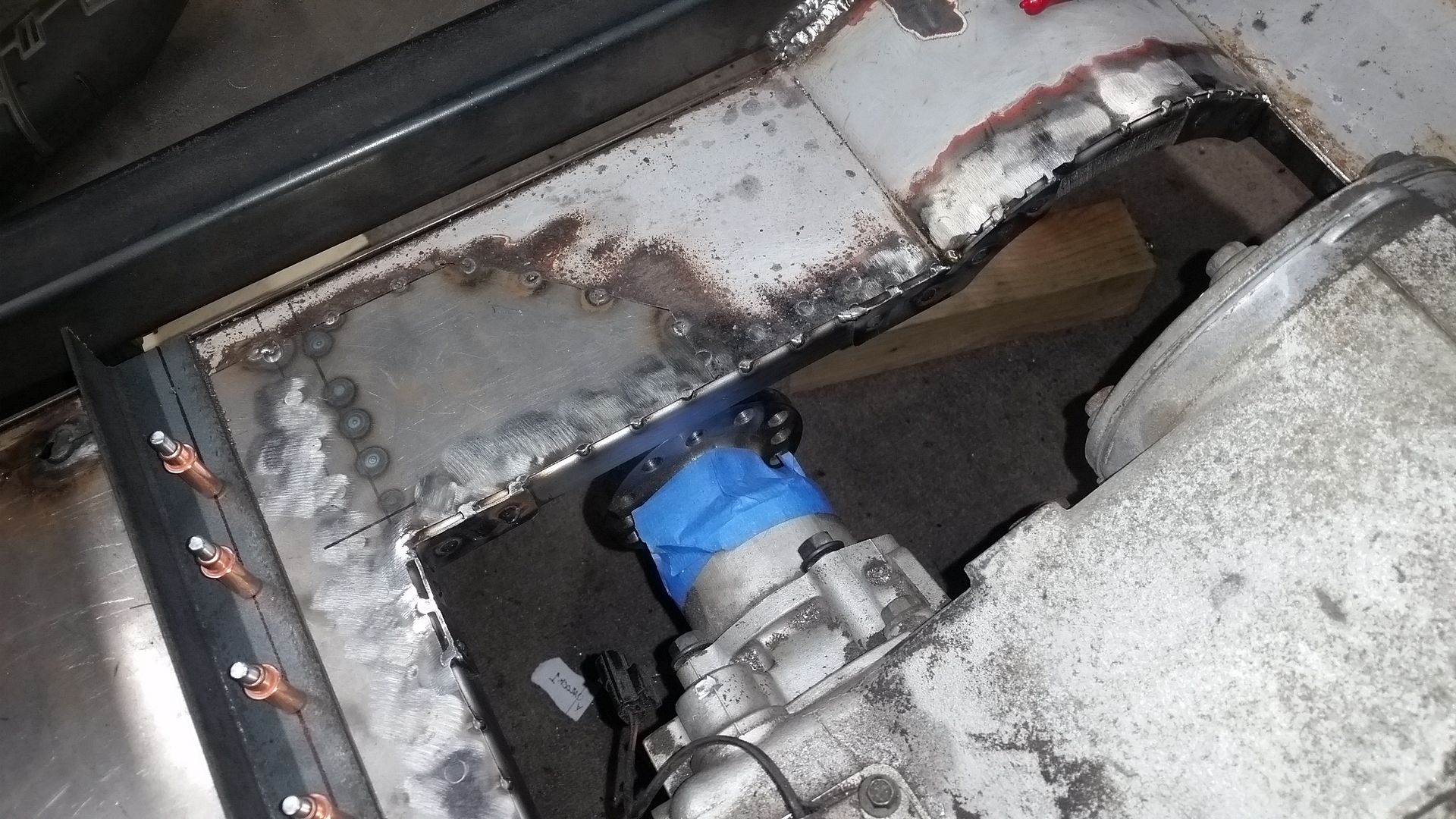

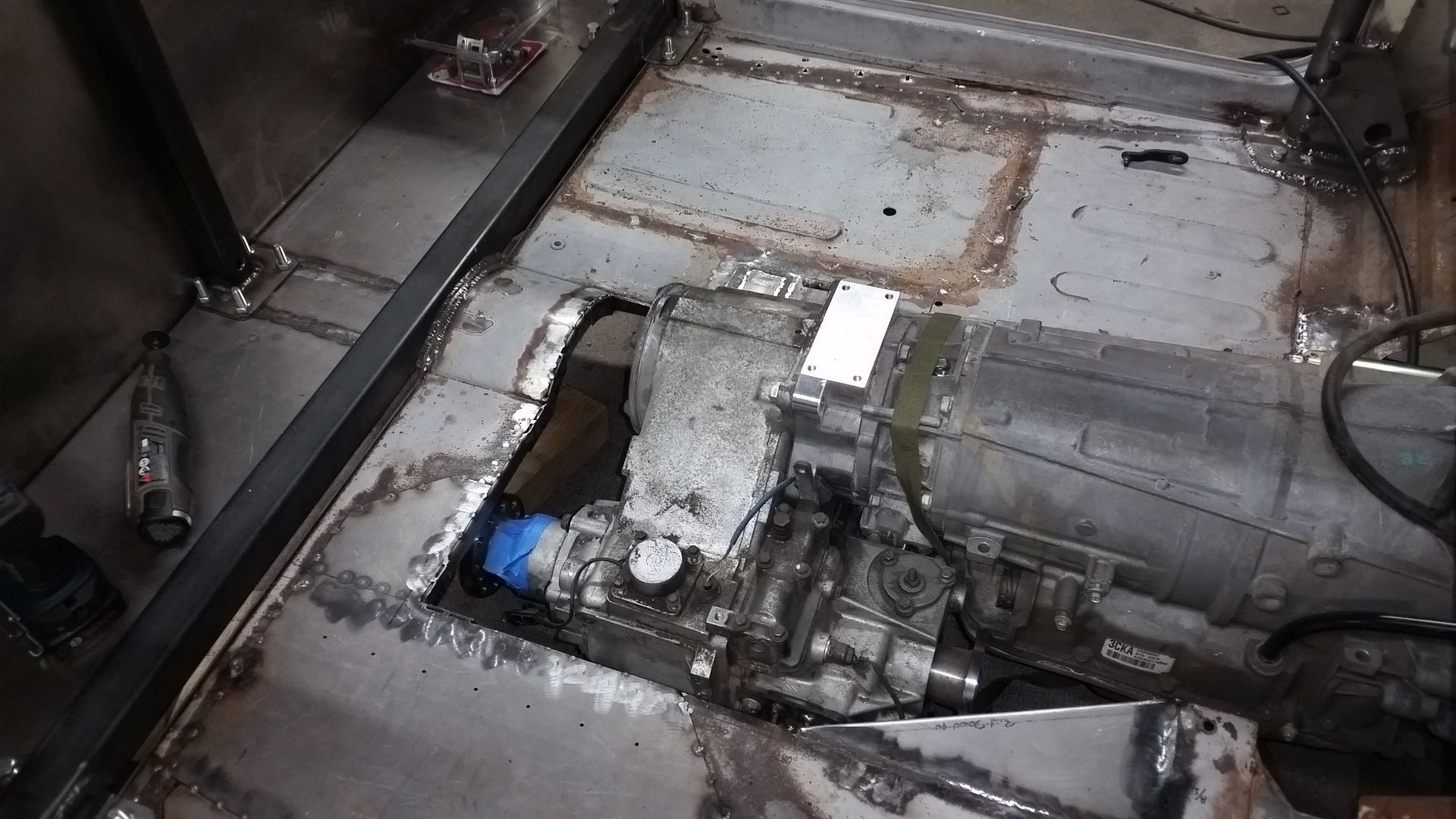

I removed 4" of material behind the transfer case to help with the ability to r&r the transfer case in the vehicle. I also removed the rest of the old 'hump' in the floor....

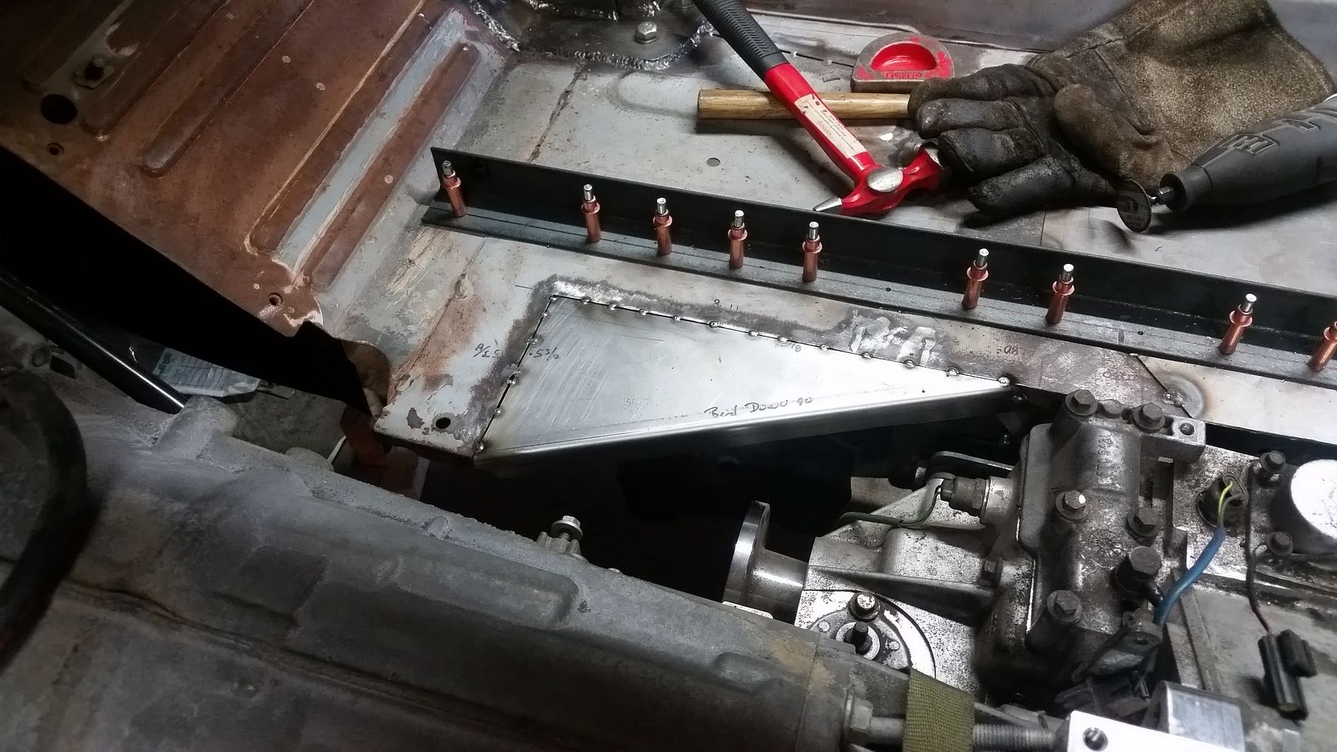

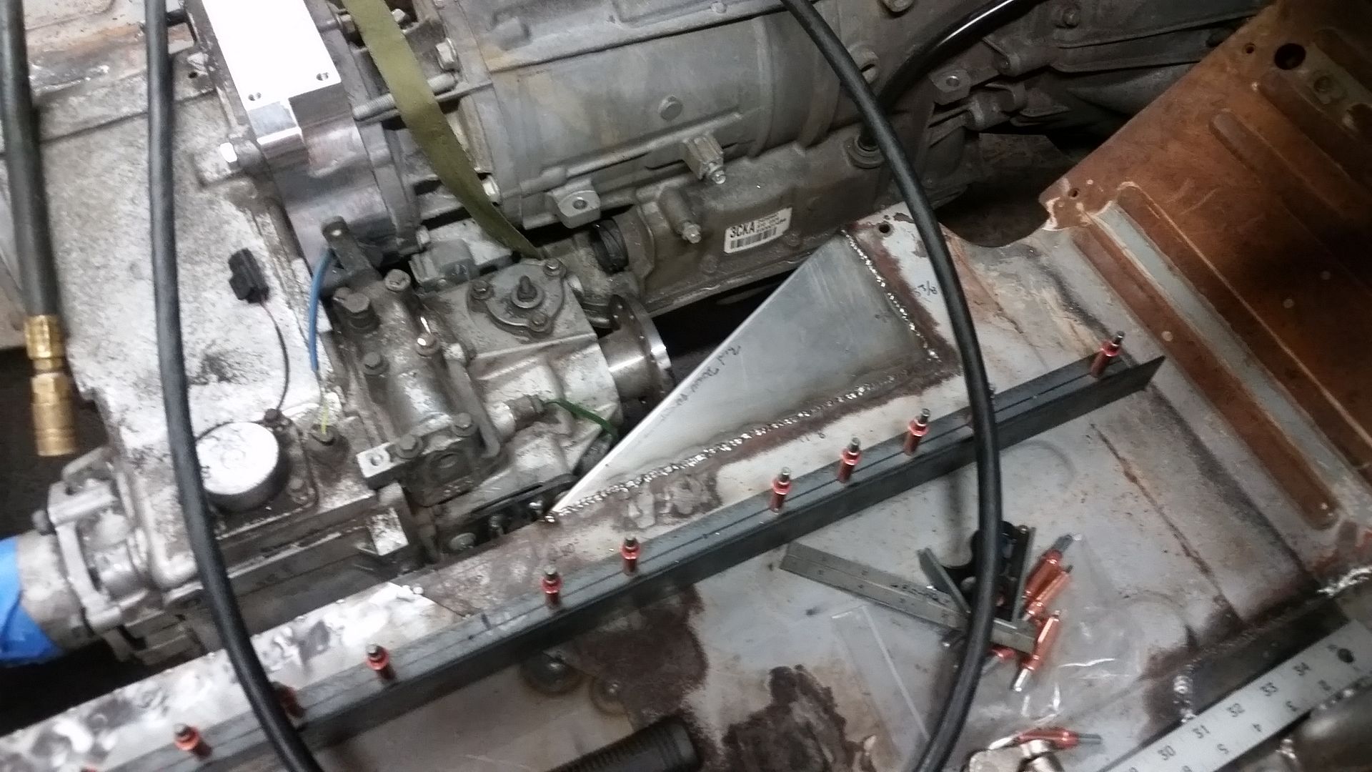

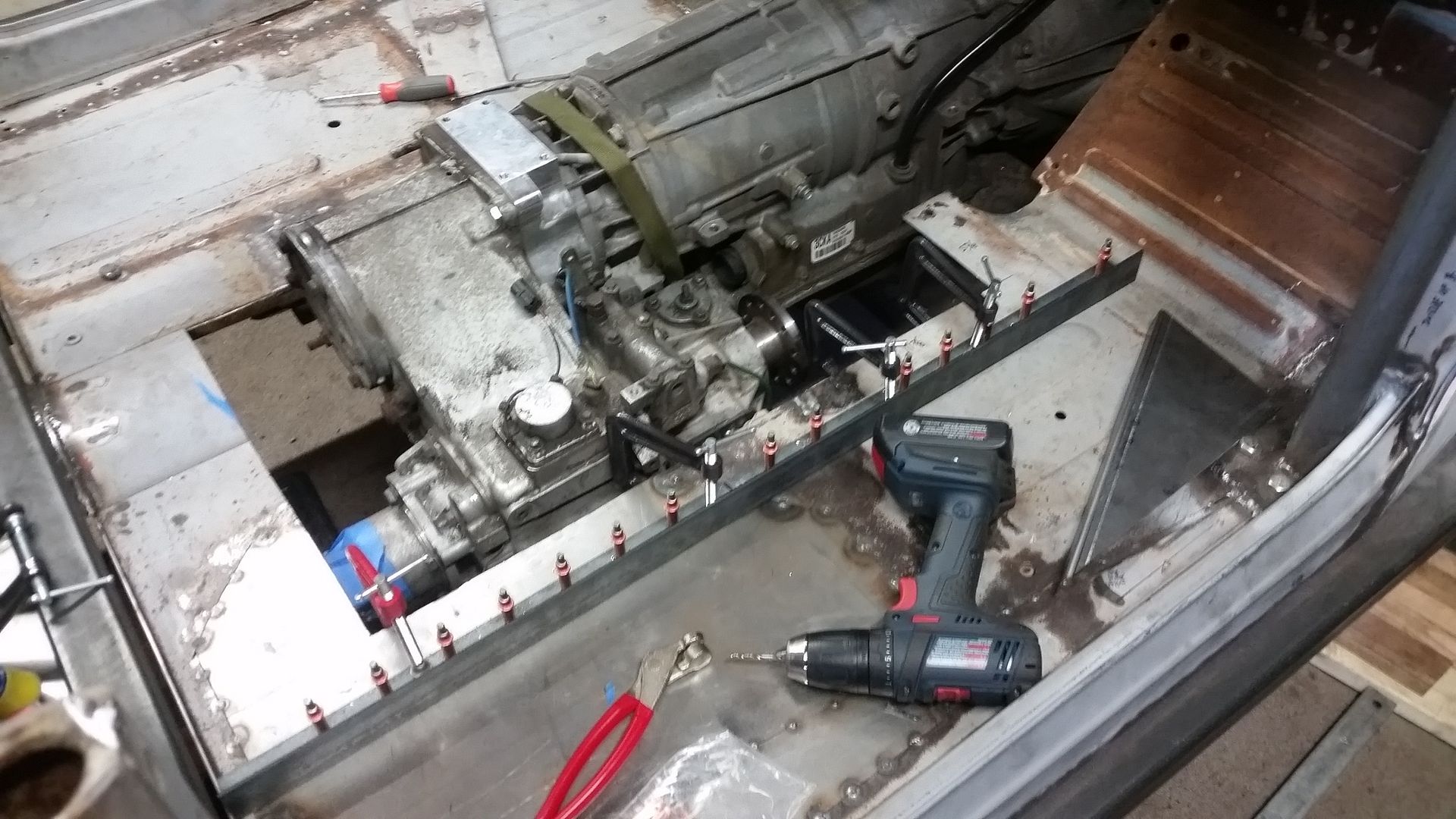

In order to level the floor I decided to use a scrap of angle iron. I could have clamped it, but that would have only gotten in the way. I ended up adding a 2" pattern of 1/8" holes in the angle iron to give me a template to use some Cleco fasteners to hold the floor up level. That worked great! Now the floor is dead level front to back. Note: the missing Cleco's in the pattern are areas where there was an existing conflict with a hat channel.
This is the panel I made to replace the 'hump' in the floor. It has a flange on the edge to provide support to the floor. That flange is welded to the existing flange on the front section....and to the left overs of the hat channel on the other end. This should help firm up the floor a lot on this side.
Same panel from the other side, tacked in place, and the clamps removed.
I am going to try to add a flange around the rest of the perimeter next. I don't think that will be too hard. I will just make some 3/4x3/4 L-flanges in my little press brake and fit them in place. I can even use the shrinker on a piece to fit the little hump in the floor. That should be fun. Use some clamps and/or cleco's to hold them in place. Then plug weld the holes. I think that will work.....
I think I have decided to make the tunnel a removable unit. I will likely split it into a front and rear unit. Then to make as much work as possible I will add some access panels in critical areas....transmission shifter, transfer case shifter, front driveshaft, etc.

Oh yeah, you could flop the passenger side floor around with one hand. I cut a LOT of structure out of that side with all the modifications I have done. I sliced out the fuel tank sump. Then I pie cut the floor. Then I had to cut a big hole for the new transfer case.
The floor on the passenger side needs more structure for sure. Getting a lip back in around the edge should firm things up enough, we will see. The nice thing about the cleco fastener is that I can remove and replace the auxiliary support to test things.

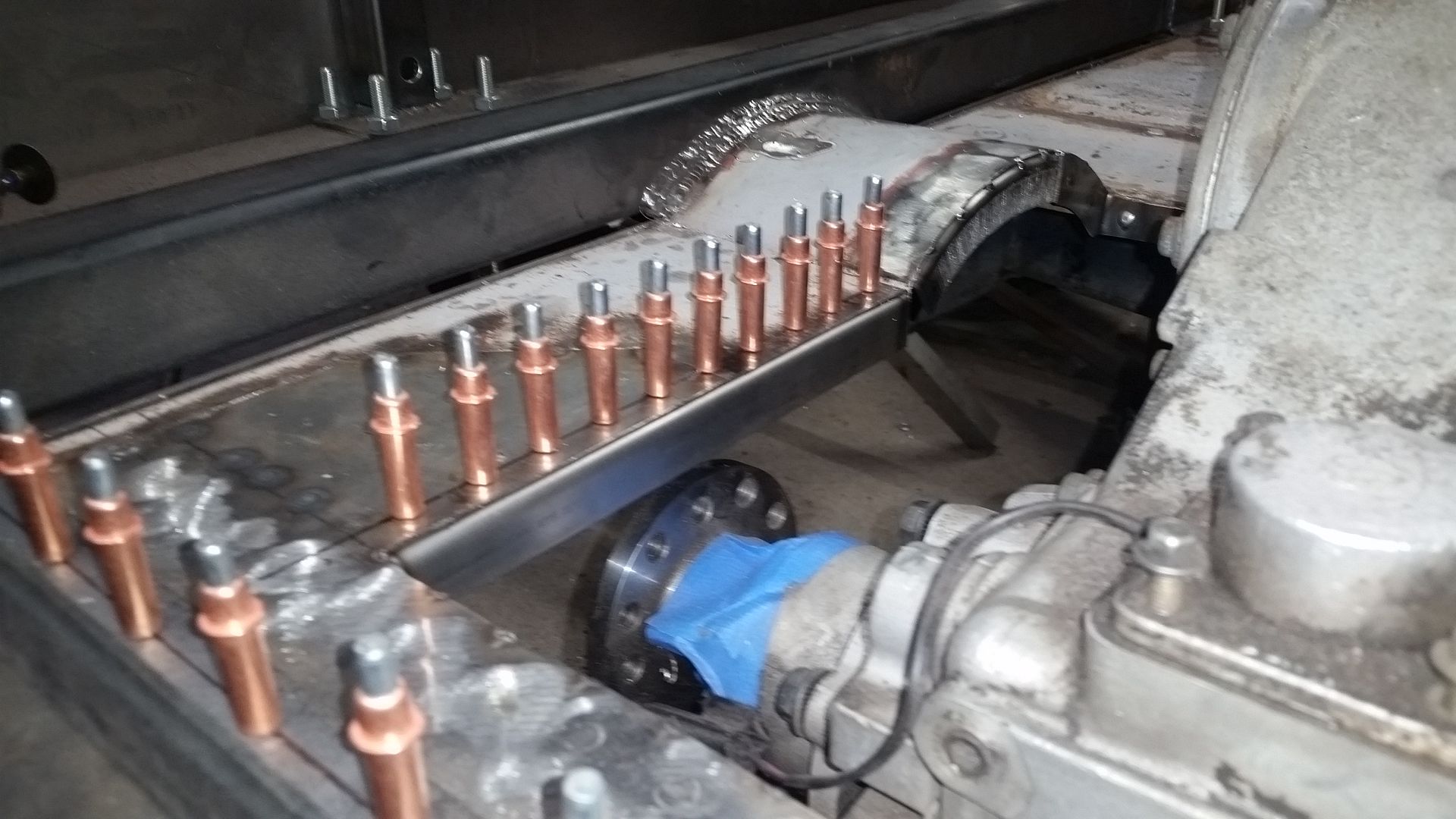

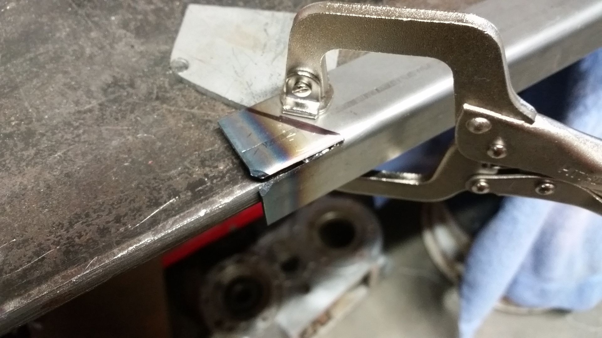

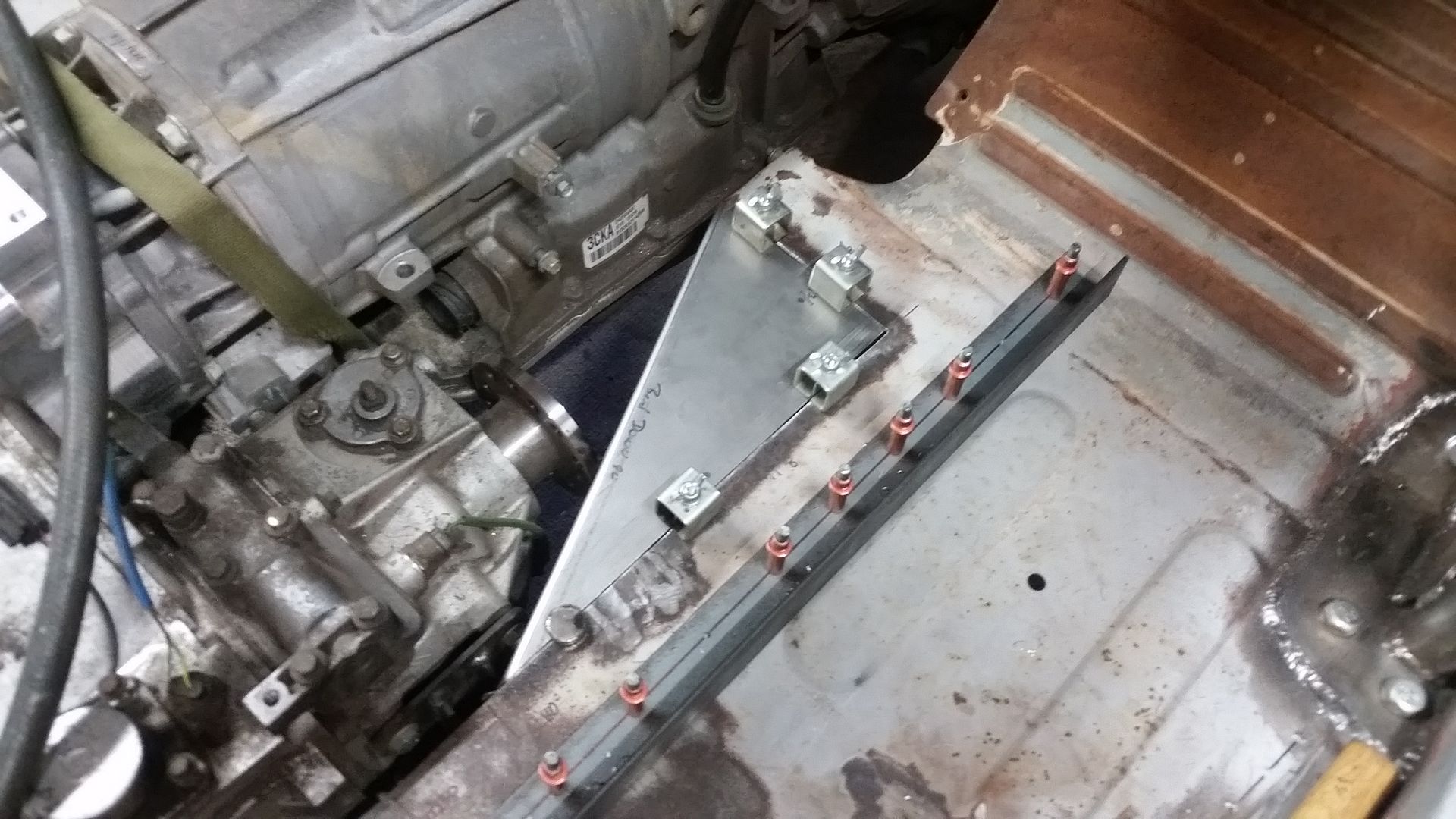

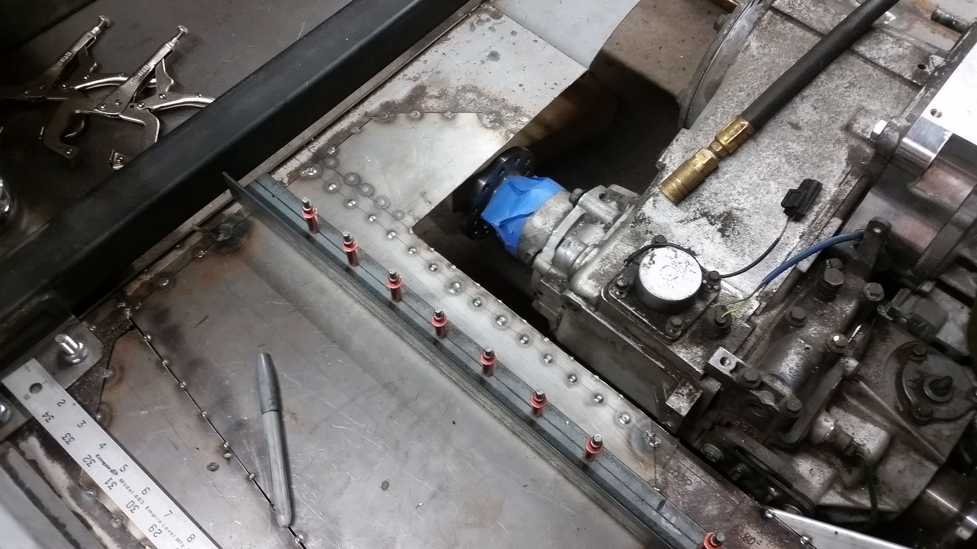

I've been trying to remake a flange around the passenger side of the floor opening. It has been going slow.
I had to make a little 'bump' to go around an existing flange in the floor.....

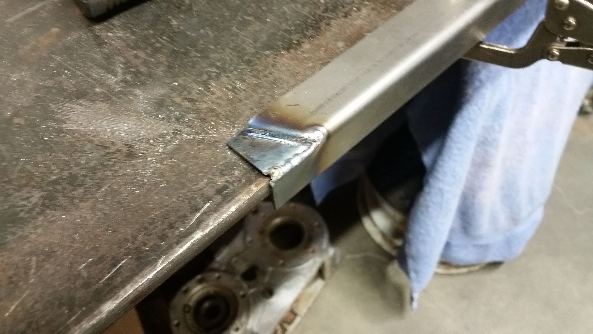

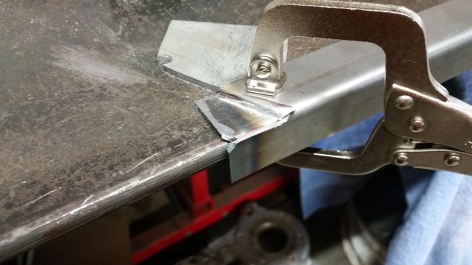

Slice the end clamp in an offset block at the angle you need.
Hammer the flange down to create the clearance you need to get around the flange on the underside of the floor. File down the little bit of overlap at the corner to make the joint look nice.
Tig weld up the seam to make it all one part again.
Install with many plug welds. I did learn that the 1/8" holes for the cleco are not quiet big enough for the weld I would like. I might try going up to 3/16" holes for plug welds like that....or maybe try the TIG with minimum filler. It is nice that an 1/8" hole is easy to weld up however for non-plug weld use like the floor stiffer I am using. Those holes will be easy to fill. I should still probably build a copper backer magnet.....

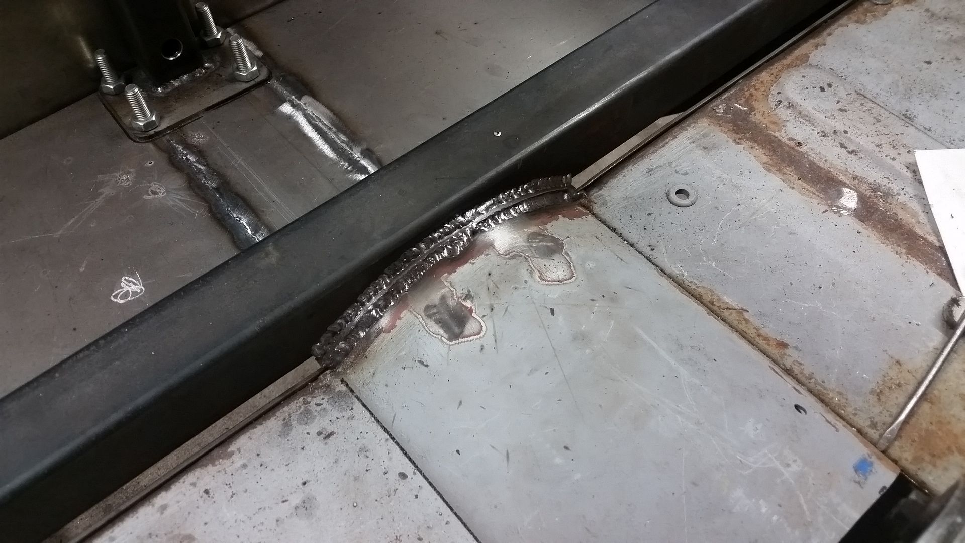

I also got the hump removal plate seams welded up. Fun.
Hopefully tonight I can get the back section done and some little things finished up. My new template material should be here soon. My seats showed up also but I am still waiting on one slider. Transmission shifter should be here soon also. I see this phase of the build with the tunnel, seat mounts, and shifters taking a bit!

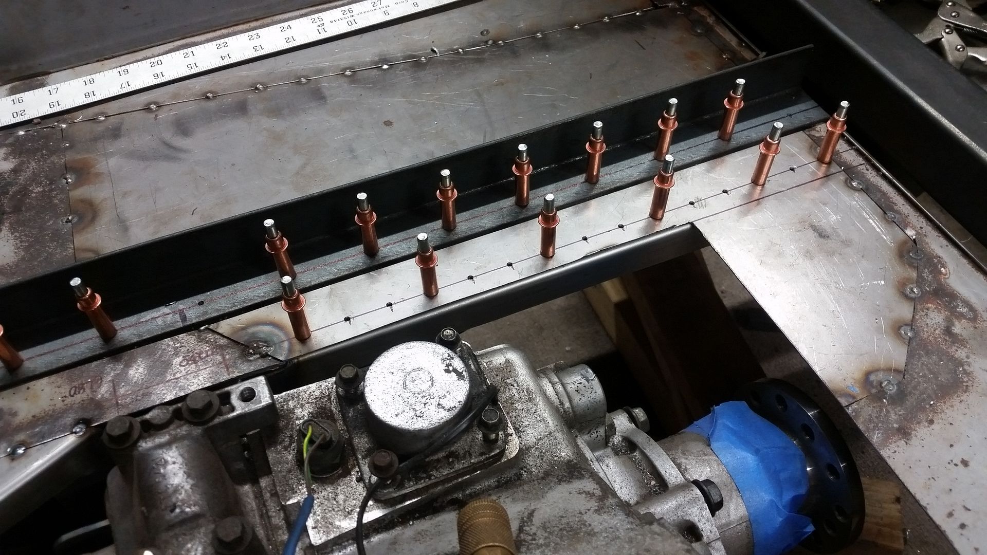

....tunnel construction. I completed the new flange all the way around the edge of the floor opening. The addition of the flange, and the little gussets at the junctions, really firmed up the floor panel. It isn't rock solid, but it is pretty good. I am tempted to stick another small body mount in the middle of the floor to help support things a little more. I think that there was one in that location stock.
Making the little curved flange was fun. I used the shrinker again. It still doesn't like 16 gauge material.
Cleco's are cool. I might be addicted. I did find that with the 1/8" hole for the cleco, I get a lot better weld if I drill out the top panel to 3/16".

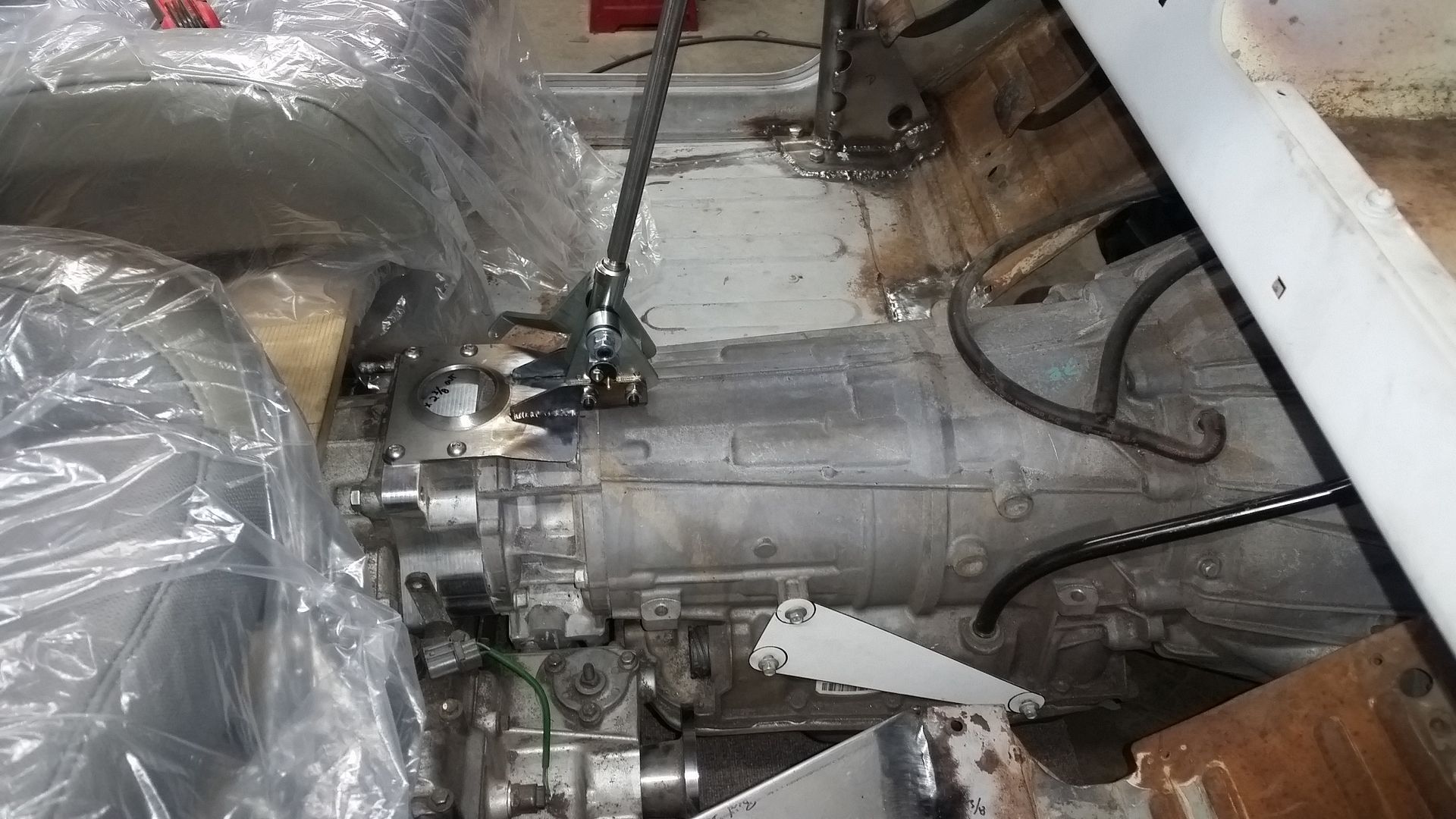

Now I just need to figure out the transmission and transfer case shifters, eliminate the safety thing on the transfer case, and make a wicked tunnel template using this new 'chipboard' stuff I got in the mail. Then turn that into metal....
Just little stuff that seems to big time....
I built a mount for the Gennie shifter mechanism on the top of the transmission. This position seemed to work out well for the possible seating positions. I did a little mock up with the seats to get a better feeling for the cab space. Overall I am pretty happy, but it is still a bit smaller cab. Leg room doesn't seem to be an issue with the slightly taller seating position compared to my flat fender.
The shape of the seats, especially the headrest, does waste a little space. It will work, but it would be better if the head rest had a little forward bend to it.

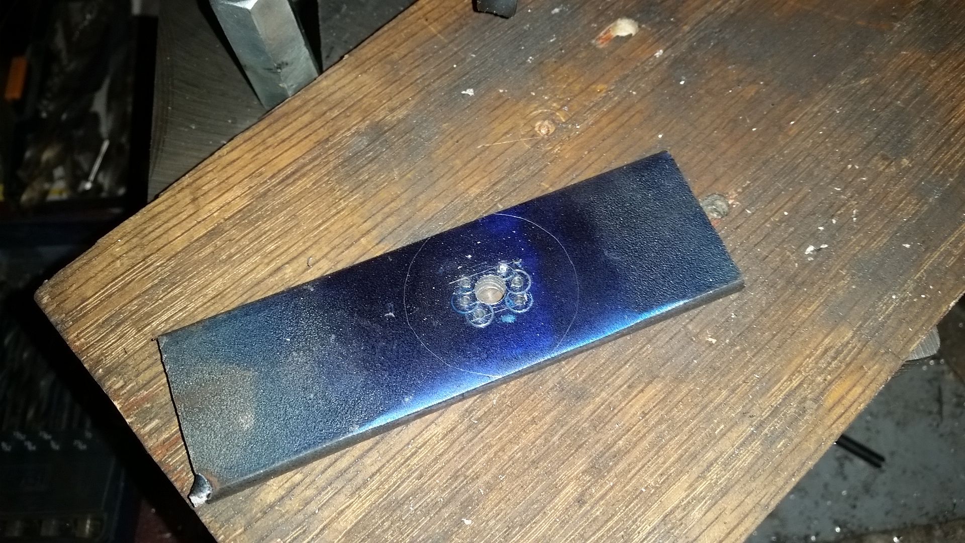

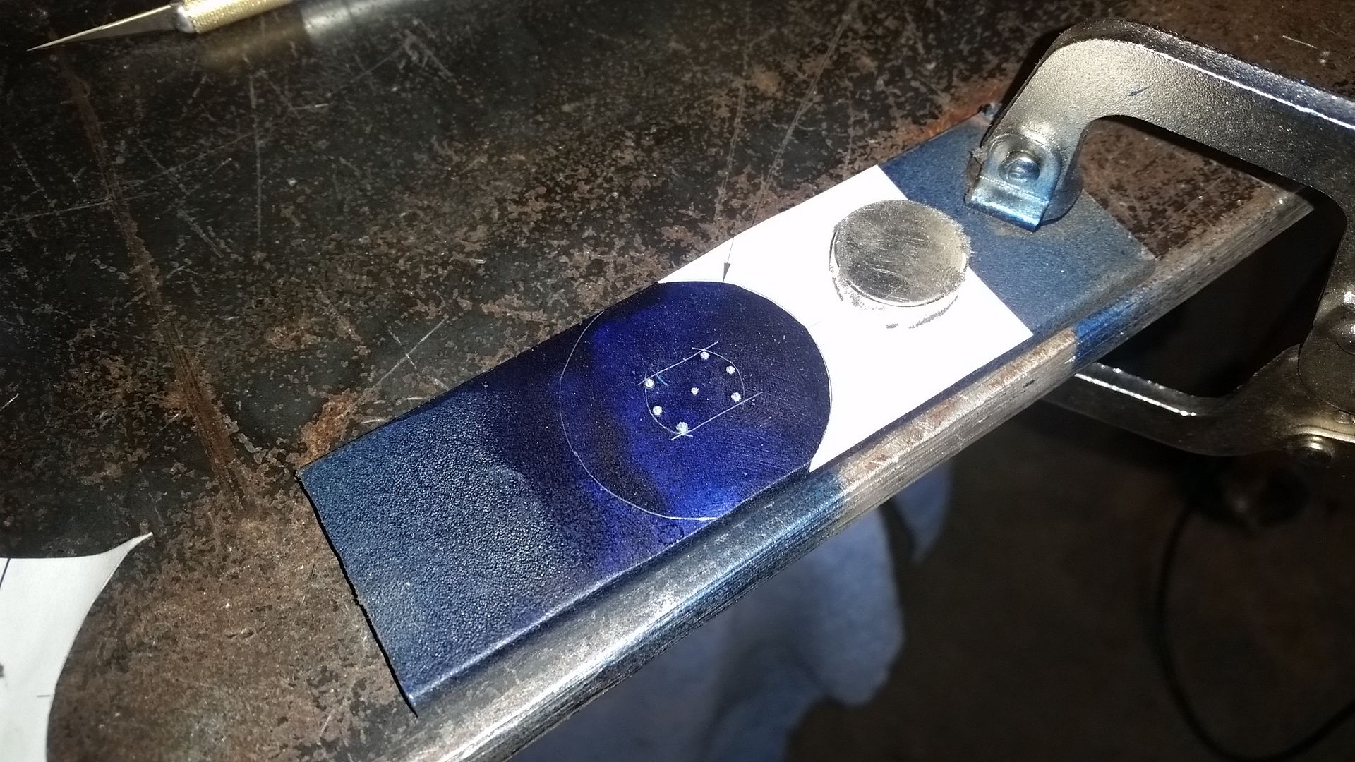

I did make one challenging part today...

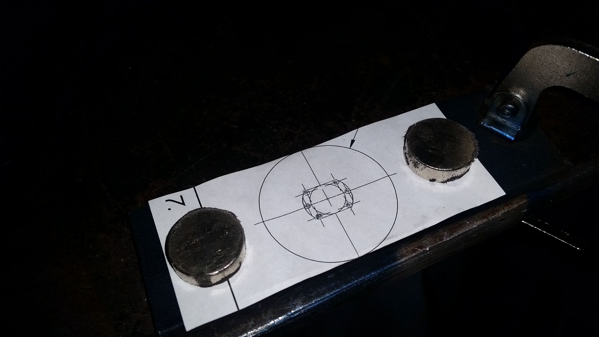

Make a paper template. I use Solidworks, but just about any CAD program will work including a lot of the free ones. Spray the base metal in layout die. Use a few magnets to hold the paper template on top of the steel and layout die.
Center punch all the hold locations using a very sharp center point. This part is pretty small with lots of holes close together that are small in diameter. Take your time.
One the holes are center punched, use a razor knife to mark the lines you need by cutting through the paper. If you work from the inside out the magnets till keep the paper in place. You can work out in layers to the most outside feature you need.

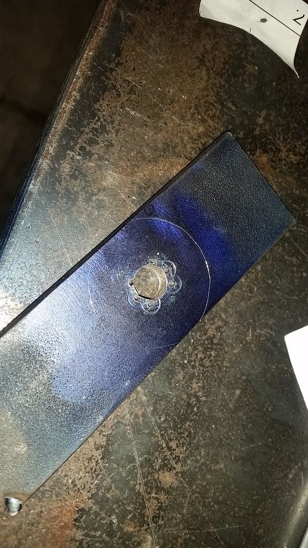

For this part I had a six very small 1/16" holes to define the corners and radii I needed. This part also had a 'flat' area along the middle.
I was able to get close to the final slot width I needed by increasing the center drill size out to 25/64th in a few steps. You don't really want to break through to the other holes if you can help it. One or two isn't a big deal and didn't seem to have an effect on hole center.
Then I just had to break out the files and clean up the features I needed to the line in the layout die. It didn't really take that long to connect all the dots and close in on the final shape.

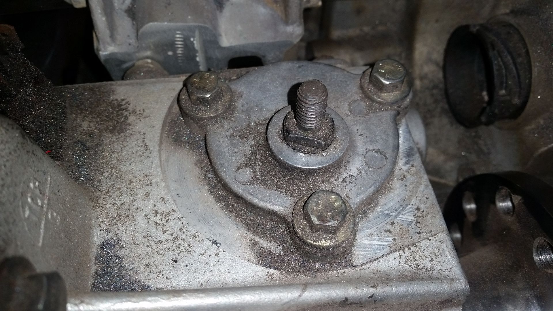

This is the final part....

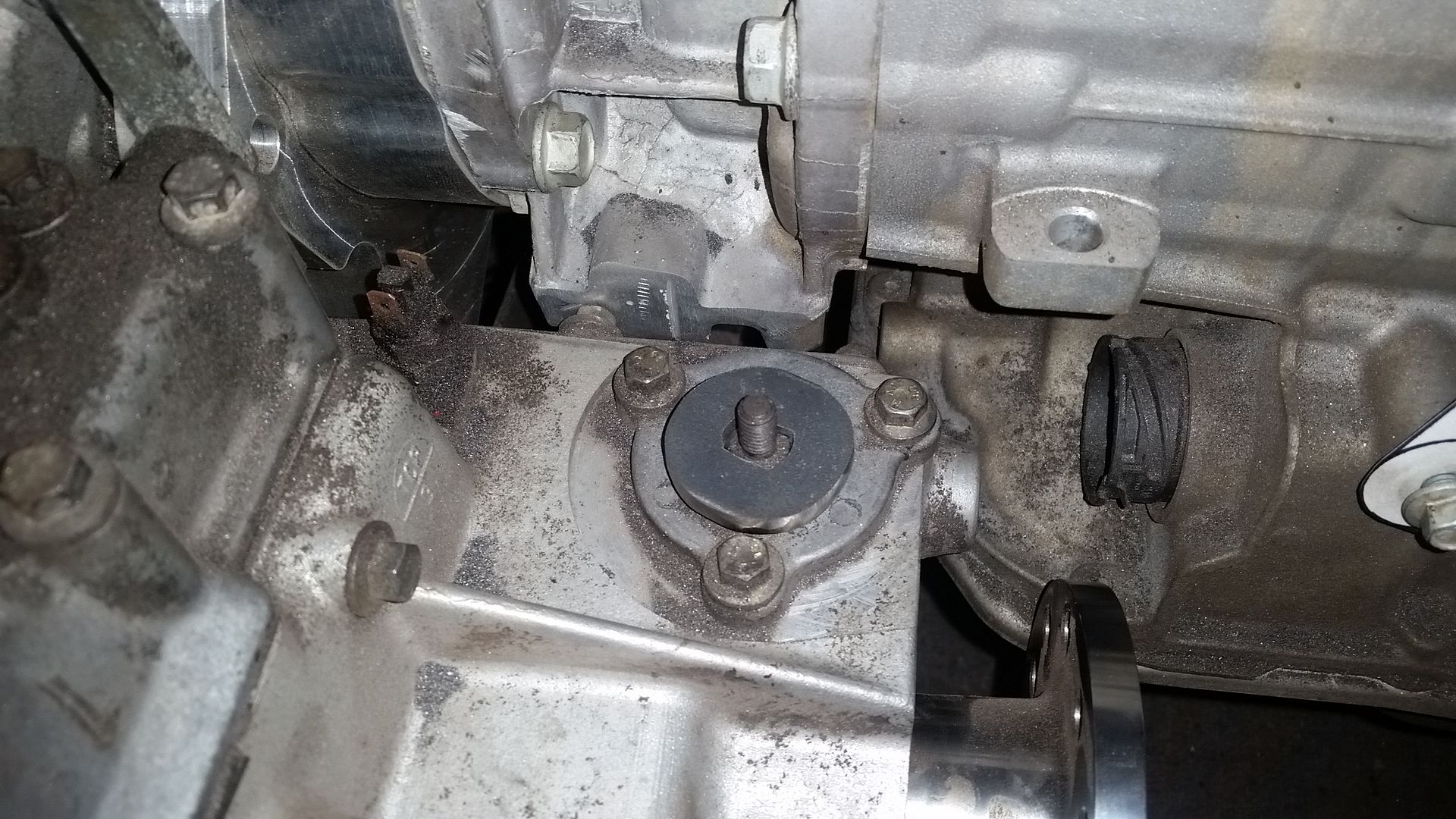

This is what it fits on. This is the center diff lock actuator on the LT230 transfer case. This little part will form the base for the air shift mechanism I am going to build for that.
