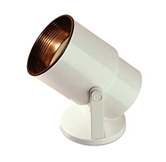

I also installed two extra lights: they started life as cheap "accent lights" from Lowes. I bolted them to the cabinet and put low heat LED bulbs in them. One is in between the gloves pointed away from the operator. The other is opposite pointed towards me and down.
HUGE improvement at the cost of less room inside.
