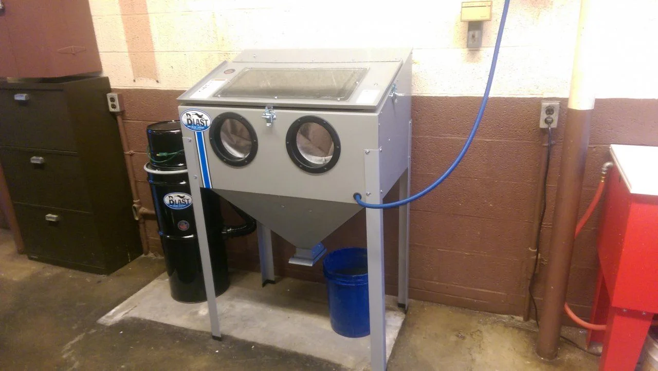

Finally tried this thing out tonight on a few parts, it works AWESOME. Soooo much better than that little benchtop model I had before (which I'm trying to sell on CL now).
It was a B-I-T-C-H to put together, getting that big plastic "cone" piece down inside the cabinet. Had to take the gloves off and half of the legs (after I had just put them on... grrrrr... :bang:). Then it's just a matter of dumping in the media, hook up the air to ~70 psi, go for it. I won't run it without wearing a respirator, even though I have the vacuum collector attached. Now that it's hooked up and working, I'm gonna run some hard line and mount a water separator to the side. Might get the foot pedal kit too.
Thanks for the help gents, good advice as usual. :beer:

The light kinda sucks, honestly. That's another thing I need to address. It's a single socket that takes a PAR20 spotlight, but those bulbs are not very durable. I bumped it while blasting and POOF that bulb was done. Might try to find some LED spots.
The vac unit is much quieter than a ShopVac, so it's worth the expense just for that.
You are right about the LED spotlights. I mounted two extra lights in mine: one is right in between the rubber gloves. Makes a huge difference but they take up space, I cut away most of the lamp holder so in a pinch I can unscrew the bulb to gain space.
I also bought a used foot pedal that was old but made in USA. I just disabled the trigger and kept the same gun. This is also a great upgrade.
A foot pedal is worth the coin , using mine with the trigger Scat gun is pretty hard on my old hands for sure . Look into some flush mount leds , it will make some holes in the cabinet but for the most part they should hold up . I'd recommend using some protective film so the lenses don't get destroyed by the media flying around since they will outlast any regular light bulb . I just run 2 of the adjustable angle spotlight fixtures in the rear corners and one up front between the gloves . Most times still using a high power led head band light since I'm pretty much half blind now , but it works . I just use the rough service bulbs and they hold up pretty well .
One word of advice - learn to blast your parts away from the viewing window - or you'll go through a lot of replacements . I adapted my frame a bit since Snap-On wanted nearly $50/each for new ones . I'm just using double strength hardware glass sheets cut to size - two at a time cost me $12 , good enough .
Make sure to rotate your nozzle every couple hours of run time , change air jet every other nozzle as it will keep from wearing the gun body and make it work more efficiently . I love the tungsten nozzle kit , so nice not to wear them out so quickly .
