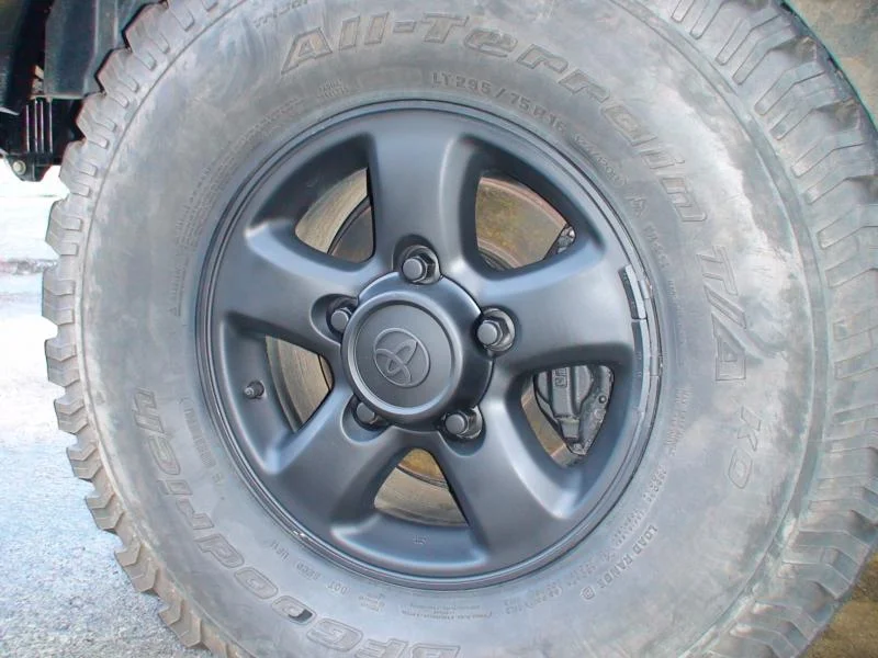

Self gratuitous picture to explain why I'm posting this question.
They sell black caps at Autozone. Not sure how long they will stay on since they looked cheesy. I painted mine with spray paint when I touched up my rims (didn't pull the rims off). I have removed the tires to rotate them, had a shop removed them to balance and so far just a smidgen of paint has been removed. you could always tape off your rims and spray them. I wouldn't want to get spray paint on the powdercoat, its to nice to have spray paint all over them
pic from the "ghetto rim" thread lol

I obviously was thinking about just rattle can them. However I was worried about how well it would stick over the chrome. Guess I could sand them some to rough it up first.
Hmmmmm...what about having the lugs sand blasted first, then rattle can.
I'm really trying to avoid something that will start to chip and look cheap and then have to be "touched up" constantly. Hence the reason I paid for my wheels to be powdercoated vs. most who just rattle can them.
Since you painted the lugs while the wheels were mounted, have you since taken the lugs on/off? Does the lug nut wrench chip the paint while removing?
once to rotate, and another to have them balance. Both times had a impact wrench on them. Some paint came off (around the edges, thin line) but not enough to really make a difference or need to resprayed.
