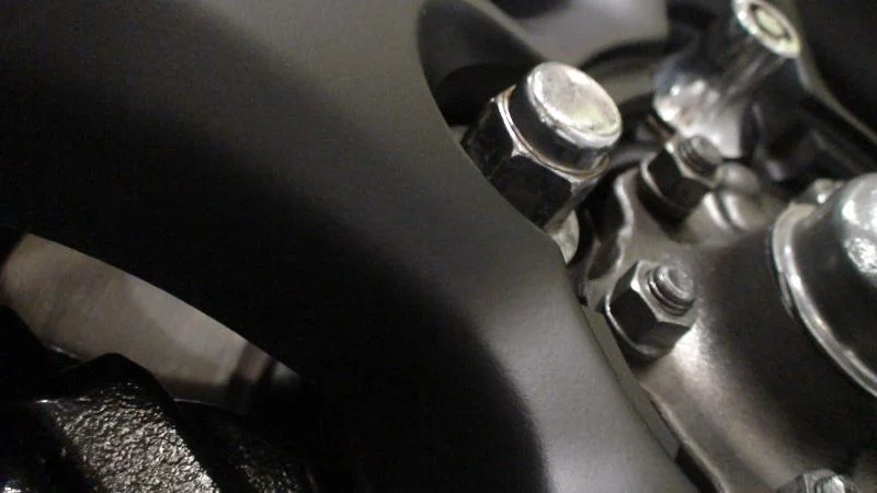

some pics of when they were fresh
attachment.php
attachment.php
pssh, you never looked at either of my sets? ;p
no i have not. until i do, Anthony. L is el primo black wheels dude.

So, it's moot point, cause those lugs don't work. I will take some pics later, but the short story is the design of the OEM lug has a cone at the end, then a shoulder, and finally a flat washer surface. The gorilla plus just have the cone surface. While they will physically install, I'm not really comfortable supporting all the weight on just the cone surface when it's pretty clear Toyota designed the shoulder and washer portion of the lugs for a good reason.
That really sucks, but apparently Gorilla thinks Toyota had good reason as wheel
