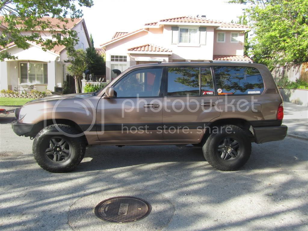

Got those wheels from a wheel shop in Costa Mesa CA for $65 each with 0 offset (4.5" backspacing) therefore I don't need to use any spacer for those 315/75-16 KM's
I used Plasti Dip on all of the emblems and trims, the best thing of using this stuff is you don't even have to take off the emblems, just tape it about 1" around the emblems or trims and spray it 2-3 times, wait for 30 minutes then use a toothpick to peel off the excessive around the emblems and trims....than you're done !
Btw, all the rear emblems was done by my 12 years old son, which show some imperfection. But my point is if my son can do it, any body can......

From the first picture, they kind of look like 6 lugs? Do you have more pictures and specs on them?
They are 16x8 with a 5x150 bolt pattern (4.5" back spacing) made by MST. Got them from www.signatureptw.com
