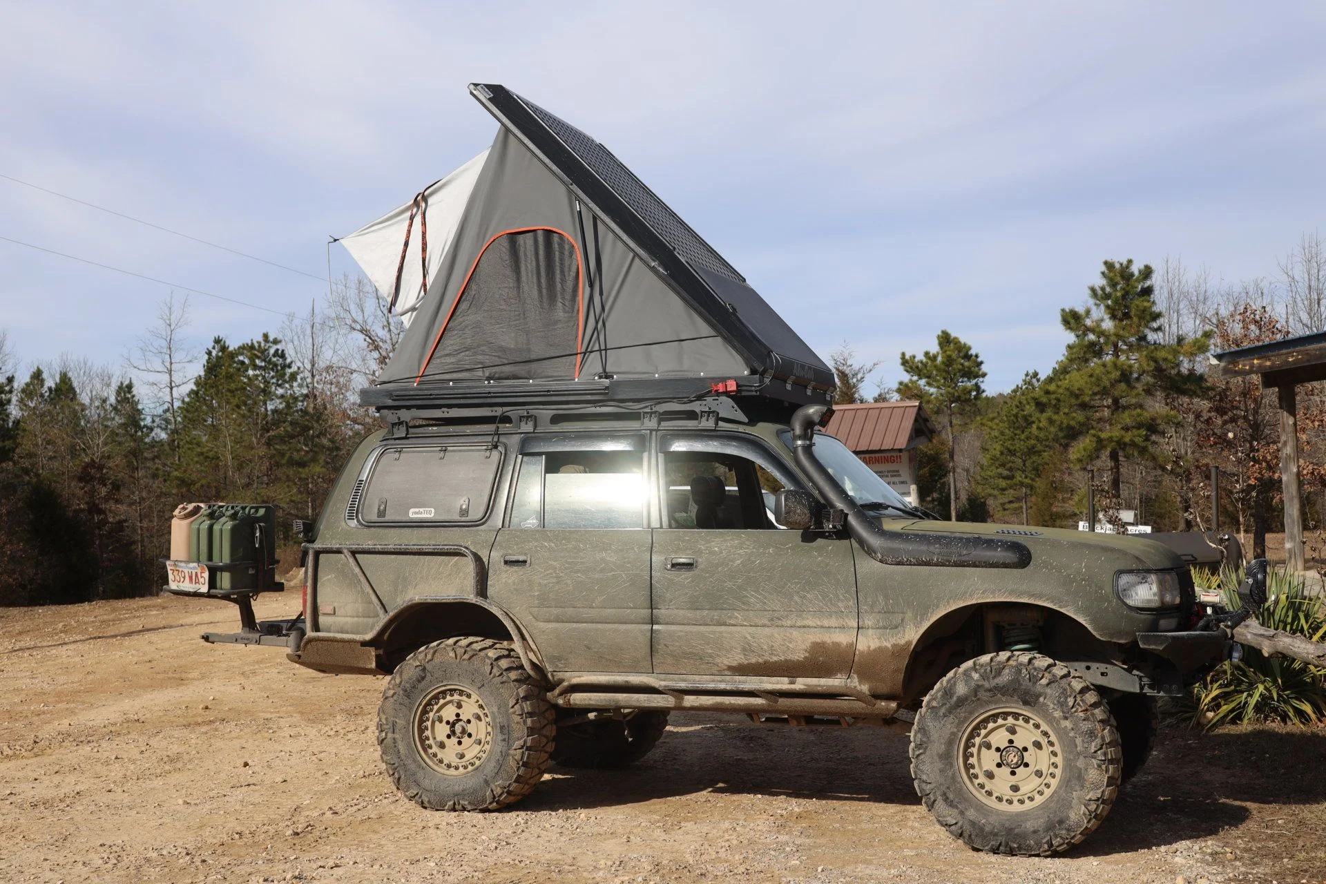

the armory rim went right on my 80 no probs. only downfall is they are so deep cant see lug nuts and it covers entire front hubs.
