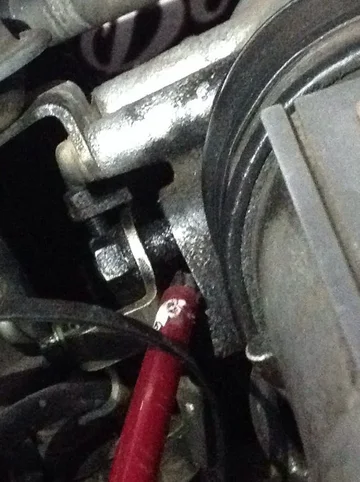

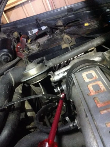

I can;t see any spring on mine, but I do have a oil vapour issue from the PCV to intake, I will be fitting an oil seperator to try and fix it, provent diesel spec catch can looks like the go from what I have been reading. if you can post a photo from a little further back to identify it a bit better.
Yeah, I've considered catch can as well, if you follow srew driver you can see where I thought a spring would be
Just above screwdriver the misty bolt, should there be a spring in the middle ?? Thanks for checking

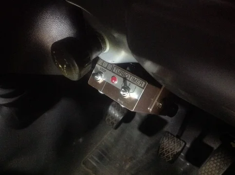

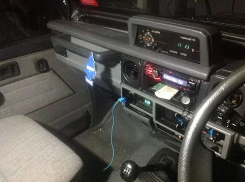

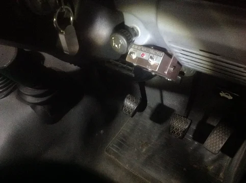

A couple pics of the latest additions to Oldtoy, the dash pod and turbo timer, all fun and learnt from it as well,

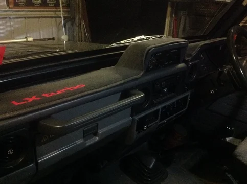

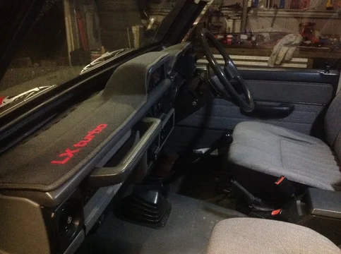

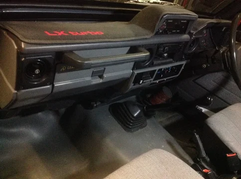

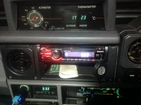

Today I got my dash mat delivered for my new dash set up, I found a place where they can personalise dash matt if required, so I bit the bullet and tried something, what do you think,?
Very nice. I like that extra instrument pod as well.
Looks so much better that the lime green shag carpet is see on some of the cars around home. ( the cars with the spinner rims). : )
I bet your airplane has a custom dash mat.....:grinpimp:

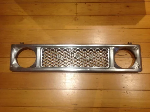

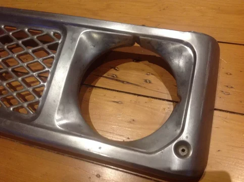

Project grille is underway, managed to get a bj73 grille black in colour and which I had to remove paint and clean up getting ready for chroming.
As OE bj74 grilles came with blacked centre and chromed frame, and that's what I'm trying to attempt, my concern is that the process of painting over chrome, as the the whole grille will be plated , and I need to paint over centre, anyone had experience with painting over chrome, I hear etching prep is the way to go, but then I have heard it's not either , so a little confused?
It going to be horrible of a job to scratch up the chrome within the centre to prep to ensure the primer or etch actually sticks to the chrome,

Black nickel plating would make a good choice. It's as tough as chromium, plates up the same way, just a little different chemistry. I've used instruments and equipment plated this way, it stands up well, corrosion, abrasion and wear are similar. Hell, I think the nickel (nickel ammonium sulfate) comes from QLD.

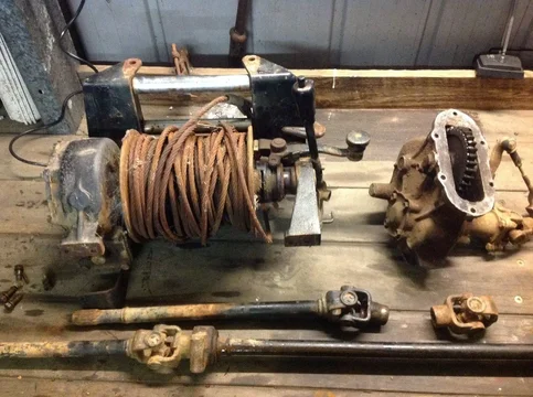

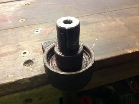

The latest addition to the to do list is a pto that's needs cleaning up, got one from 60s, so drive shafts will need to be corrected to right lengths, so for now I'm just breaking down to clean up.

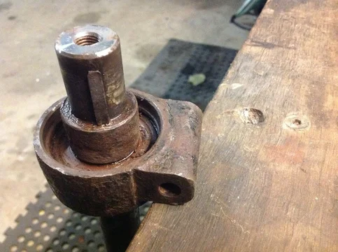

I've taken of one end off the shaft to remove the pillow block as the bearings are shot, but Ive hit a brick wall, the woodruff key and sleeve behind it, how do I get the key out and that the sleeve, but on FSM the sleeve is not identified, or is not a sleeve?

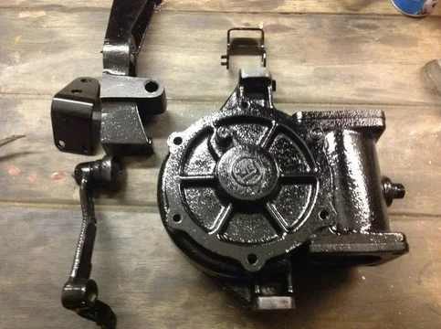

image.webpimage.webp image.webp image.webp Update; stripped / ripped down pto and have all new seals and bearings ready to be installed, I have given the the pto it's first coat, after having it sandblasted as the internals was rusted out as no oil had been in for quite some time.
Just want to know get the thoughts of others regarding whether to coat the internal pto case, I'm a little concerned because I sandblasted inside case to remove rust and build up of crud, should I look to coat inside the case with a specific product as well to ensure rust does not return,......yes I know oil is in the lower worm drive, but will the splash basically coat the rest of the case?

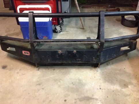

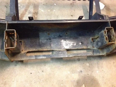

Snaps of the bullbar I have found to do up that has enough room and depth to install the pto, a little fab may be required but should not be a real issue
