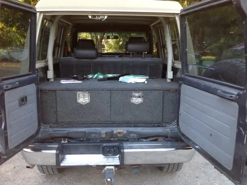

I thought I'd better get my pic's up, as I have been reading, posting, asking and learning, so here is my JDM recently purchased, as I sold one 8 years ago, and regretted ever since. I looked at importing straight from jap auction, I came across 2 in 6 months, missed out on 1 and chickened out on the other, then found a goody in Melbourne imported 05 for senior citizen, 87 bj74, 24 volt, 32" AT rubber, 260k on clock, 13bt/ h55f, suspension seats, standard electrics, ac ps, widows,mirrors, etc , ugly bullbar, spotties, no leaks, my concrete in garage is still clean, storage draws, roll bar, front carpet removed and HD vinyl inserted, all internal body has been sprayed with lead base deadner, Factory24v12 v converter, for stereo, and great stereo plenty of clear loud sound if needed, red arc trailer 24/12v set up, rhino roof racks directly attached through FRP, no signs of leaks in roof lining, overhead console, UHF, here is the option ol mate fitted but I'm still unsure yet whether I will keep on, 4 x airbag suspension activated via remote control, 4 buttons 1 for each bag, dual air compressor in rear, 24v powered split down to 12 v,

Those rear storage compartments are very nice looking! As is the roll bar. Very nice!
Very nice.....
Your security system ( Rusty ) looks very efficient. :)
Hey nice looking rig bro! Your right, that bull bar IS ugly, but it would be a beauty in a header with a tree!
I like the drawers in the back too, might have to do something like that myself.
I actually like the brush bar ( I would like it better, powder coated black ) but I like
it.
