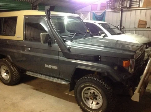

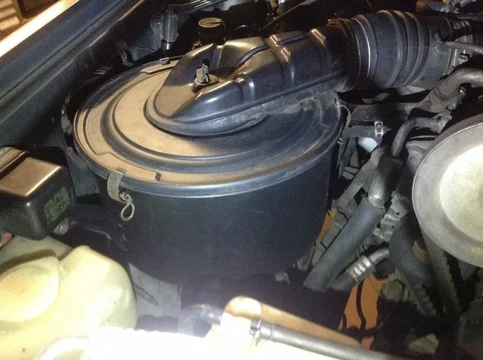

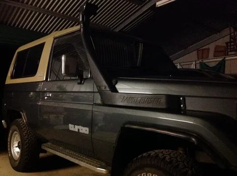

Slowly picked 2nd hand OEM snorkel, snorkel airbox, & fittings, the airbox was a tad rusty and in poor condition, so I got that sandblasted, and coated matt black, ........the idea of cutting hole in my cruiser was daunting considering I had no template to work with and the hole needed to be a rectangle, wasn't keen on grinder, so I used a nibbler it worked great.

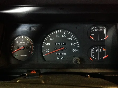

Other task was to get oil receiver working after replacing sender a while back, got that sorted through auto instrument shop, as amayama indicated it was no longer available, which I find hard to believe, all working now very happy, ol mate told me that when senders pop it surges the receiver and burns them out, which was evident when I pulled out cluster and had closer look, you can also see in pic the cluster glass has battle scars when receiver burnt out, near 32v .

Put on an OEM bonnet protector, toyota decal not landcruiser, I believe the landcruiser ones are for the later models, I could be wrong, ??

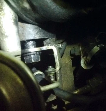

May I request to see if others can check their 13bt's to see if there is a spring between the intake butterfly housing( I doubt its called that) and lever to actuator, I have plenty of oil mist exiting from this area, and from previous readings there looks like there should be a spring closing this leak, as there is some play ( back and forth ) and thinking a pressure spring would close the leak/gap within the butterfly axle/ lever and reduce mist and increase air pressure flow,
image.webp Not sure if a spring should be there or not, if someone can check much appreciated! and also comment on the amount mist is exiting there, cheers guys
