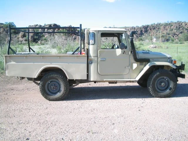

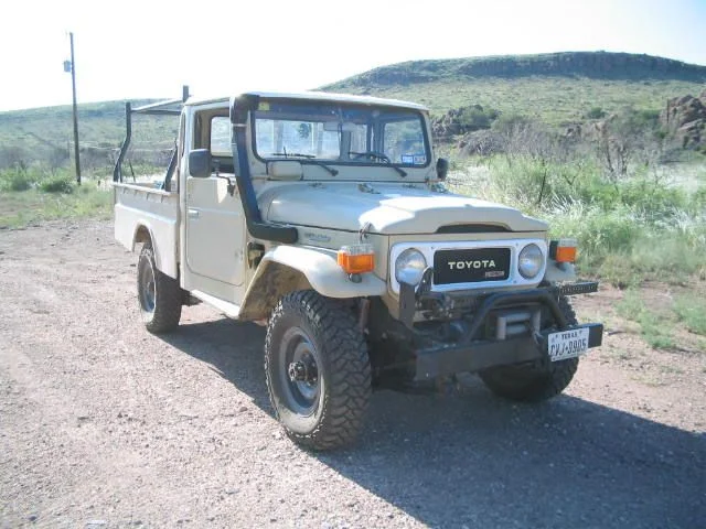

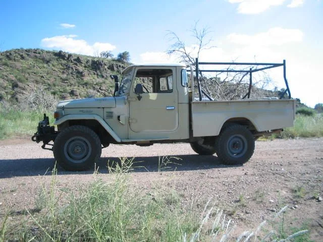

I'm driving an 84 Euro spec BJ45 and understand your concerns. The 3B is an awesome reliable engine but they are underpowered by todays standards, especially at elevation. I live at 5000" ASL and after a few months added a turbo to help maintain speed and pull hills more efficiently. I used one of Diesel42's kits and was amazed at the increase in power. His kit is more complete and better tuned to the 3B then the others available and is over 1000$ less, it was a nobrainer for me. I did run into some heating issues climbing long hills in the summer(running 210F or slightly over) after adding the turbo but remedied the problem by converting the clutch fan to a solid state fan. I've always thought a 1hz 0r pz would be an awesome up grade but am completely happy with my 3B-T.
Cheers,
Colby
Thanks, I will look into that kit. That set up looks great! From an idiot with engine stuff, how costly was it to switch the fan stuff?
It wasn't hard or expensive at all. I disassembled the fan clutch housing and machined three .250 holes and pressed in roll pins but there are numerous ways it could be done, the easiest of which would be welding or filling the clutch housing with devcon, jb weld or accuraglass. For a test prior to making it permanent I wrapped wire around the blades and fixed them to the shaft with a hose clamp. When time allows I plan to machine a classy new shaft and mounting bracket out of aluminum to reduce weight.
