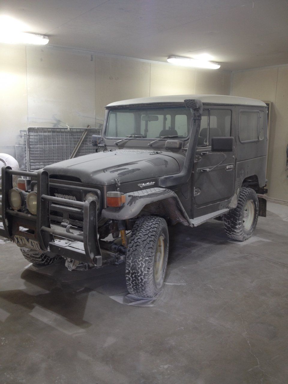

well so far got brackets & front bumper, now stripping front bumper of all the old coats of paint (joy) & doing the rust thing:confused: Hopefully my mates are still in to re assemble in 2 weeks as should have the old girl painted by then, after that:steer: till I wear the tyres out. :)

Ok have the front bumper sorted, spent all yesterday afternoon stripping silicone from door jams ready to prime which doing this afternoon, then on to the bonnet & everything else in primer for a big sanding session tomorrow to Top coat:) "Tired now think I'll go home" Forest gump knew what he was talking about.

Well PO had used a nightmare combo of checkerplate with rivets & siliconeo_O Suprise! He used it in the back tub, guards, front bonnet, & footwells:bang: spent many hours removing silicone & grinding rivets back. All gone now:) had to cut out floor plates & reweld new in with 150mm overlap, was surprised that this was the only really bad area for rust. Have used sound deadning in the footwells & will re vinyl the floor when money becomes available ( Christmas bleeding me dry :santa:) Hope everybody has good Christmas & gets to enjoy a break Cheers

Well she's on the road, still a heap to fiddle around with, seats are mint:) Started putting deadner around the back, installed newly painted bezel, and air con in a few weeks (looking forward to that one) been over 30 degrees C here a lot. Re tapped all the bolt threads & replaced with new bolts, roof rack coming up. All in all pretty pleased with the progress. will get more done & update progress & failureso_O bound to happen. Cheers
