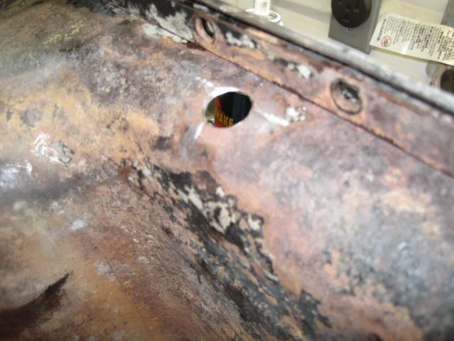

the frame has rot so we will need to concentrate there.

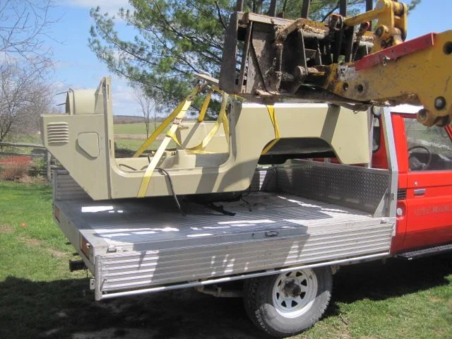

i didn't get any pics of the complete truck and the doors, hood, hardtop sides etc were already dropped at Mike Gozzards shop for him to work his magic.
so the pics start after we brought the tub back home to be removed...
<if the owner wants he can post up pics of the truck as it showed up here>

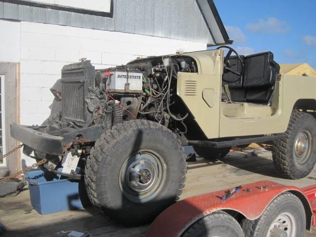

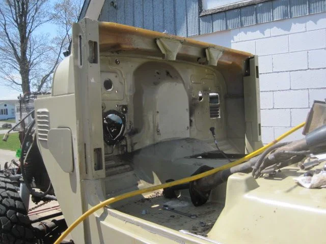

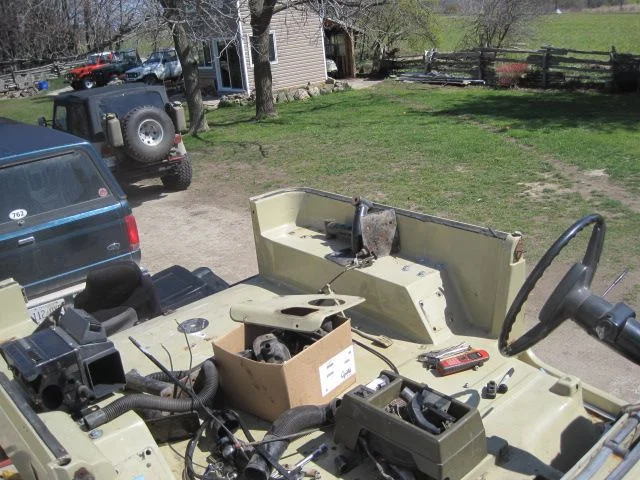

removal of the dash cover
removal of the items below
loaded and ready for shippng back to Gozzard

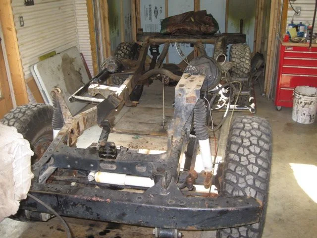

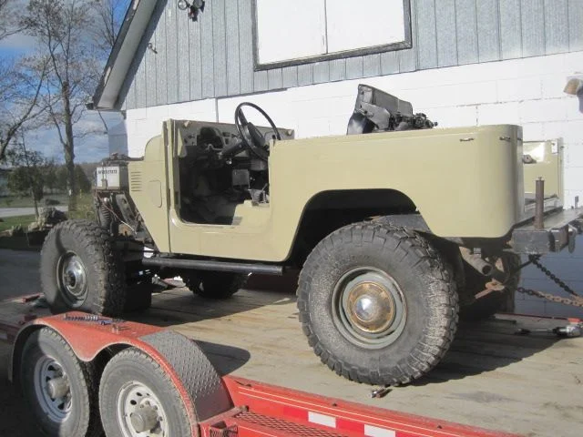

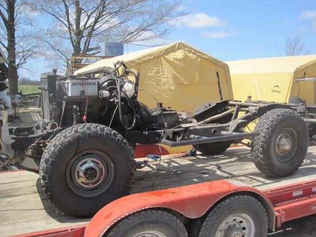

the bare chassis to be stripped

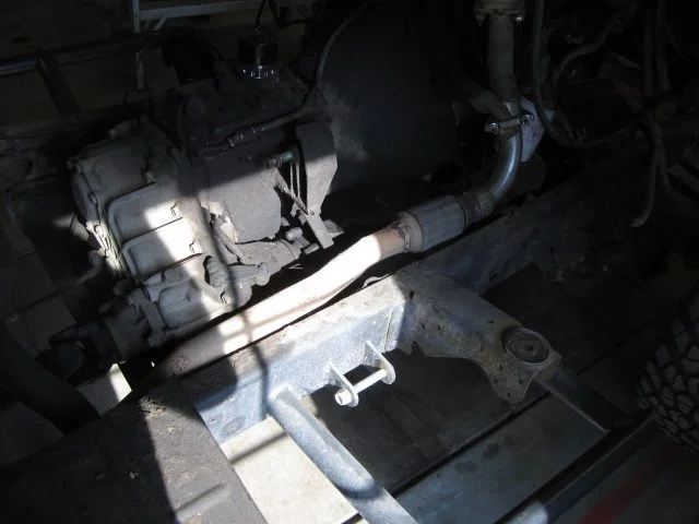

the stockish exhaust system to be removed

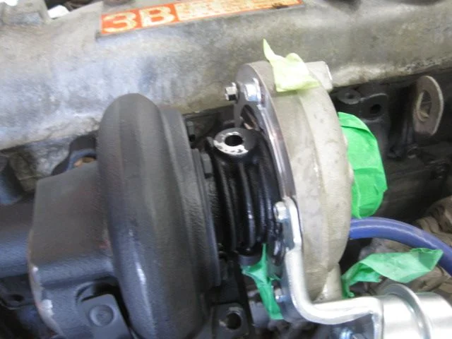

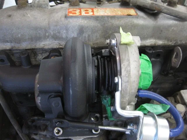

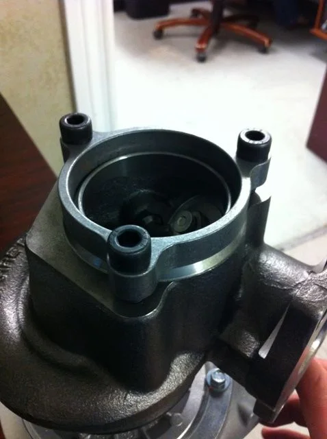

test fitting the turbo
oil passages need clocking
the clocked center section
one of the more frustrating parts of the kit was the missing exhaust flange ... if you live in the rurals trying to find the proper fitting adapter is difficult to say the least.
for the $10 piece it would be a nice addition to the kit. once we found one that was close we still needed to ream it out to fit over the 3.5" ehaust stub.

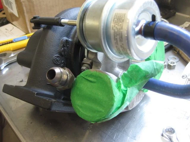

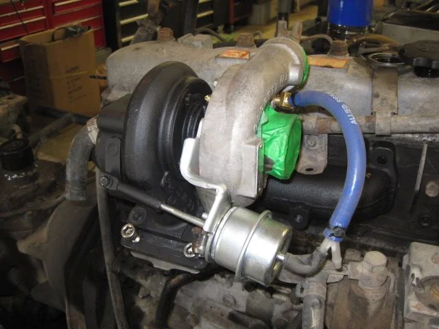

the inlet now needed clocking
you can see once the inlet is clocked correctly the waste gate hose is now too short...
i added a 45 to the turbo end of the hose and will replace the rubber 90 with a brass one once i get it.

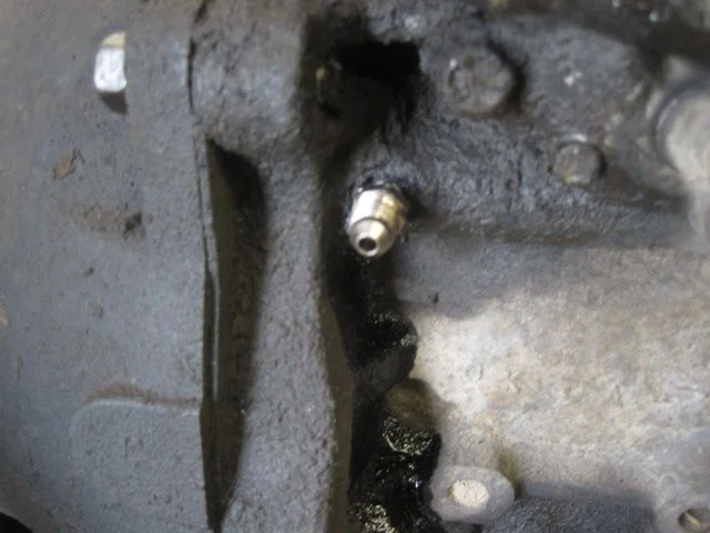

i pulled the oil feed from the rear of the block

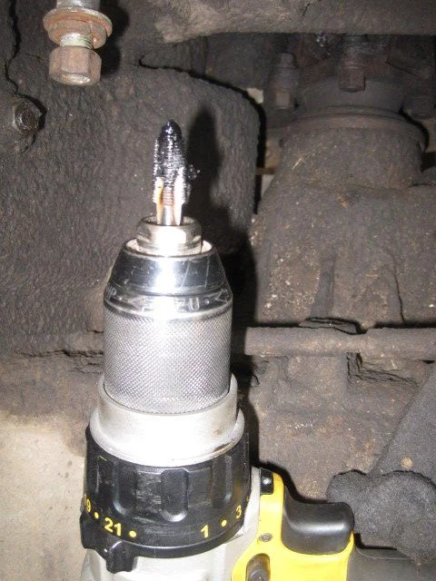

i have found the NPT thread diameter to be slightly larger than the Japanese thread diameter so i run the tap in to open the port up slightly.
i put grease on the tap to trap the fillings and check often for contamination. in and out and in and out a whee bit at a time.
the fitting installed.

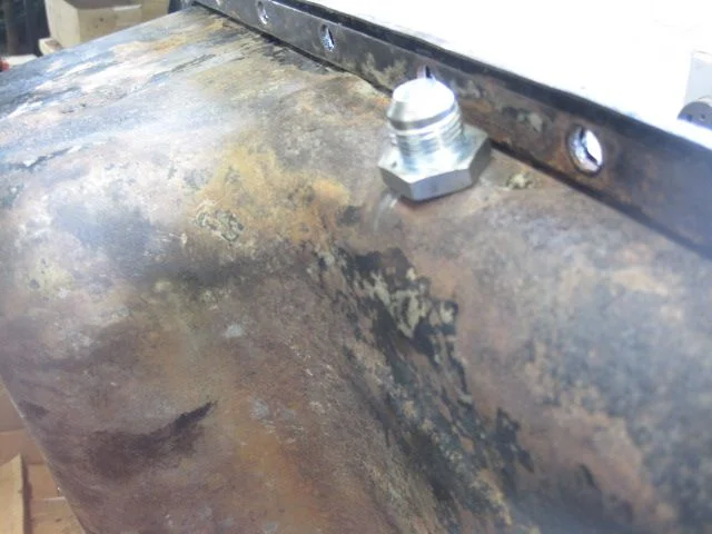

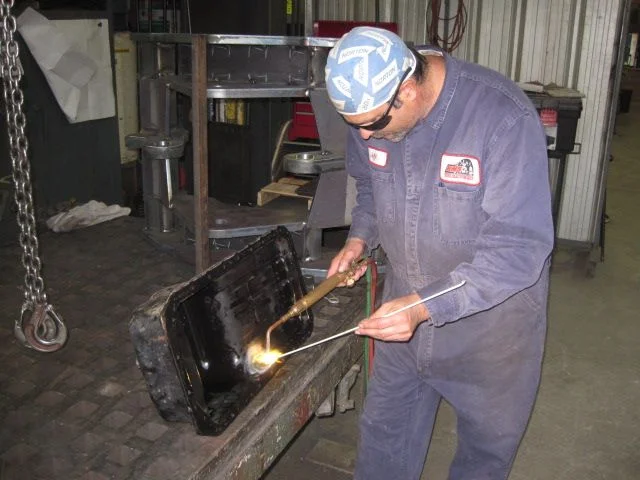

next up is the return spigot into the pan.
mark, making sure you allow for oil level, pan bolts, oil filter, blow by tube, engine mount, rotating conrods and oil pickup tube mounting. you MUST have a free flow for the oil to return since it is gravity fed and not pressure fed.
insert spigot
braze and make sure no leaks ...

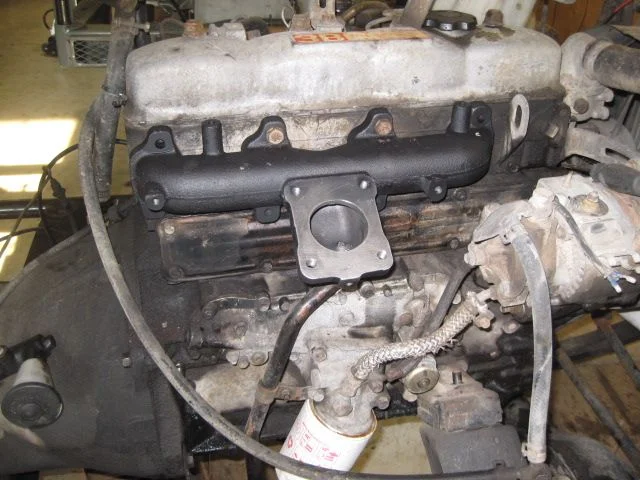

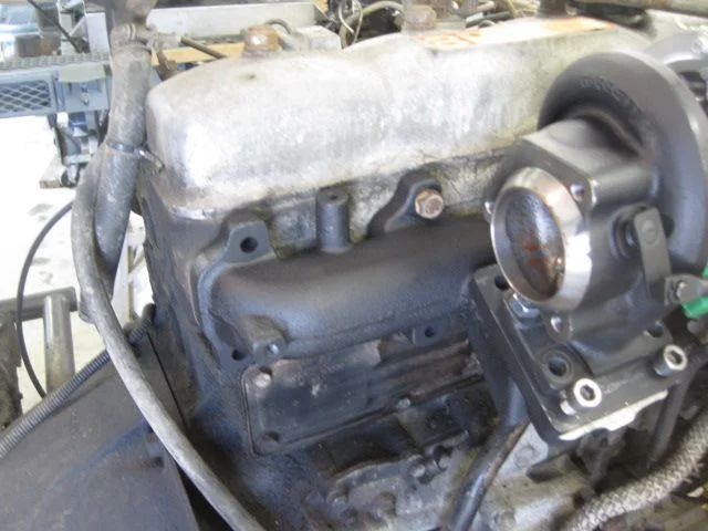

the manifold painted with high heat black
once we found the flange, reamed it out to fit and had a piece flared to fit over the raised step we painted it black as well.
the pyro will be fitted to the manifold.

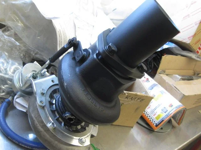

the turbo kit.
there were issues with the kit:
there were 4 boxes that were sent, it took over 6 weeks for them all to arrive
the exhaust manifold gasket was missing
the 2 longer exhaust manifold bolts were missing
the adapter between the manifold and the turbo had studs too large for the turbo recieving holes making drilling the turbo out to fit.
the exhaust manifold bolt holes were wrong pitch for bolts supplied
no instructions were included
no cross over pipe was included
no ducting from the air box to the turbo
the boost line was too short
no flange for the turbo to exhaust pipe
no bolts for the flange
all in all, i am unimpressed with the "kit". i do hope the performance is as suggested.

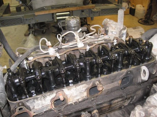

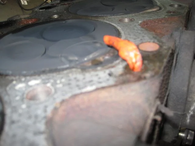

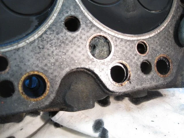

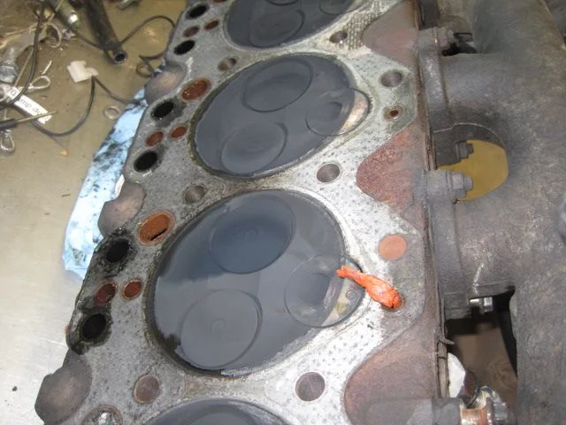

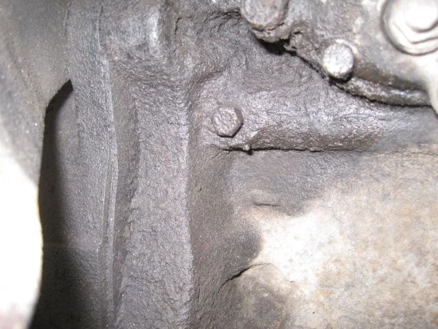

next there was an oil seep from the front and the back of the head gasket area that needed addressing.
removal of the head.

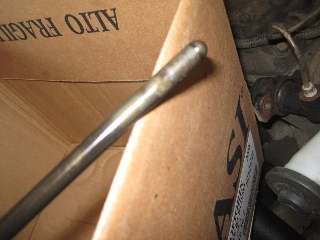

the pic of the pushrod didn't turn out the way i wanted but it had some caked on crud on the lifter end and the way the oil came out i am doubting the frequency of the oil changes.

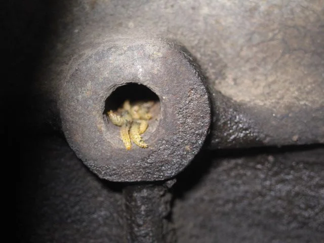

this "orange slug" was in the water passage when the head came off ...:eek:

another pic of the orange slug
stop leak was used at some time during the engines life

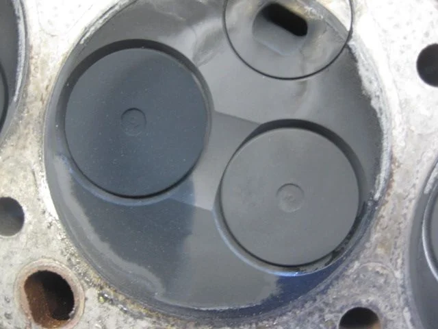

the head itself is in excellent shape although all 4 prechambers have some decent cracking and will be replaced.

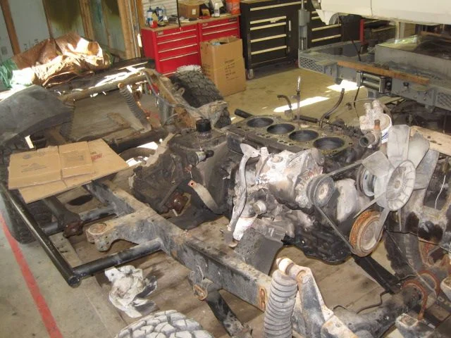

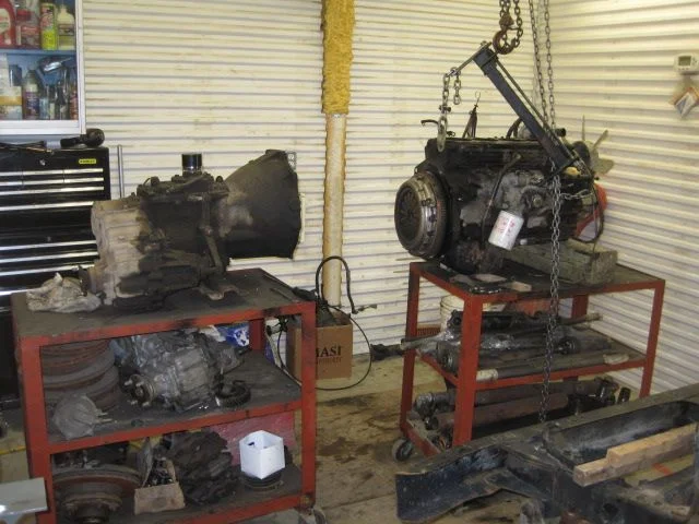

and out comes the engine ...
a bare frame in forthcoming

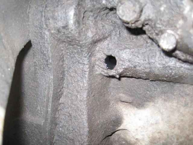

I think that oil feed line is BPT, I remember years back when I ran a tap through mine someone saying that. I don't know for sure if it's fact!
I will be following this build!
Cheers

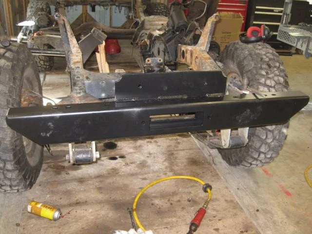

testing the bumper for fit, once the PC is applied to the frame i would be depressed to have to modify it.

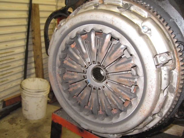

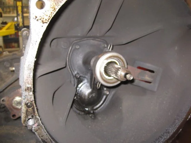

seperating the tranny from the engine
no unusual wear on the pressure plate
no wear on the imput shaft and the release bearing looks and spins fine
now off to get the tranny section degreased and painted
