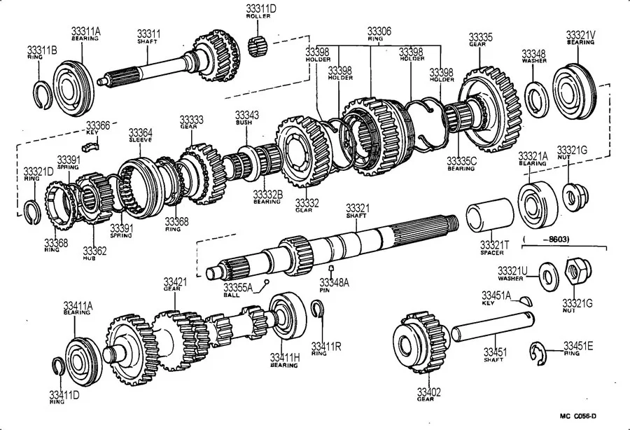

Okay so basically from what I can tell in the H42 and H55(?) transmissions, only 3rd and 4th gear have the typical brass synchro gears. 1st and 2nd shift using a specialized 1000 dollar “ring” as toyota calls it or “piece” as everyone else seems to call it. It’s a shifter dog, reverse gear, 1st synchro and 2nd synchro all wrapped into one ridiculously expensive unit. I am having an issue with 2nd not wanting to cooperate. It doesn’t want to go into gear when I’m going up or down, it can be used if I shift in a 1-N-1-2 fashion. Sort of a double clutch idea, but if I unload the transmission and start decelerating in second it throws the stick back into N. So, can someone explain to me how this “piece” works without having brass synchro gears? And if anyone has any clue as to what’s going on with this transmission issue please chime in also.

I did the rebuilding in question. Using what I thought were good quality parts, all the bearings and seals were replaced and I inspected all the gears/shafts when it went back together. Worked great for a few years then suddenly lost second. That’s when I changed the shifter seat and shifter pins, worked great again for a few days then turned back into a 3 speed.
FWIW the only time I lost 2nd and remainder worked was when the rear output bearing took a dump, lets output shaft and everything on it slide back a bit causing that 1,000 piece to not slide right. I dont think it can go back far enough fo rthe needle bearings between the input & output to drop out, thats why it stays working. The tapered ends on that piece cause it to spin, kinda like a torque converter, did you put all the snap rings & spacer in correctly when installing tcase ? sounds like the rear bearing is toast or not installed right.
Yeah I’ll open it up and take a look at that rear bearing. Would be really annoyed if that’s the case because it’s a KOYO bearing and has barely any KMs on it so will report back on that one.
