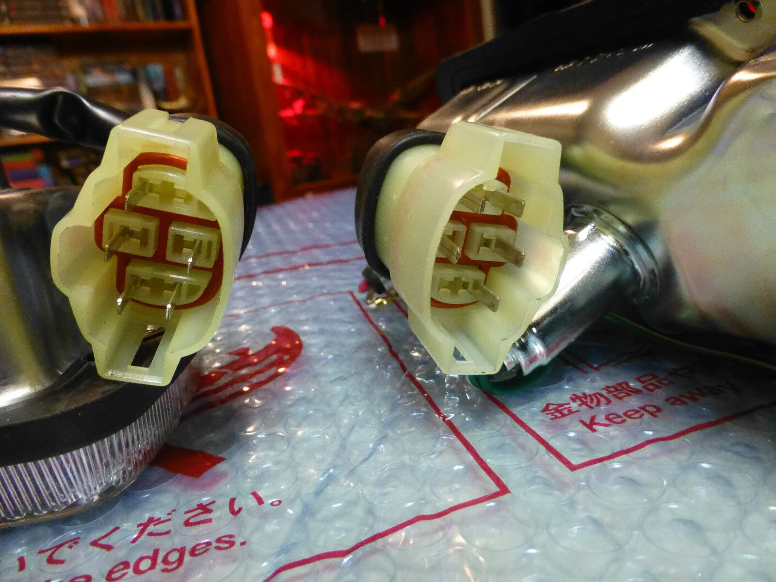

the bulbs / socket's color coded tracer stripe wires usually fracture / sever just inside the little black rubber tit grommet they enter on the back side ....fyi
carefully depress the locking tabs and separate the connector plugs , look for green corrosion , and or burned terminals too ....
always re-assemble using fully synthetic food service grade di-Electric grease , pressing plugs in and out apart a few times to spread the love around inside there
you have the oval 6-pin connector plugs right ?
