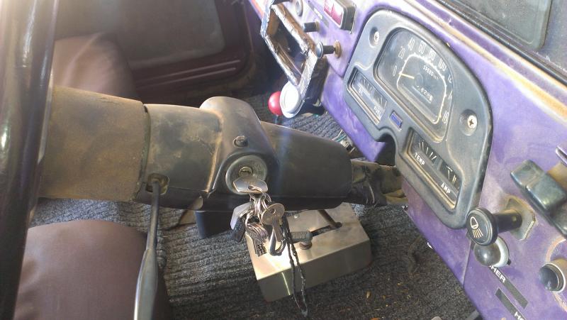

Here are some photos of my current column
I live in Western Australia and was hoping that just putting a column from a newer model such as a fj45 would do the trick as i'm on a tight budget.
I have had this column apart and it has a solid shaft the whole way up. Any cheap easy suggestions would be great. Thanks.

Like I said the 8/80 and later will be the easiest way to get a collapible steering column. There will be a mod where it goes thru the floor board since the pattern of the flange changed. On LHD models the power steering column was shorter than the manual steering. Tne manual column can have the lower shaft cut down and a hole drilled for the pin that fit into the upper shaft. But the power steering column would be too short for manual steering. Looks like you have manual steering just to be safe I would get a post 8/80 manual steering column out of any 4X series cruisers and you should be good.
