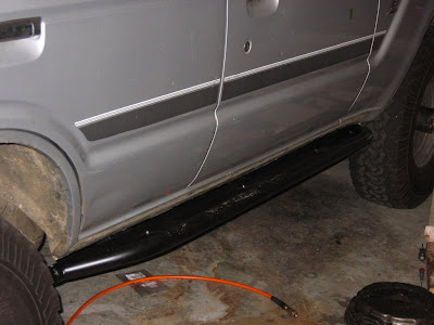

I ordered the Trail-Gear sliders from Ebay (thanks Tkinze!) and got those installed before my trip to Tellico at the beginning of August. I know, they're not the best slider out there, but limited funds and wanting to preserve the rockers on Bull lead me to them.

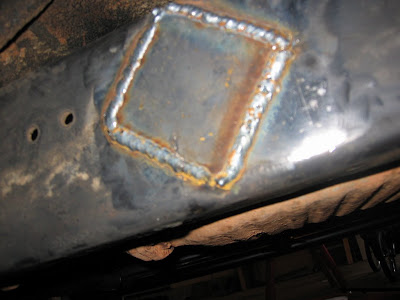

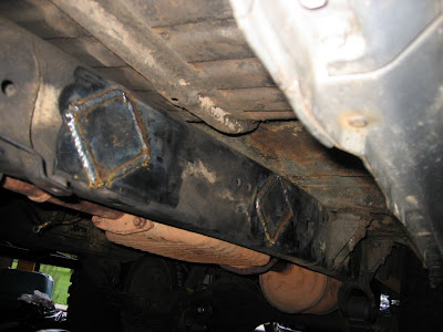

My neighbor has a MIG and is really good with it, so we spent a few nights and came up with this.
Squares welded as diamonds on the frame

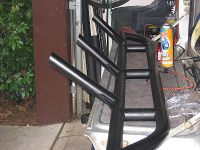

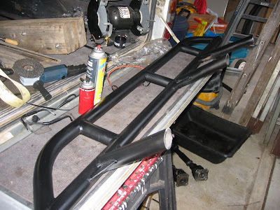

That was the easy part, the hard part was getting the angles right on the legs. Complex angles and a portaband don't make for quick work, but we got them cut and welded to the sliders. We had extra material from the frame plates, so we made gussets for each leg, which you can see in the pics. Time for paint!

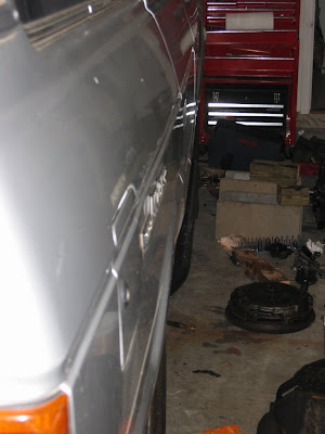

We mounted the sliders 21° from horizontal to give me enough room for a step, but keep them angled up and tucked in. Looks good in my opinion.
A side shot, a little difficult to see. I'll work on a better pic.

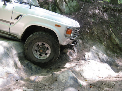

All in all, they turned out great! And just so you know they weren't for show, here's a pic in action, doing what they're supposed to, keeping Bull from gaining more scars.
