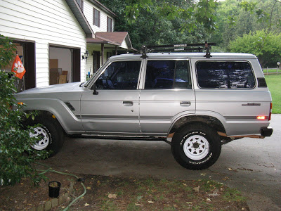

Labor day weekend was a busy time for me and the Bull. I got the tires moved over to the wheels I got from VTCruiser. The steering response is greatly improved, with the move to the 8" wheels. I turn the wheel and the truck goes where I think it should. As for the color of the wheels, I kinda like the retro look. What do you think?

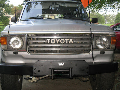

The thing I was excited to get done this weekend was getting the bumper I got from Tatertot and my traded for winch on. I hope that I never need it, but it's great insurance. When I first put the bumper on, the wings weren't even, so I put one against a tree, put it in LOW, and pushed, now everythings even. Unfortunately, I realize that the front springs are OME mediums. Bull's now riding the stinkbug after the winch. Gotta add the OME Add-a-Leaf to the upgrade list.
I'll get a pic from above to show the winch install later.

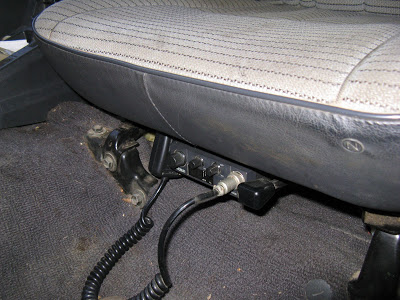

One more thing that I forgot that I've put in is the CB. I put this in before going to Tellico in August. I was in a hurry and running outta time, so I needed something quick. I used cable ties to secure the bracket to the hogrings on the bottom of the driver's seat. It's in just the right spot that I can still move the seat. The only problem is that I need to set the channel before I get moving, but that's not normally a problem in the woods.
A quick pic of the installation.
