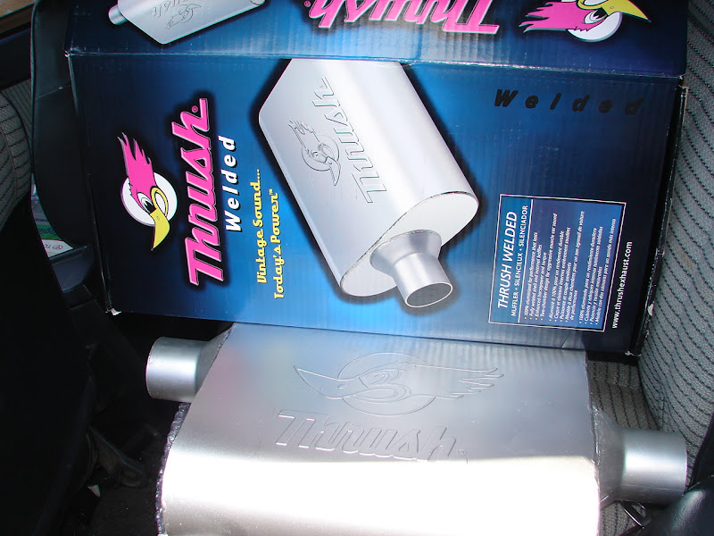

The muffler prior to install.

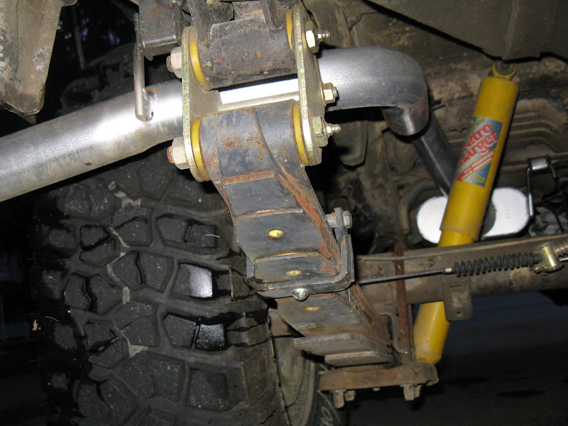

Here's a pic of the underside of the truck, had them change the routing to just behind the rear wheel. Now I don't have to worry about squishing it again.
I went with 2.25" tubing, as the exhaust guys were certain that it would be too loud without the cat. Yeah, that's right, removed the cat at the same time. It was a 15 minute drive from work to the muffler shop, and they couldn't touch the cat because it was so hot. It made the skid plate too hot to handle.
The truck has a mean idle sound, I get asked all the time if it is a V8. At cruising speed, I can't hear the exhaust over the wind, tire, 2F noise. No internal cab resonance. Overall, I'm very happy with this muffler and setup. Plus the price was right, $30 from Summit.

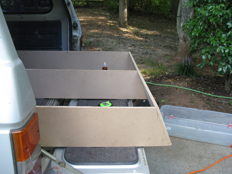

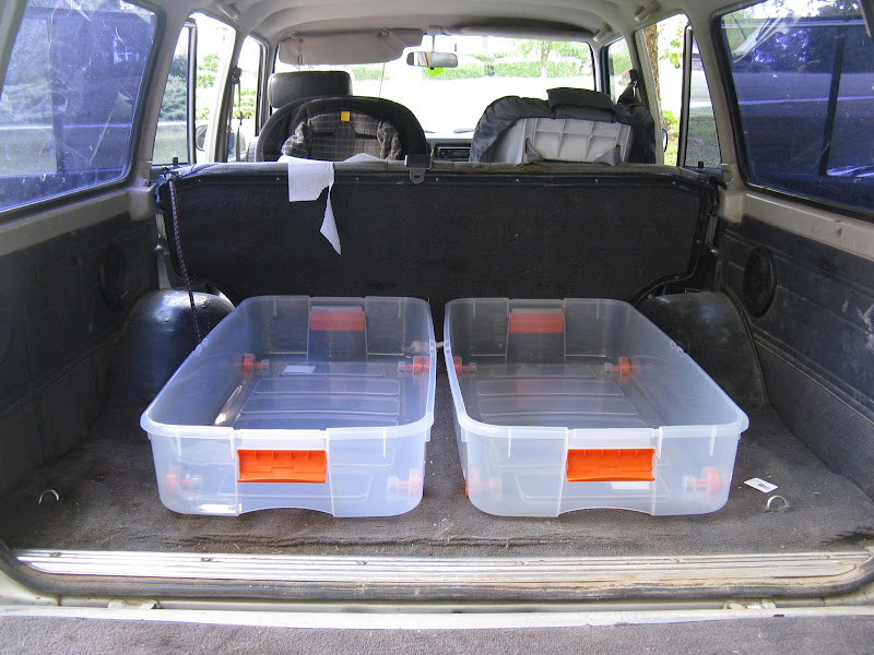

Back in August of 2009, I built a drawer system/platform for Bull. I used 1/2 MDF to keep it light, and rubbermaid under-bed boxes for simplicity. I installed some D-rings on the side to tie the box to the truck, and some rails and removable tie down points for the platform.
Here's how it came together:
The system worked great for the last year or so. Made a few wheeling trips with it, and tailgated with it, and it was amazing. Light enough to take out when I needed the whole cargo area.
However, there are some areas for improvement. I wish that I had made it with a platform for sleeping and did something different for the space between the box and the quarter panels. The under-bed boxes work well, just wish I had put a thin bottom on the box to ease the rolling of the drawers. Probably the most annoying thing is that the tie-down rails would get in the way and scratch things all the time.
Looks like I'll get a chance to rebuild these and make them right. Was helping a friend out by hauling 15 80lb bags of concrete a few weeks ago, and the MDF just split away. Damaged beyond repair.
Guess I'll be using cabinet grade plywood and try to recess the tie down rails into the surface. Also, this one will be built with some sleeping considerations as well. Going to get started on that in a few weeks. Hope to be quick about it.
