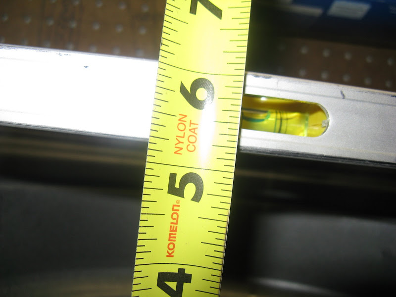

The wheels are 16x7's from an 05-07 Tacoma Prerunner. When I went to pick up the wheels from a Craigslist listing, they were supposed to be Tundra wheels (with the 4" backspacing). But they didn't match the picture on the website. The guy told me they came off a Tundra, so I believed him (didn't have a tape measure with me). Get them home and put them on, NO GO. Touching the TRE's. Take them off to measure, and see what I found
That's right, 5 3/16" backspacing. If I wanted to run these wheels, I was going to need some spacers. Found some (4) 1 1/2" spacers on ebay for ~$120. Doing the math put the wheels at 3 11/16" backspacing, just outboard of the factory 3 3/4". Figure that should work well. Plus the spacer and wheel combo was cheaper than ordering wheels and I have the option to change to whatever I want in the future.
