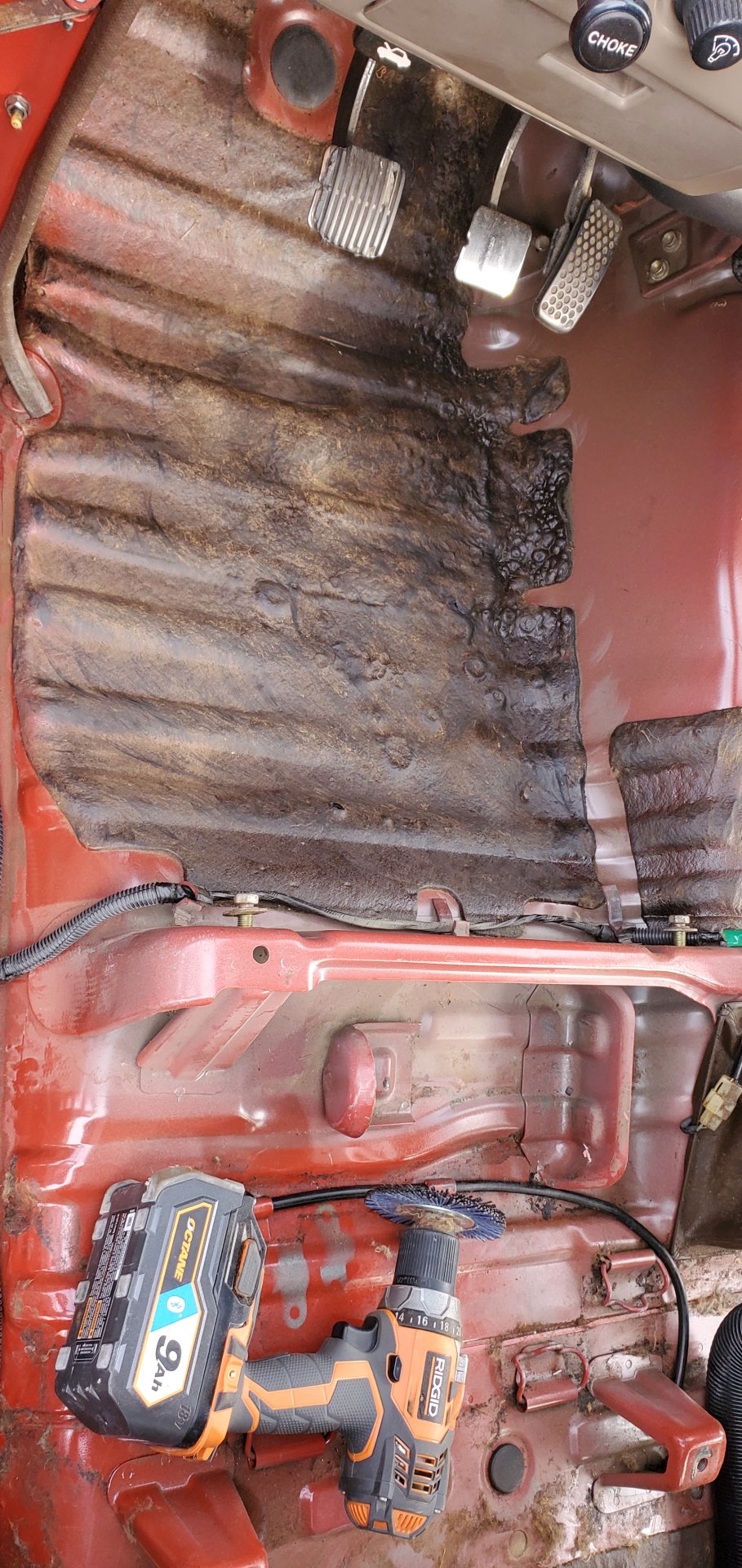

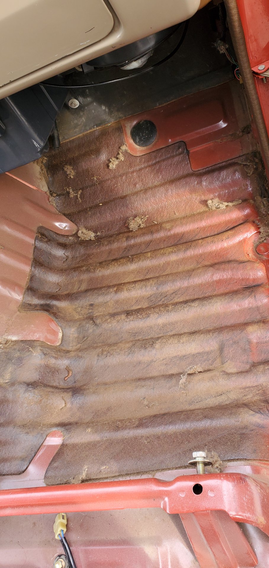

So I decided to open up a can of worms. I'm getting my upholstery redone and I'm having a new custom carpet kit made. I basically stripped all the interior out of my truck and now I'm trying to figure out the most effective and safest way to remove the old carpet pad without damaging any of the metal interior? There's absolutely no rust on this girl and I would love to keep it that way. Anybody has any tips or tricks I would love to hear. Thanks!
Good cleaning solution, water, let it soak, scrub brush, plastic scraper, and elbow grease.

Good at it this morning. Gotnthe front cleanedup with a really soft bristled brush but not using that on the metal.

I used dry ice and a hammer... once the tar is cold/brittle it shatters and easily removed. Doesn't require pounding hard so you're not denting the floor.
