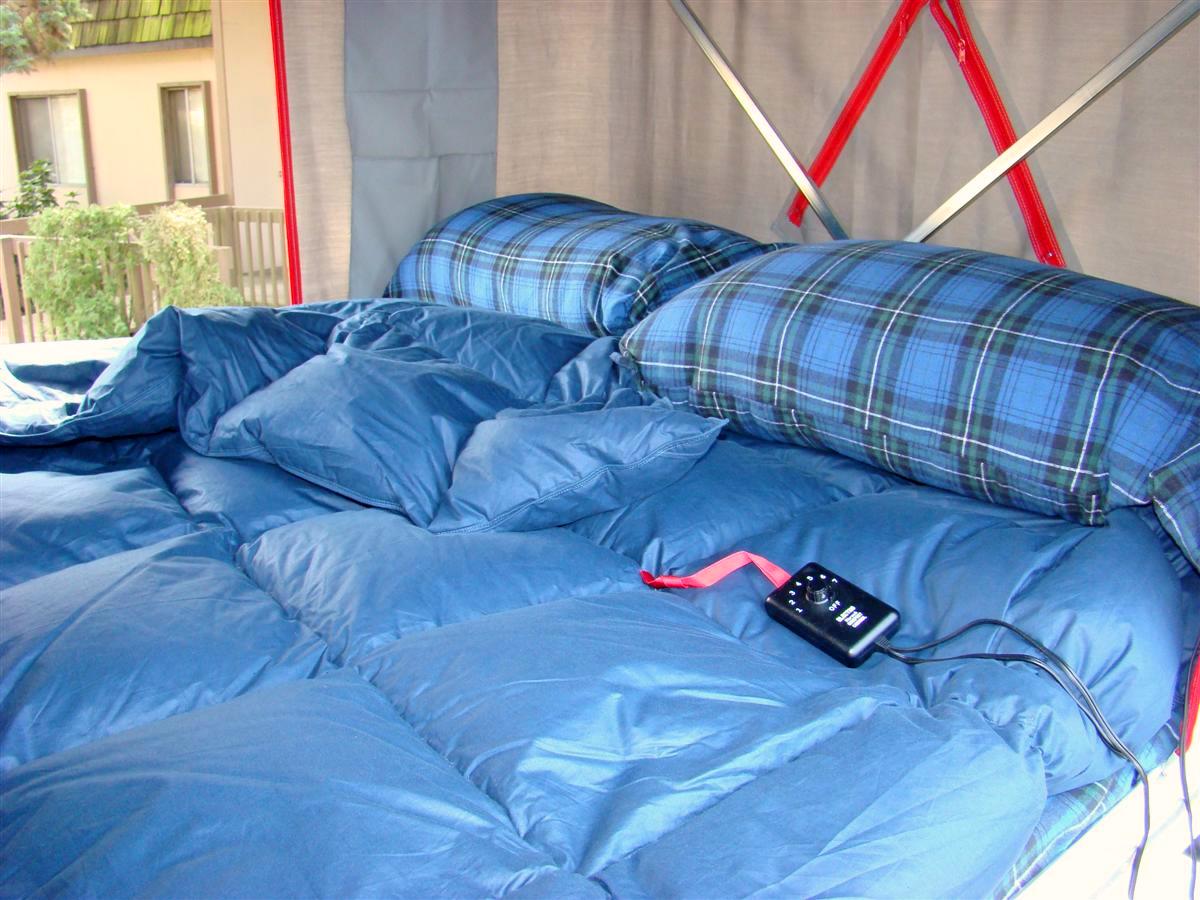

Washed the r(p)ig Saturday, got the gunk off the tent top.
Sunday I opened the tent and after a very wet winter with snow, ice, and tons or rain, it was bone dry inside.
Took out the sheets and laundered them, and shook out the comforter.

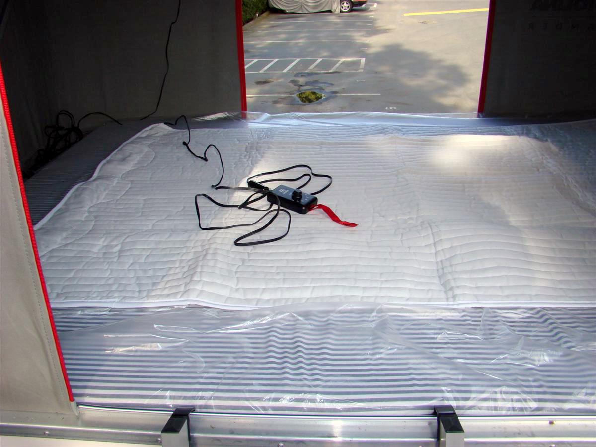

The 12v pad comes with safety pins to pin it down to the mattress.
no need for the mattress to be up under the pillow, so I pulled it down all the way towards the foot area.
Since they no longer offer the 54x60, the biggest choice I had was the 42x60, so it does not cover the whole bed.
It is a shame they no longer have the wider one, it would have covered the whole bed width wise.
I also took out the two small pillows that are supplied (came with three, but I only used two) from Autohome, and I replaced them with Serta full/queen size pillow in firm.
This will be a lot better, as the stock pillows were a little to small for me.
This makes it even more like sleeping in my bed at home now.
Unfortunately I was not able to plug the pad in, I need a 12v extension cord.

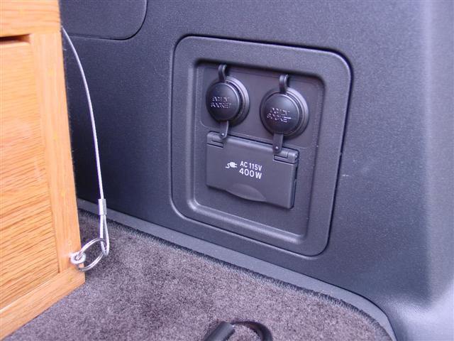

Also since both of my 12v outlets in the rear of the FJ will be supplying juice to the tents 12v light and the ARB fridge, I will get some clips put on the 12v extension cord and run them right to the aux. battery under the hood to power the 12v heated pad.
It is heavenly.

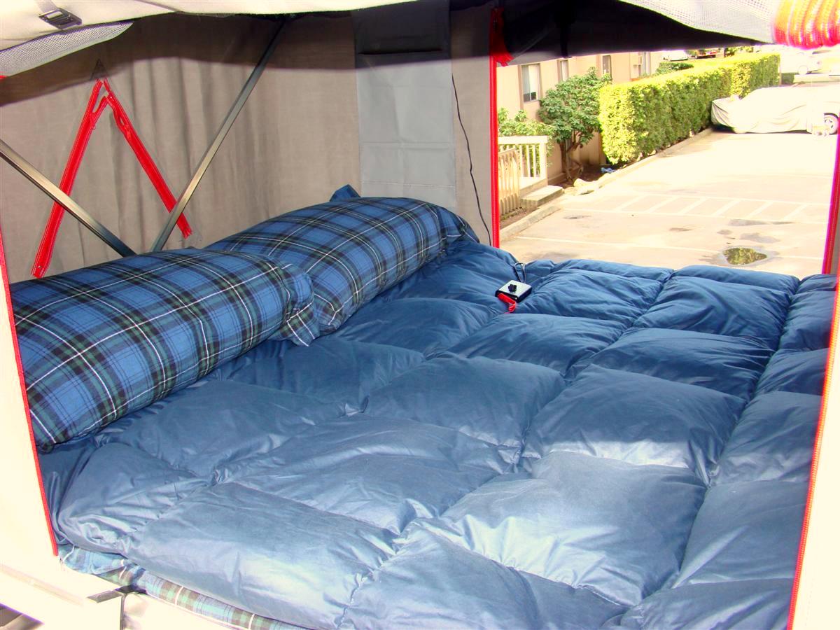

Last year was the first time I had used flannel sheets and a down comforter to camp with.
Always had camped with some type of sleeping bag.
I love sleeping bags, but after sleeping in the tent with the mattress, sheets, and comforter, it is just like home, much more comfortable for me.

Right now my dual 12v outlets in the rear of my rig are for the ARB fridge and I ran the Airland light there too.
What I could do is get one of these dual or triple 12v outlets.
Either run the plug from it to inside of my rig to the other 12v outlet, or put battery clips on the end and run it to one of the batteries under the hood.
There may be a way even to hard mount the dual or triple outlet box in the tent.
Then the tents light and the heating pad could plug into the new outlet box.
Just thinking out loud here :D
