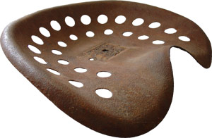

i have always wanted a steel tractor seat for my play truck.....
