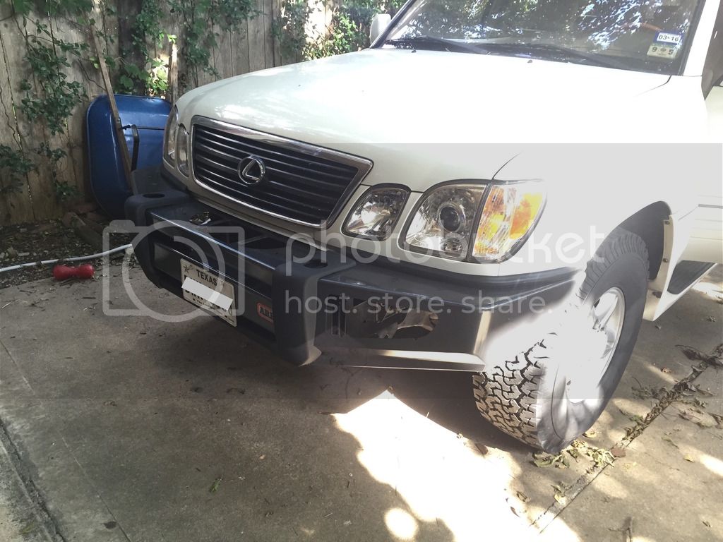

Since you are looking at the ARB Sahara and you have an LX, I thought I would mention that there is a lip on the front body fender of the Lexus LX which doesn't exist on the Toyota LC. This makes the fit a bit awkward. I have made the Sahara work on my set up (with a 3/4 inch, undesirable gap), but if I was in your position, I would consider alternatives that fit better...like a Slee bumper or one of the many alternatives. Just my 2 cents!

We were able to tweak that lip on my brother's LX and got a very snug fit on the Sahara. Unfortunately, that snug fit equates to the grill scraping the hoop when opening/closing the hood.
