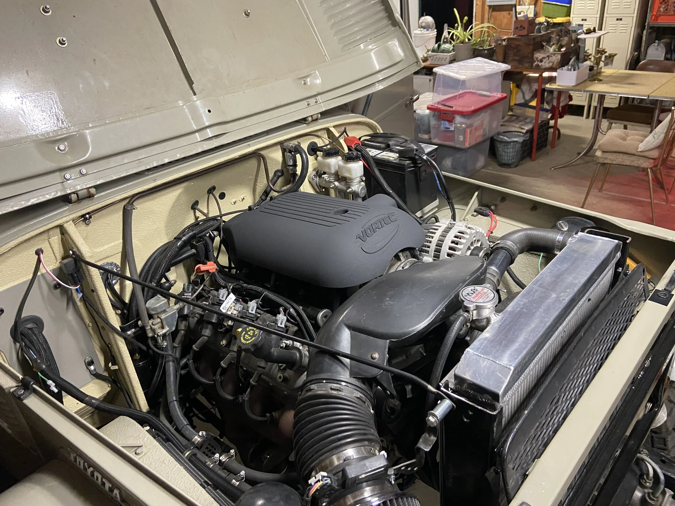

Nice engine compartment! I know the purist won't like this, but I have planned from the beginning to do 2 FJ40's and the 2nd one will definitely be a SBC V8, hopefully an LS swap, so I can have an FJ40 with an automatic transmission. That will be much more comfortable to drive as I get older due to multiple low back surgeries and both hips. Also, my wife says she's too old to drive a stick shift, LOL. And the extra horsepower would be a bonus! Which transmission are you using? Overdrive? And are you using some sort of adapter to continue to use the original Toyota transfer case and 4wd, or is it a Chevy transfer & 4wd, or just rear wheel drive?

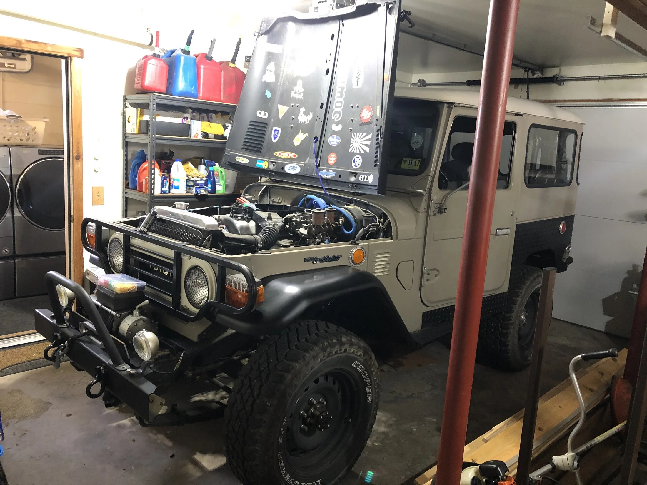

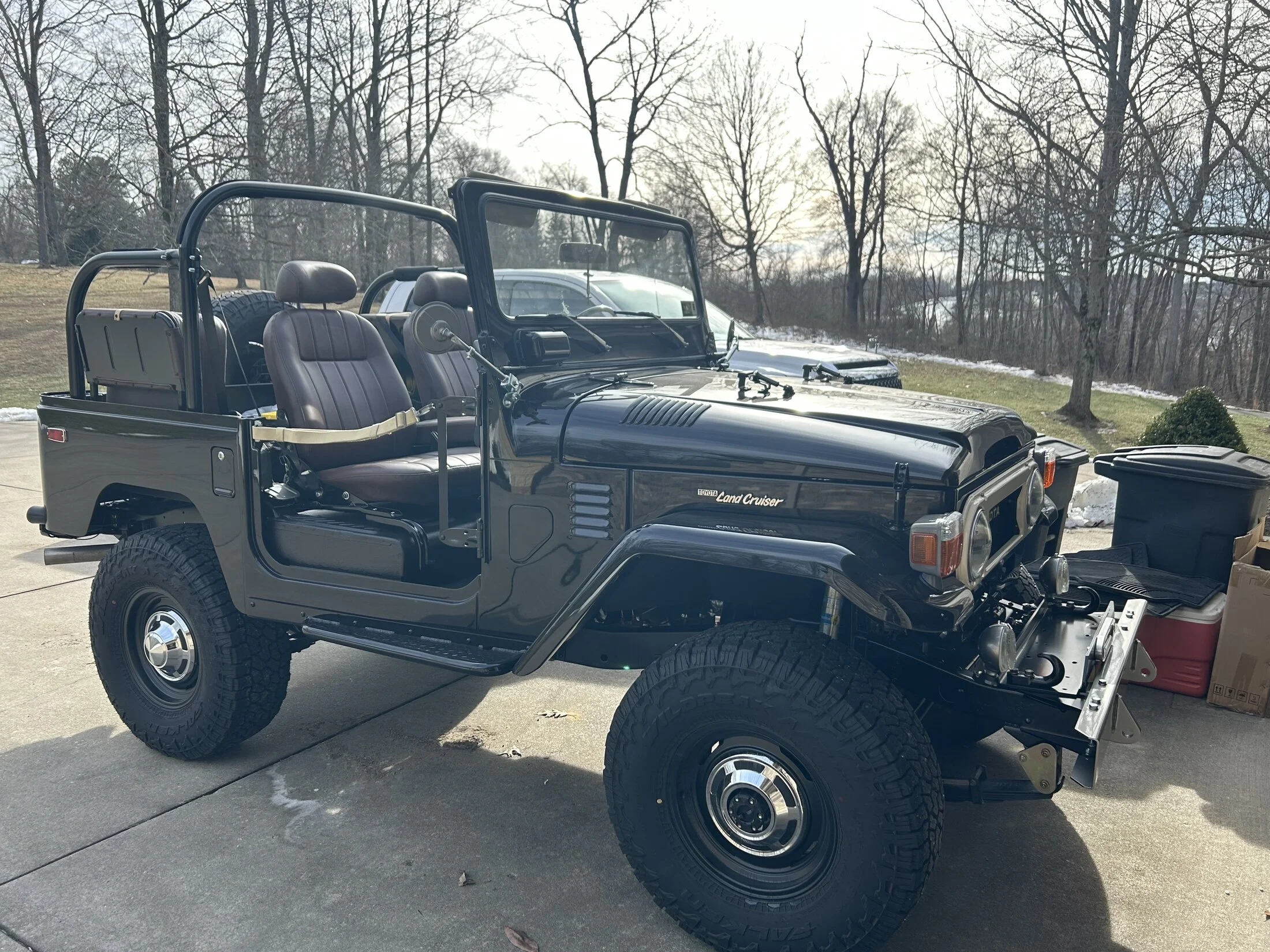

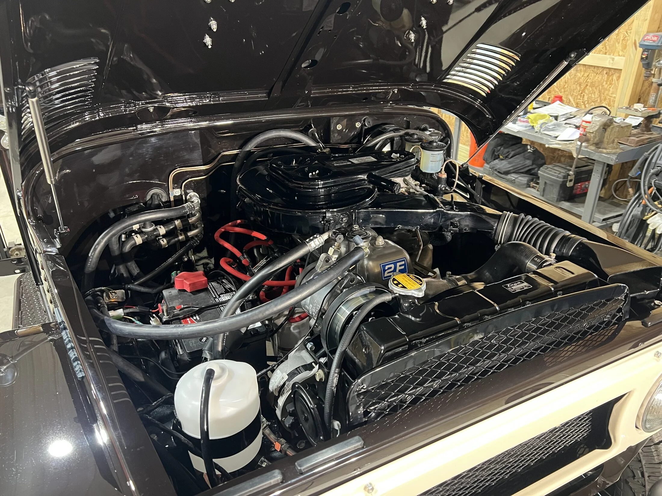

Full Aqualu swap (-hood).
Very nice! In the first one I see that it is using the dual reservoir master cylinder, which "looks" like mine but may push more fluid than mine. That's interesting, because all the disc brake conversion kits I see use a smaller master cylinder with 1 fluid reservoir.
Both of those are beautiful rigs! I'm guessing the 1st one is the '76. What year is the black one, and what is under the hood?
Thanks!!,
It is a 76 but, It’s the same LC in both pics. Swapped the Body to an Aqualu. It’s actually brown, it shows different depending on the light. Upgraded the brake booster to the City Racer offering. Engine is the same 2f it was born with 3/76. Although there have been some additions..

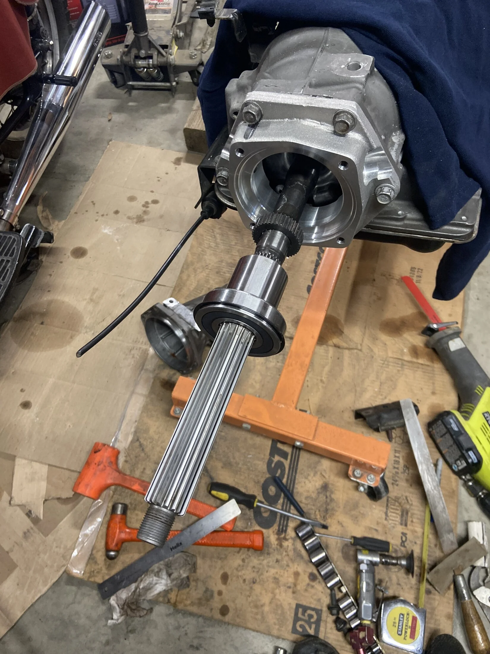

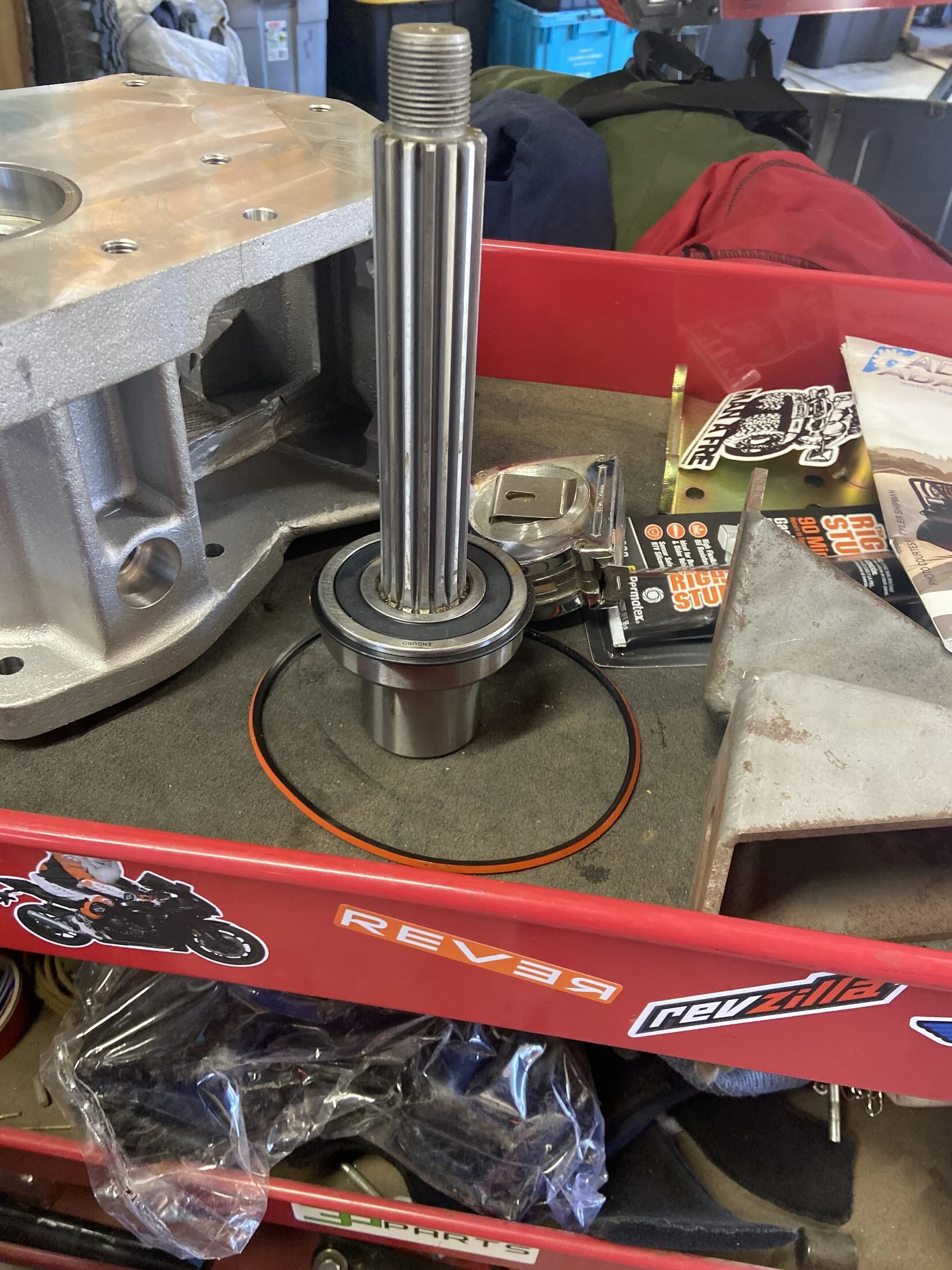

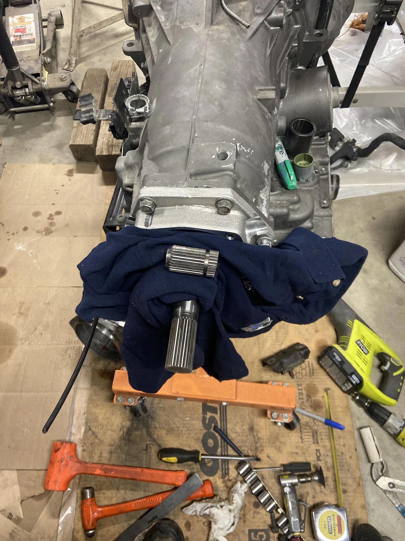

Yeah my wife gave up on the stick years ago. The installation is of a 2002 Suburban 5.3 LM7 and 4L60e Overdrive automatic (2wd). Advanced Adapters mates it to an early Tcase. Engine had 90k and the transmission had been rebuilt. Both run great and it’s nice to have the OD with the 33’s because it only turns about 2000 rpm at 65 mph.
Make sure you get the 2wd transmission if you go this route. The AA adapter won’t work with the 4wd version of the 4L60e; difference in output shaft I’m guessing.
AND don’t split the transmission off the engine if you don’t have to. Getting the two back together without damaging the trans oil pump can be a nightmare. Or so I’m told.
