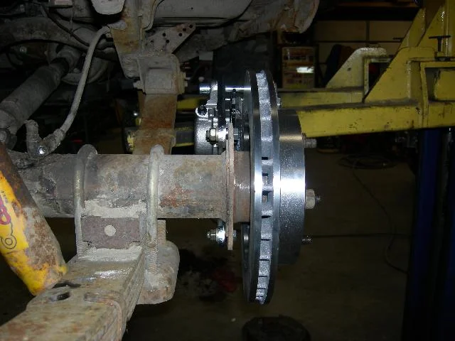

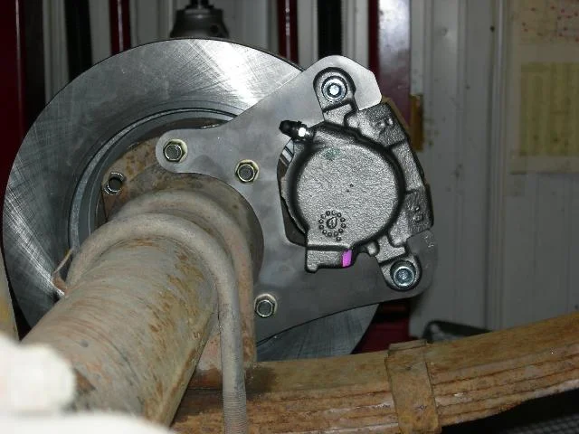

Nail Bender Jerry decided that he had wasted enough time and money trying to keep the rear drums functioning on his 09/75-40 series, and dropped it off for a rear disc brake conversion.
I drained the rear diff gear lube and removed the rear cover so that I could get the axle shafts out to remove the backing plates without having to torch them off. I also wanted to inspect the Valu-lok (lockrite) in the rear and make sure that there was not any drama cooking in there, as it has been in service for a few years now behind a V8.

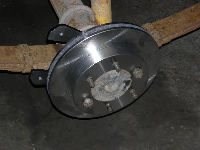

After not finding anything out of place there and no drama with the wheel bearings or wear surface on the axle shafts, I installed new axle seals, slid the axle shafts back into the housing and put everything in the rear differential housing back together, and filled with oil. I then bolted the caliper brackets onto the axle and slid the rotors onto the end of the axle shafts and retained them with a couple lug nuts for the time being.

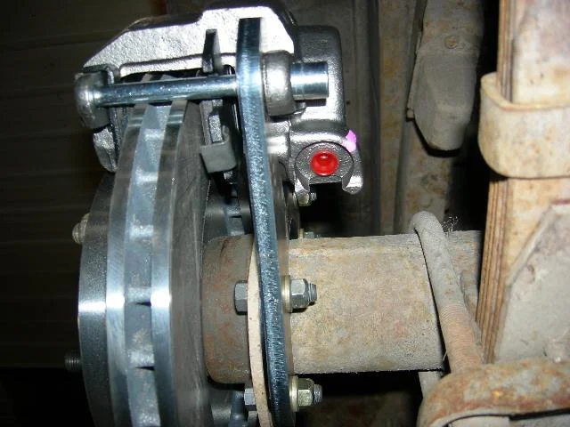

I like putting the caliper on the front side of the axle housing, so that the bleeder is at the top, and the hose can route above the leaf spring, using it for a little protection, in a spring under application.

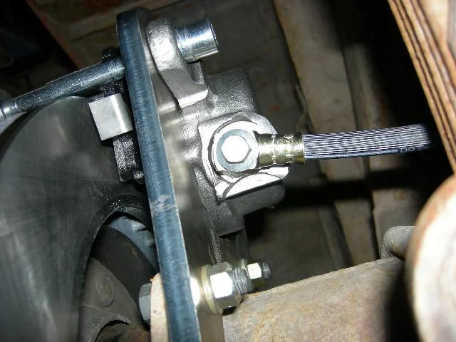

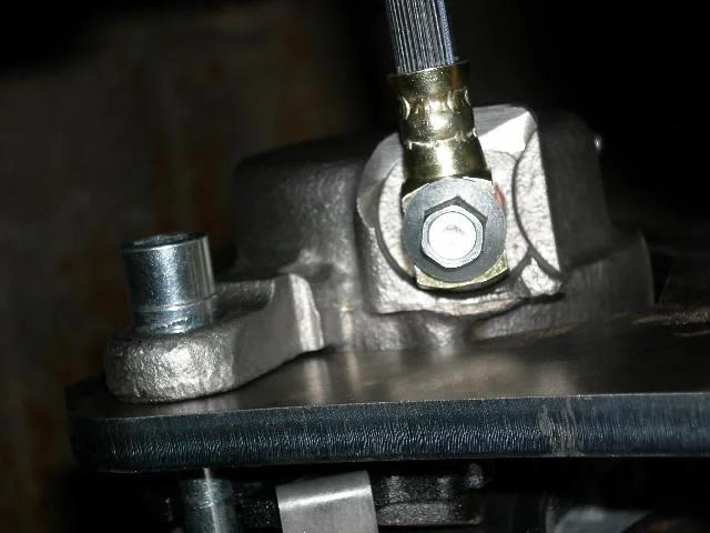

One thing that needs to be addressed however is the casting ridge around the area where the brake hose attaches to the caliper. I did not want to route the hose rearward and create a loop, so I had to remove a little bit of the casting so that the hose could be attached 90 degrees to the caliper.
You can see the area marked in pink paint pen that is in the way and was removed from both calipers, permitting the hose routing that I was looking for.

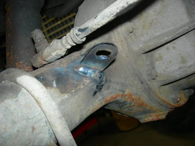

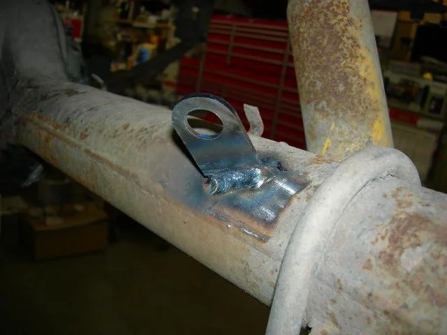

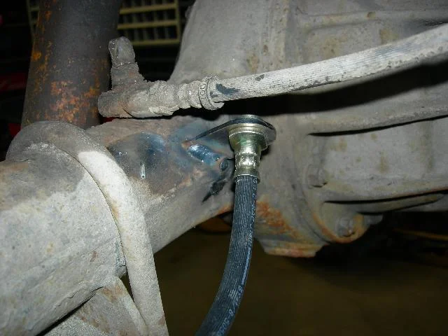

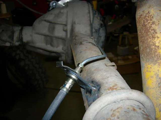

So next I figured out where the hoses needed to be secured and welded a couple little tombstone tabs onto the housing....

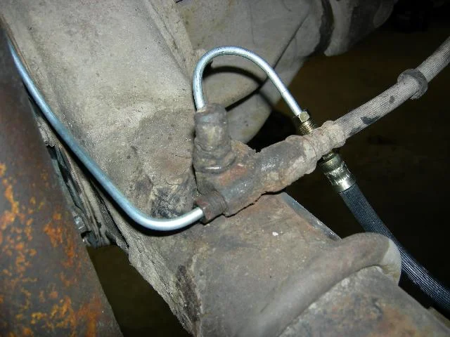

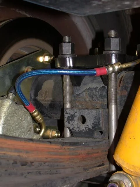

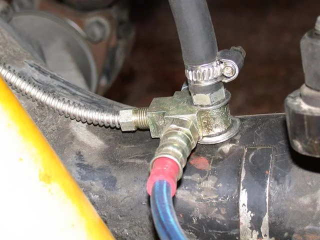

I then made up new lines to run from the splitter on the axle housing where the frame drop attaches, to the tabs where the hoses attach....

Is that a raybestos hose, 90 degree fitting, # BH38149?

Also I want to ask if these caliper can be changed left and right, and bolted behind the wheels and still leave the bleader on top. Also how do you cure the run out if it is too much, trun the axle shaft flange or new wheel bearings?
Yes the calipers can be mounted on the rear of the axle, and keep the bleeder screw on top. Again, the reason why I did it this way was to route the brake hose from the caliper to the axle above the spring, using the leaf spring as a shield for the hose. This is in a spring under application.

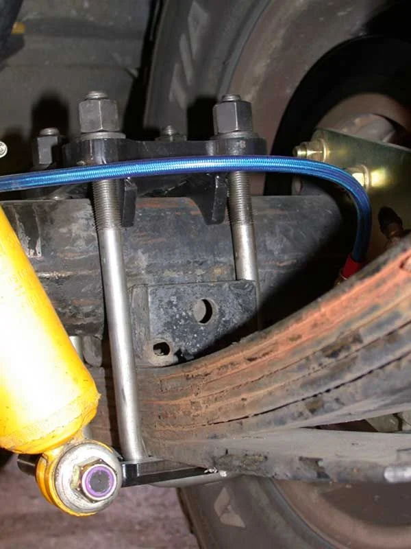

Steve, you do very nice work and I like the design of your mounting plates. There is more than one way to have the bleeders up. I prefer my brake lines on the back side of the axle as I feel the lines have more protection from rocks.
