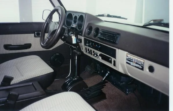

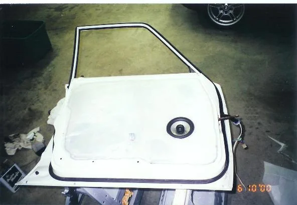

In my 89 I made small spacers to mount 5.25s in my doors for them to fit perfect behind the factory grills. I did not want to cut any metal. In my 87 I used a set of Pioneer coaxials that used to be called 5.25s, but now would more considered 6". I mounted them through the factory panel and into the metal in the door with just a small amount of panel trimming. I liked the sound MUCH better of the larger speaker and did not mind the aftermarket look.
Looks nice, Gary, but of course all of your trucks are incredible! I will look at 6" ones too.
