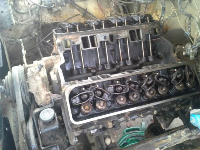

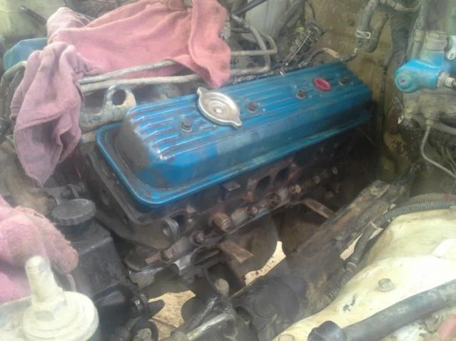

thanks, we are rebuilding the throttle body tonight since I have class all day and cant make it to the shop. we are dropping the intake on tomorrow first thing in the morning before the snow hits since the truck is on the slab outside. on Saturday we will be filling it with coolant, oil and do a final check of everything so that we can run it.
Tbi rebuilt intake on, exhaust manifold after lunch and wrapping up everything to run it tomorrow
