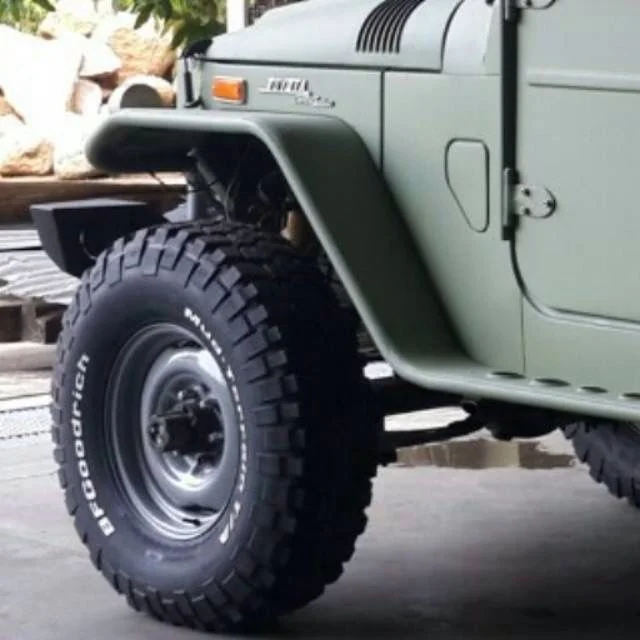

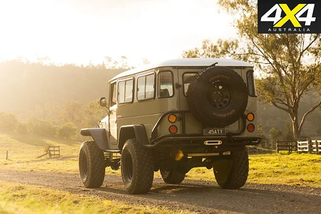

Why do makers build tube fenders with such heavy (large diameter) tube? I'll be bending up my own for my project but the ones I have been looking at for inspiration are 1.5- 1-3/4 tubing. That just seems like overkill to me. The stock fenders are essentially tissue paper in comparison.
I'd like to see some that you guys have made yourselves please. I was thinking of using a 1" DOM tubing sheeted with 1/8" which alone would be about 10 times stronger than stock. Shaped to more of a "flat fender" willys MB style.

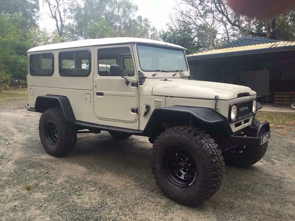

I thought most did use around one inch tube. Not mine.
maybe I'm looking at the wrong ones...
I am under the impression that the larger diameter (but relatively thin wall) tubing is used mostly to give an eye-pleasing radius to the outside of the fender. Too small a tube and it'll look like a jeep fender flare IMO.
Side bonus is that they're beefy enough to deflect obstacles.

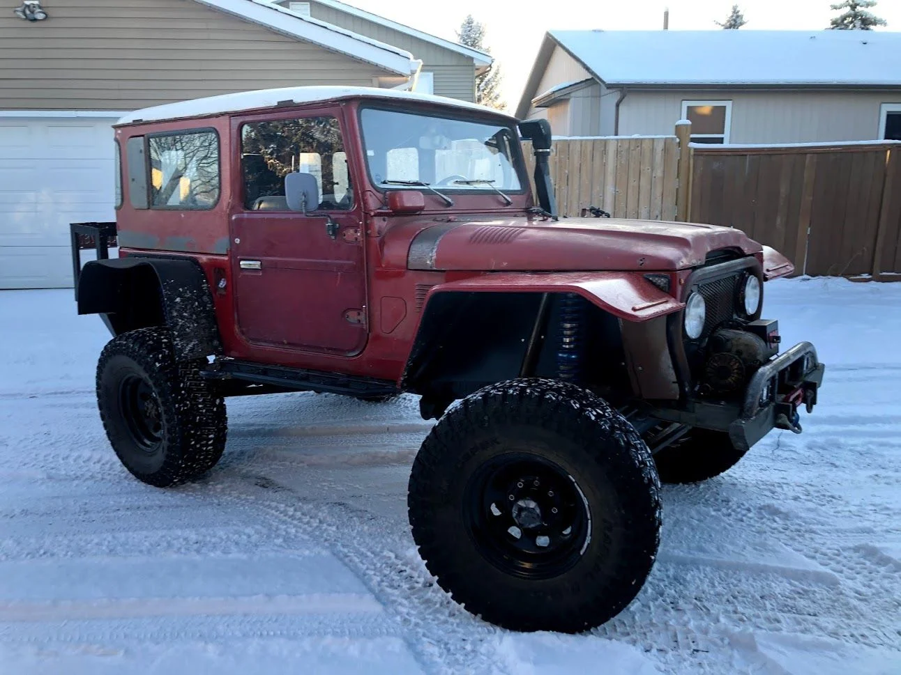

I used 1" tubing and some 16GA steel for mine, I made them removable with only a few bolts to to easily remove them for more hardcore wheeling.
