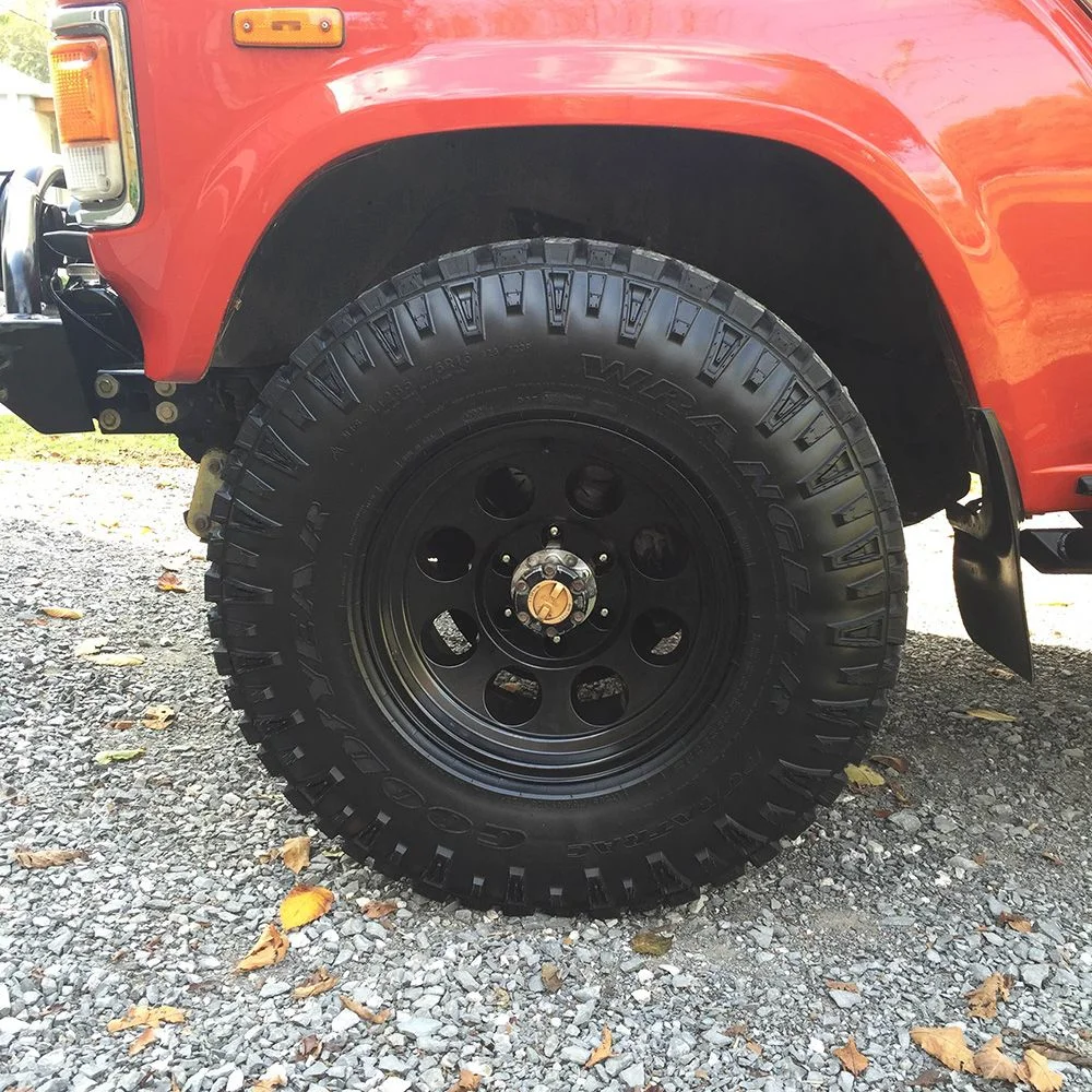

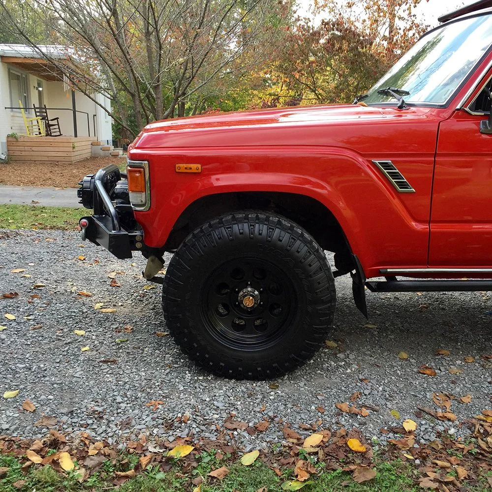

Small wheel update.....for awhile now I've been wanting to move to a 16" rim from 15" I've had. Couple common reasons for wanting to swap y'all prob already know about:
1) Higher load capacity tires, 16" tires come in E load range which will eliminate the tire bulge I had + be happier around corners
2) 16" tires are way more common in North and South America
My wheel criteria:

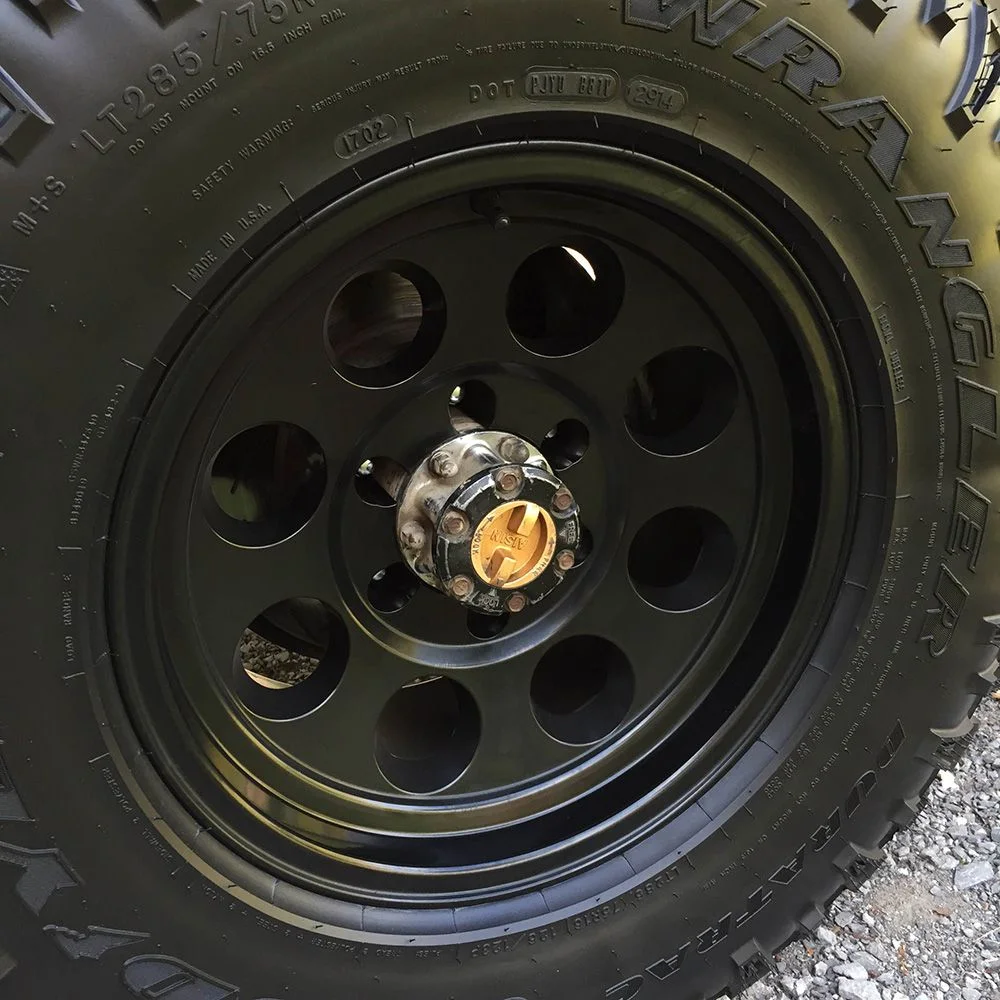

16x8 rims, Alloy, Black in color, no spacers needed....turns out this is a tall order and really difficult to find. Stock 1987 FJ60 rims are 6x5.5 bolt pattern with 3.5" backspacing. The wheel that came closest to this in my extensive search was the Mickey Thompson Classic Baja Lock but I hated that fake silver bead lock and the non-fake bead lock wheel version isn't offered in 16x8 with the correct backspacing. I also was willing to settle on these ProComp steel Rock Crawler 51 series, on paper they are perfect specs, but turns out there're not for sale in USA unless someone orders 2000 at once!
Another option was ordering custom sized steel Explorer wheels from Stockton, but after powder coating black + shipping they run $225 each...I also considered getting newer Toyota rims...
In the end I called up calling Discount Tire and struck gold! I'd heard rumors along the way that Les Schwab sells a decent looking steel wheel that fits but I wanted to see if they knew of any Alloys....boom they have one! It's a 16x8.5 black alloy with 3.7" backspacing that works perfect without spacers and no rubbing on my rig! The brand is called Level 8 and seems just as nice as any ProComp wheel I've come across....prob the same factory? They were $110/each delivered to Discount Tire listed as Level 8 Tracker Classic 16 X8.5 6-139.70 -25 BKMTXX
On the new rims I'm running 285/75/R16 Goodyear Duratrac tries...I paid $208 each for the tires locally (they matched Tire Racks price before shipping for me). If I was doing this a month later I might have considered the new BFG KO2's (they also are gonna sell that KO2 in 305 R16 size if someone wants in between 33 and 35" tire), they ship Nov 1
I was looking for a similar 16" alloy rim. I ended up with Eagle Alloys 100 Series Black Wheels 1002-7866 the center cap is just a nice solid black. 16 in. x 8 in., 6 x 5.5 in., 3.625 in. Backspace. Kinda looks like a steely.
I did run across those on my search, didn't fit my bill aesthetically with all the holes BUT they do look way better with a tire mounted, nice to see 'em. Def agree the stock center cap on the Level 8 wheels are cheesy, but with a dash of spray paint can't even tell on the rear.

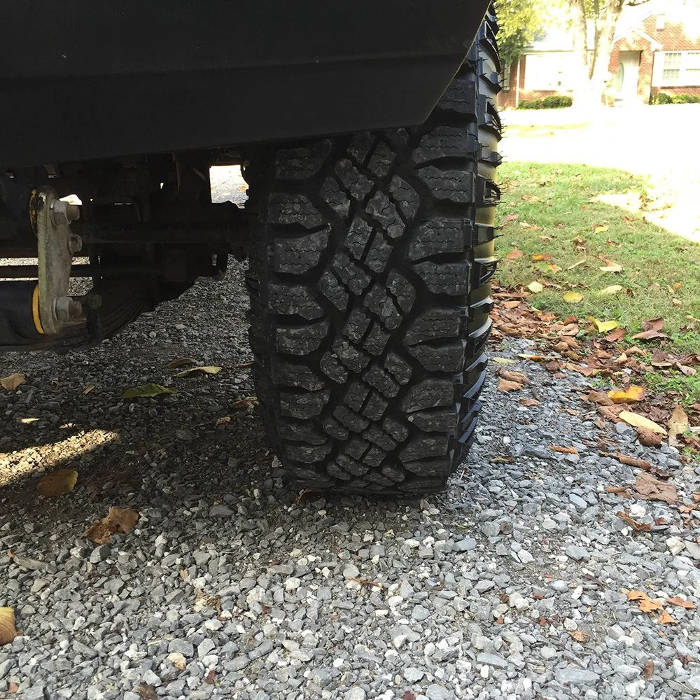

I'm thinking I'll do even better now since my new tires run @ 65psi (80 max) vs 35psi max on the old 15" tires + I went from a 12.5" wide tire to ~11" wide
You must be REALLY loaded down.... Using E rated tires i hope?
Yes sir, I do believe 80 psi connotes also E rating? But regardless it's a 10ply E rated....Here's the spec sheet for all the Duratrac tire sizes
When I weighed my truck last year at ARB in Renton I had 2300-2400 lbs on each wheel in the rear, which is like now 65% of the tires capacity, so 55-60psi could be better
