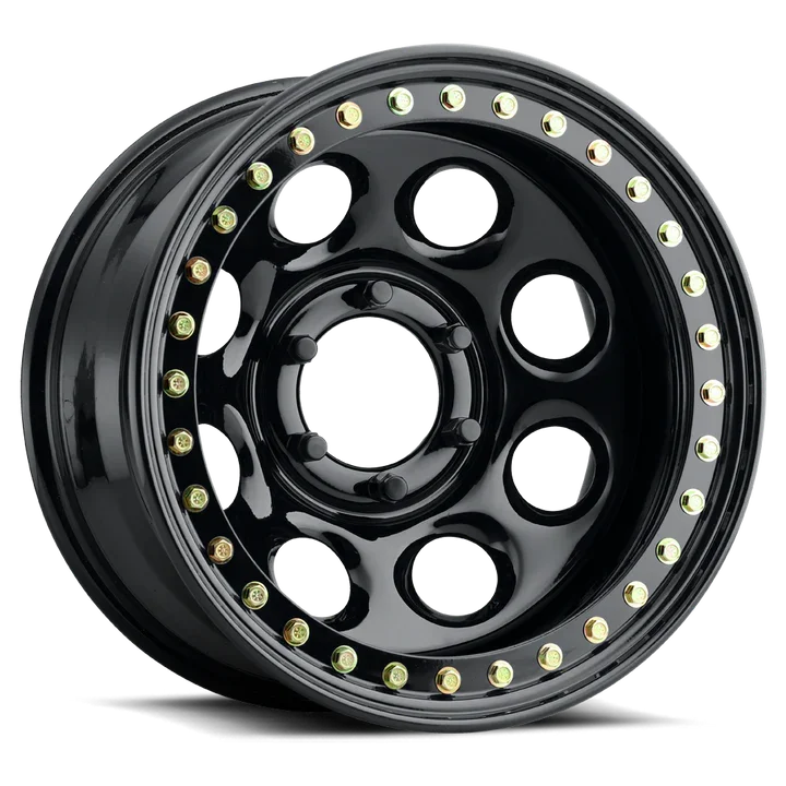

I'm almost ready to purchase a set of 17" steel beadlocks and I have to decide on the width. Most likely I'll be running a 37/12.50-17 tire. These will be going on my current build. Mainly trail driven with some street driving.
I've had no problems running 8" wide wheels with my 35/12.50-15 tires, ever. The lips are not all chewed up from the rocks and I've run as low as 8 psi and never lost a bead. So the 8" width has worked well for me even though it was "not recommended" for the 12.50 tire width.
I realize that I won't need the extra bead retention like I did on the regular steelies I had but, would staying with the 8" width to better protect my rings and hardware be worth it?
I've seen how chewed up some of them get and they sure aren't cheap.

I run the Battleborn steel Beadlocks in a 17x9" with a 3.5" back space. Works great on my 80 series Lx450.
Wow, yeah, those are Nice. $395 per though.
The 17x9" will set your tire out 1" more than the 17x8"
Also some beadlocks add .5" than size advertised.

I would run the narrower rim, especially if you are going to the 11" tire. I would frankly buy alloys if i was bothering with BLs
8s aren't too narrow for 12.50s
Tons of people ran 14.50s on 8s
Im currently running 13.50s on 7.5s ;)

What are WE wheels?
Not wheel spacers. The thin ones they want you to use if you have a thick tire bead. To keep from coning or twisting the rings when you tighten all the bolts. Sorry I didn't clarify.
