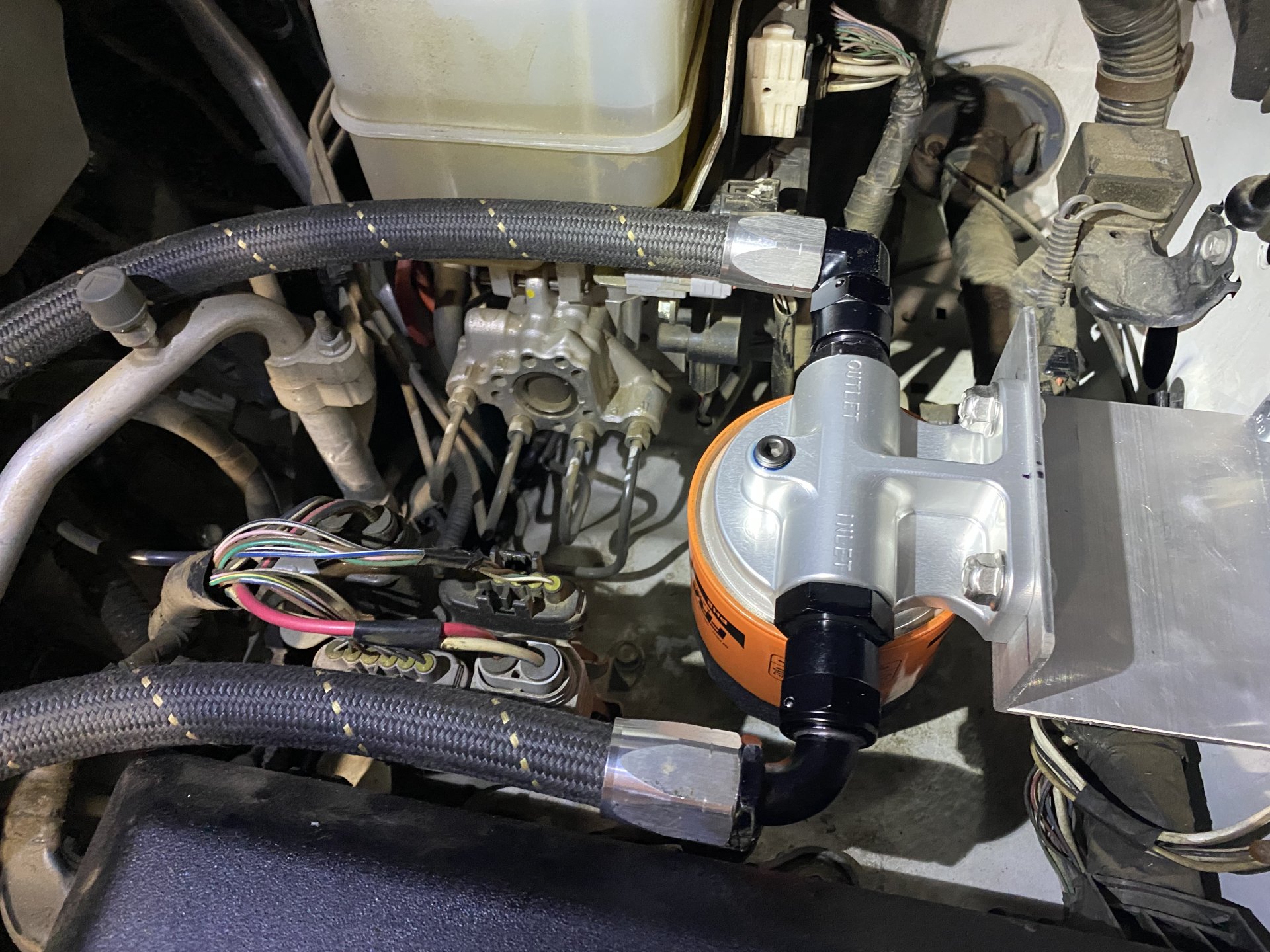

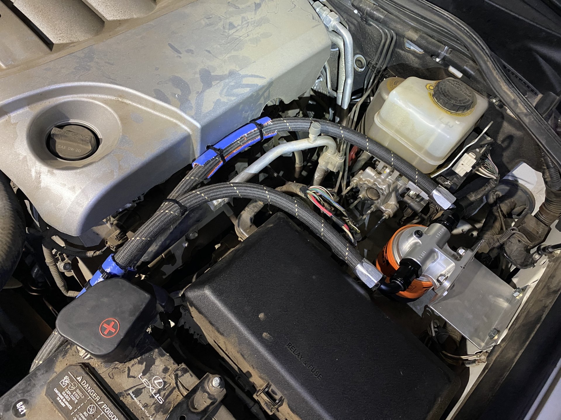

I’ve had this 2015 Land Cruiser for about six months. When I first purchased it from my wife I went to change the oil and was rather discouraged at how difficult it was to change the oil with all of those skid plates and that cumbersome filter insert. This was in contrast to how nice it is to change the oil on my FJ cruiser where the oil filter is in the engine bay.

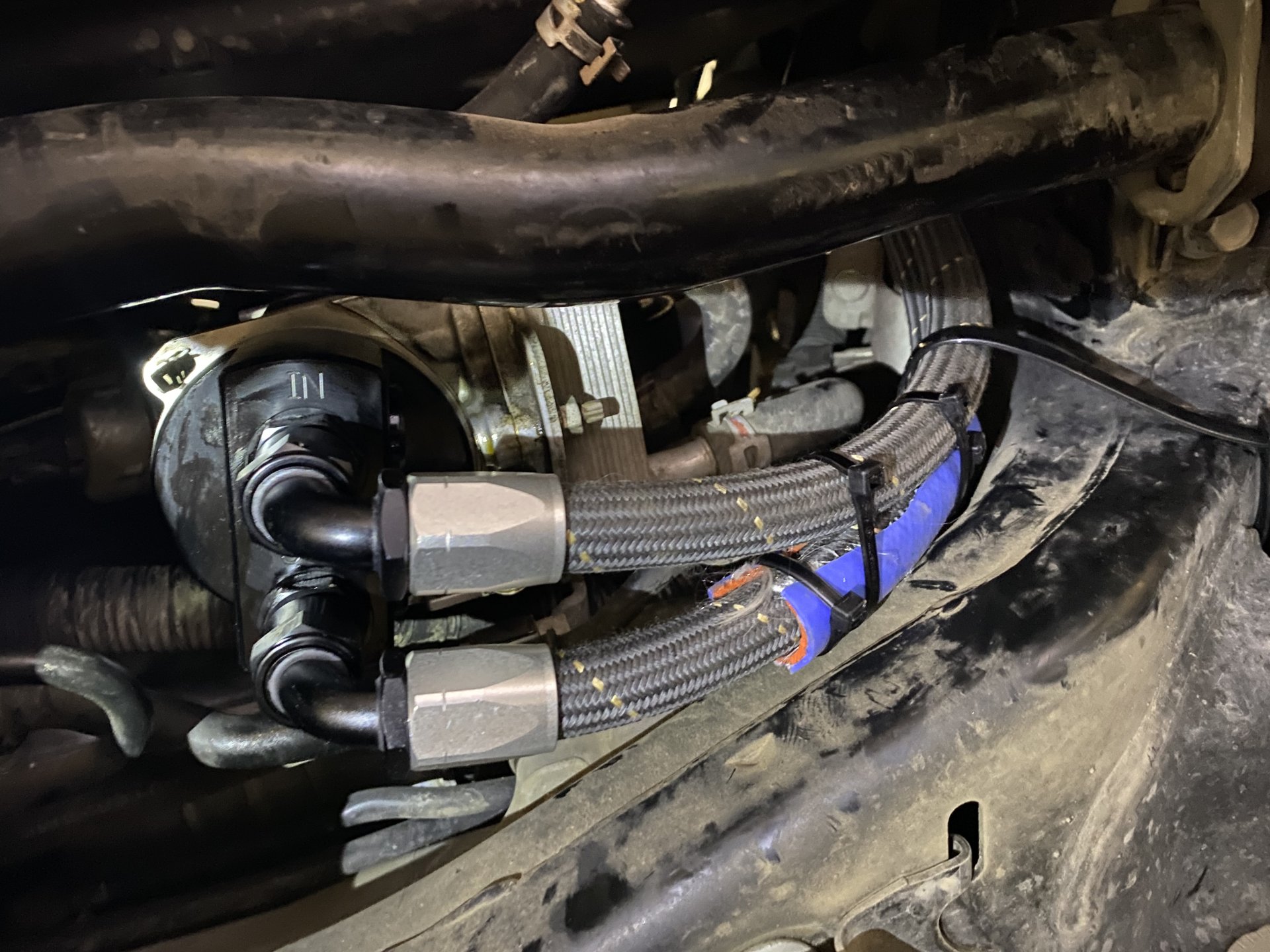

So I got this part from Baxter and it screws right into the oil filter cartridge housing. Rather simple install. It increased oil capacity by almost 2 quarts. Simple
That’s really cool. Are there any other locations under hood it might be mounted? I’ve got my air compressor mounted in the spot you chose.
ya It would have fit easily behind the passenger side headlight. lots of room there.
And the skid plate fits with this thing installed. the adapter does not hang below the crossmember.
To change the filter I will need to place an aluminum pie pan or a paper plate under the filer before i unscrew it to catch the little oil that may leak.
this is the hose and ends i use
this is the filter adapter
And i used the oil filter relocation mount from daily

i installed a fumoto valve and removed the small skid cover that was over the drain hole when i originally installed the remote filter. no skid plate to fight with. So All that i had to do to change the oil was flip open the valve and wait 10 min and close the valve when done draining.. Then It took all of 1 min to unscrew the oil filter and screw on a new one.
The remote parts add a little the oil capacity. It took exactly 9 quarts to refill.
