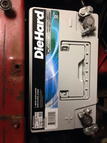

I went with peace of mind since this is mostly my DD now. Fired right up. Steep price tag though. 220$ with tax after a 10% discount. It's got the side post option.
