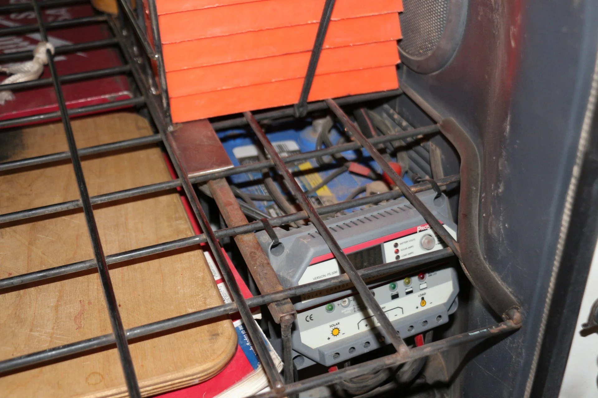

RFB you must be looking for a set up something like the picture, my choice Optima again. Hopefully they will last longer than 6 years.
