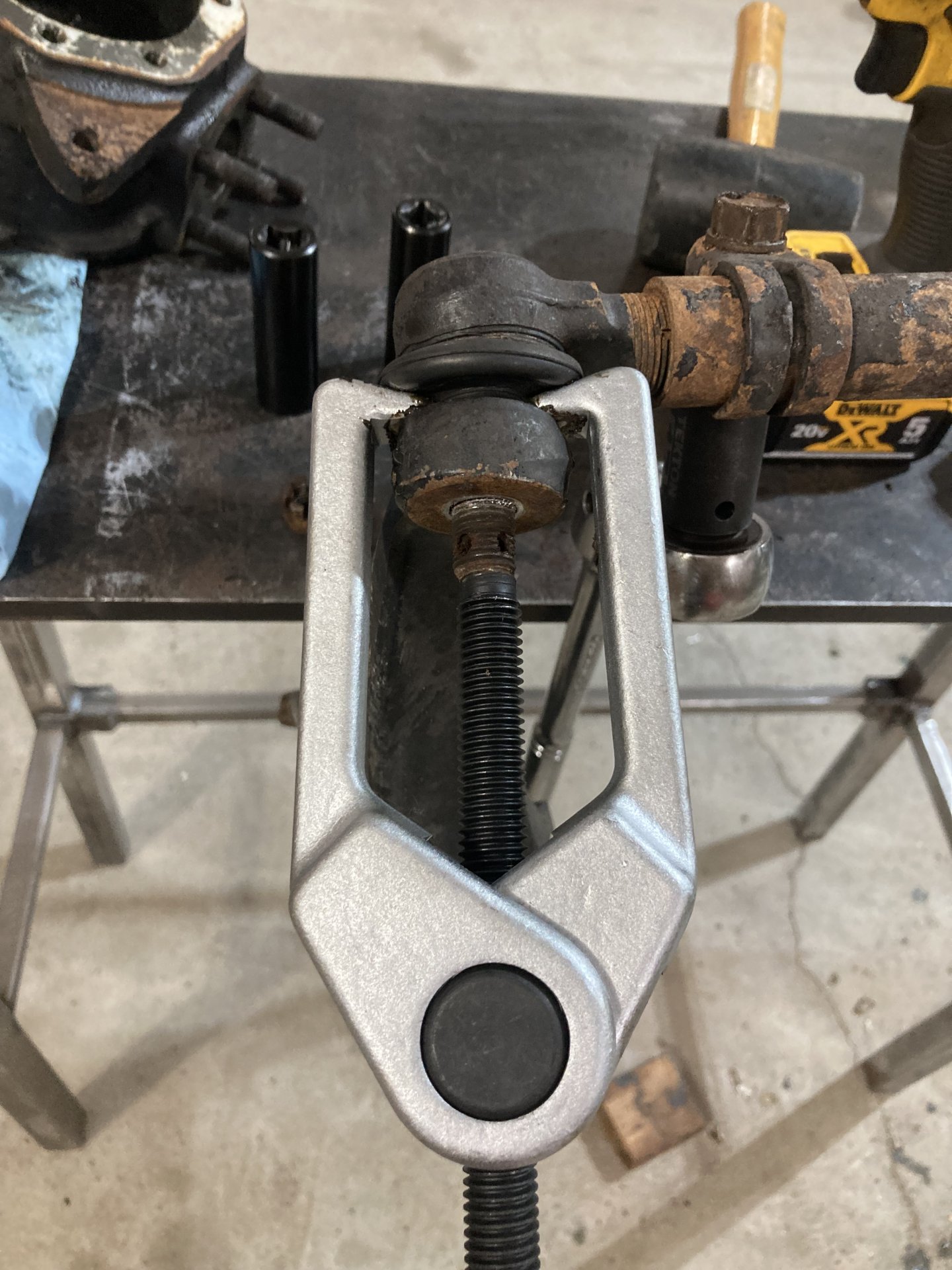

I like this style. I’m cheap wherever possible and so rarely touch TREs, I just rent it from O’Reillys for free under the evertough name. Has a nice little “cup” to hold the end in place. “Tie rod remover” gives good results for buying, and maybe try adding “non damaging” or “damage free.” This style commonly comes up as OTC brand. There are similar options where the opening for the TRE is not round, but I like the round fitment.
I think the birf comment assumed if you’re removing the TREs, you’re servicing the birfs/axle rebuild stuff.
