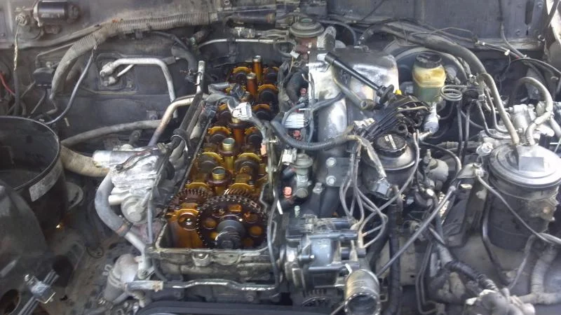

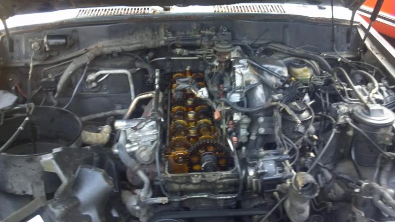

The problem was difficult to diagnose as the knock and "slap" were hard to pinpoint. At first we thought it was piston and maybe timing chain. Took valve cover off and checked timing chain but, looked fine. It was hard to see pistons. #3 looked different than the rest but, still fine. Drain oil but, no shavings.

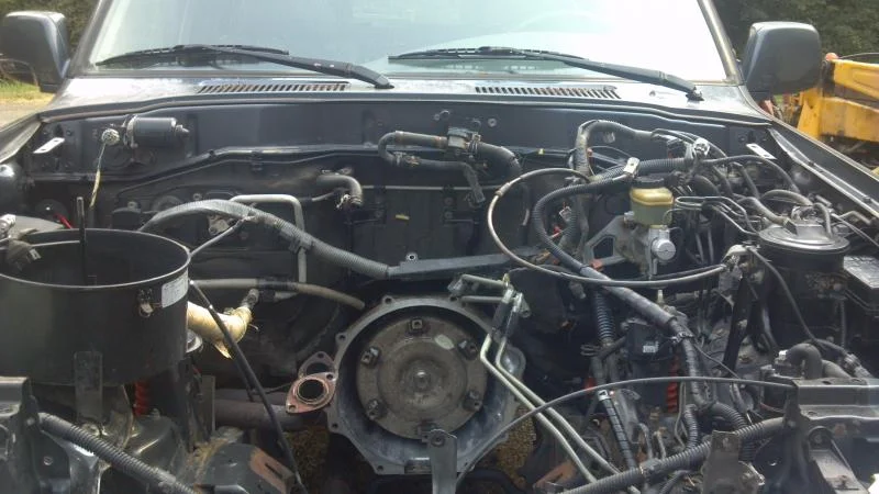

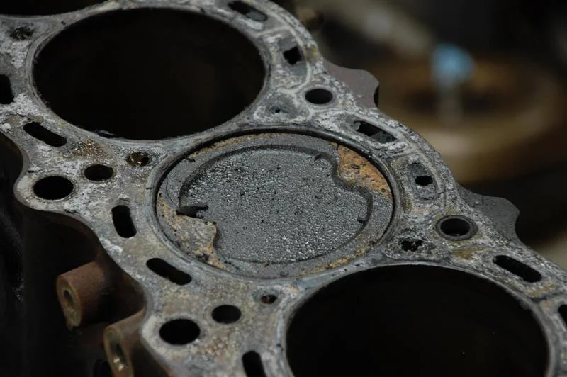

Removed engine to find pistons we fine. But, #3 was VERY clean.

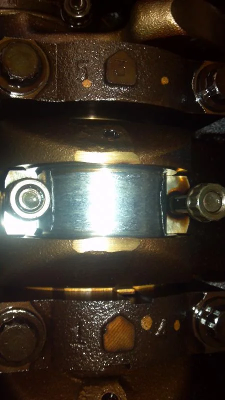

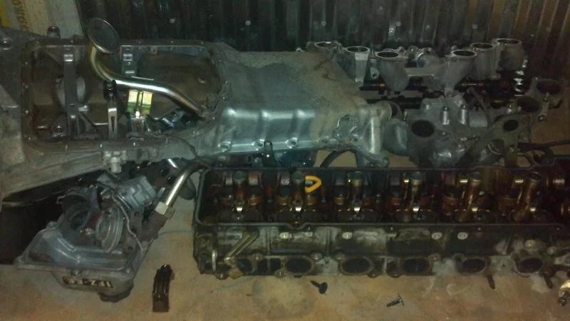

Removed upper oil pan and saw #3 bearing was super loose, then discovered it was gone.
Next steps, new crankshaft and bearing. I need to look at #3 piston as well for wear. Probably going to do other PM while in there. Of course new HG, new timing chain and tensioner too. need to look at water pump.

No sound clip. Although there have seen other rod bearing posts with similar noises (sound clips) which lead me to lean in that direction before tear down. The "slap" appears to have been the piston hitting the head. Which is why the #3 piston was so clean.

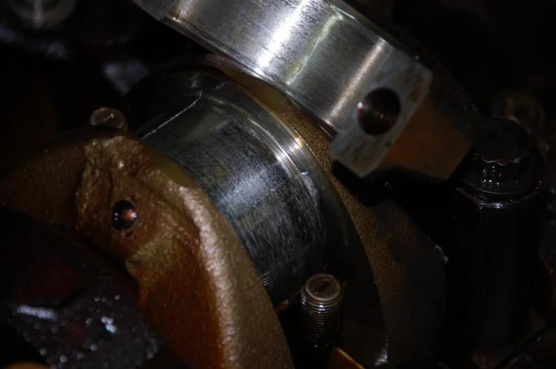

This looks so much like mine it's not even funny. On mine, I've determined (with help) that the most likely culprit was the front crank bolt. I noticed when I was turning the crank with the front bolt that it "moved" a bit. I knew that wasn't right. Turns out, that bolt clamps the drive gear for the oil pump and power steering. I later learned that that particular bolt should be torqued to 200 something ft-lbs. That's a LOT, and mine was a hair past finger tight.

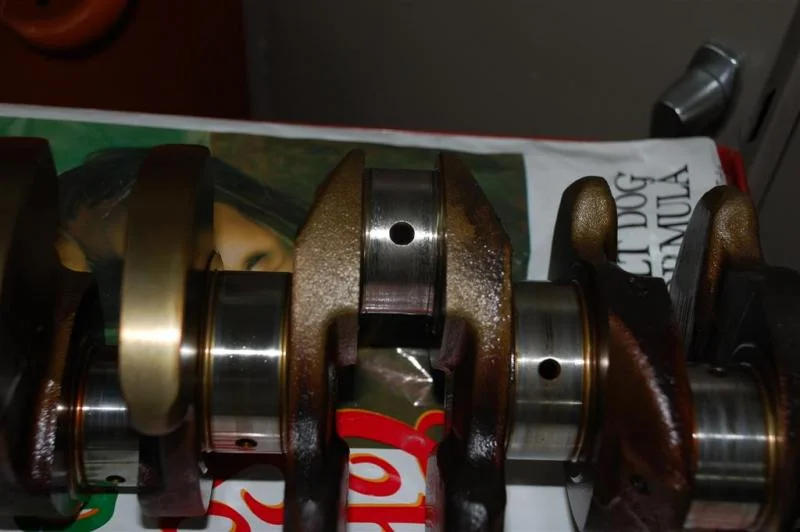

My engine did the same thing to the #5 rod bearing. It ate the journal as well, so it scrapped the crank. The rod was beyond resizing as well. Luckily, I found both items from a friend for a reasonable price, very reasonable.
My piston was slapping the head, ever so slightly. I could hear the piston tap and then go away for a couple of revs. That was probably the bearing parts moving around the journals. Mine were tin foil when I got to them.

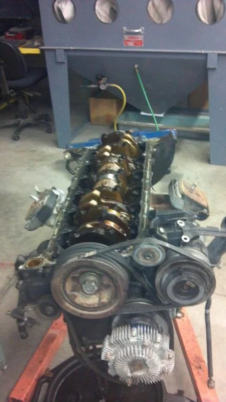

Machine shop got back to me. Block, head, pistons are all fine. #3 rod needs to be replaced and crankshaft is salvageable.
That said, when I look at rebuilding the motor and putting it back into the truck, I'd much rather put a 6bt in.
So I'm selling the complete motor. 174,xxx miles. New owner would have to buy new gaskets, and piston rings, #3 rod, bearings and re-manufacture or buy new crankshaft.
