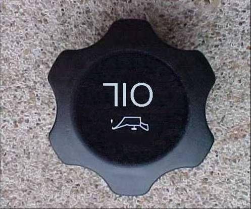

Another thing that will help is to turn the cap under the bonnet called 710 half a turn clock wise.
You will gain some.
Explain??
The 710 Cap.
It's there, I promise... Why they put the oil can symbol on upside down is strange, but it's there!
